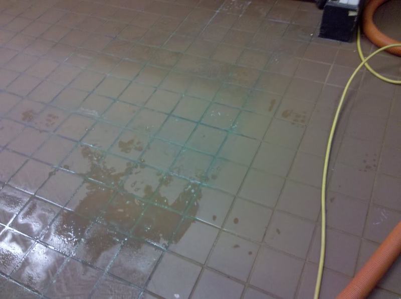

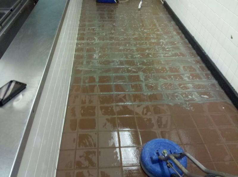

Be prepared to scrub grease.
That's one we did, there was an 1/8" of grease on all the lines. Add more cost to spend time scrubbing. And possibly having to go over it twice......

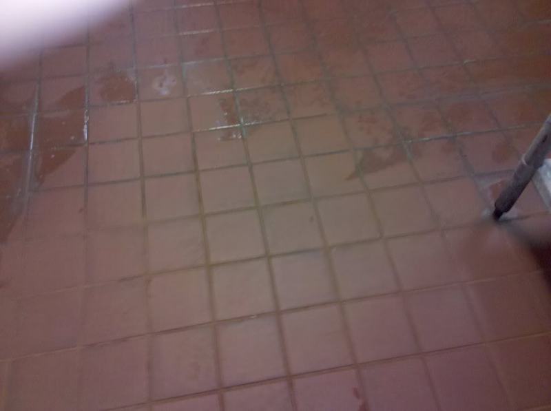

Have done quarry-tile kitchens. Used stripper, grout brush on Brute, and pole grout brushes. Rinsed with TH and Gecko. Color-sealed with Grout Perfect.
Quarry tile is semi-porus, so you need to keep the color seal off the tile as best you can and wipe any off asap.
