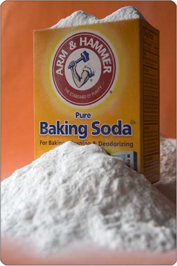

ever tried this on heavey hair/body oils on upholstery?
Arm & Hammer baking soda.... like magic, n no stank!
