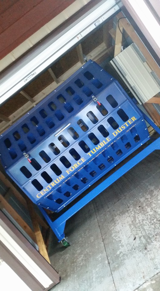

We're building a closet for our tumbler. It's the 8' tumbler.
Would any of you who have built a closet done something different if you were to build another?
Currently our plan is to make the roof strong enough for storage as well as mount the vacuum on it. We are thinking of
using a roll up for the door.
I've also requested Tom put wheels on the tumbler for portability so we can clean the closet interior.

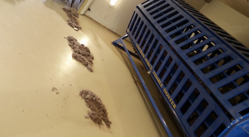

Not quite like you expect Gene.
Yet most of the facilities make an enclosure. Almost all put in an exhaust fan or what you describe as a woodworking vacuum system. 12144936_1196778597002882_3027826229285188525_n.jpg 12072732_1196778620336213_2094625342414549793_n.jpg
Heavy stuff accumulates on the floor and is swept up periodically. 3 piles shown here from ARCS day, just before Rug Summit 9, was what came out of the rugs shown without the aid of a human. Except of course, the initial loading them in the tumbler.

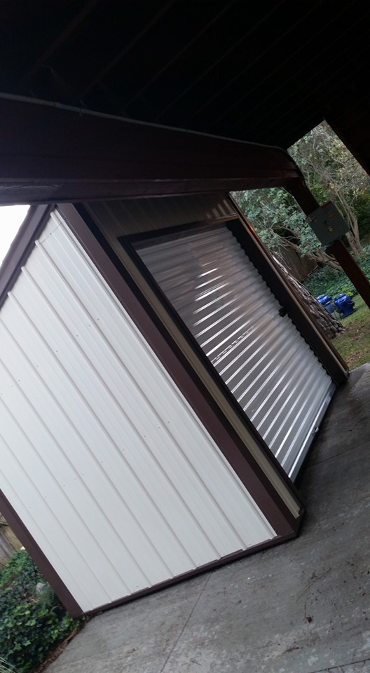

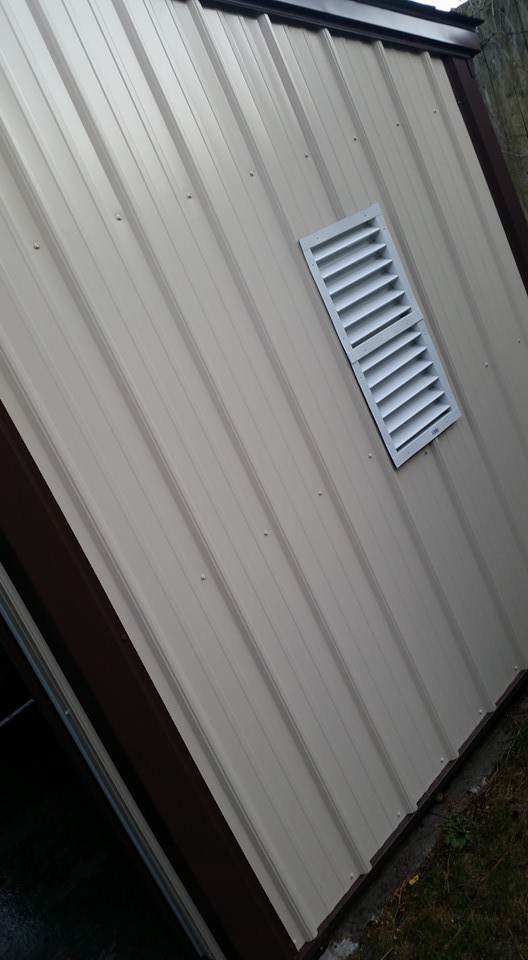

This is my personal Tumble Duster at Area Rug Cleaning Company. I have it outside. There is an exhaust fan located in the back of the shed not discernible in these pictures.
