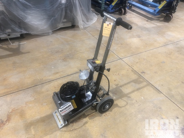

we rented a floor scrapper too.
it was still a b1tch

Taking up sheet floor sucks bananas. It might been easier with a floor scraper, not a scrapper.
Years ago while prepping a floor for vinyl we had to bust out some tile. We stopped for a break and the cat came in. He came over and was sniffing around the machine. Steve hit the switch. I had no idea cats could fly but that one cleared the room in one leap and instant air time.
