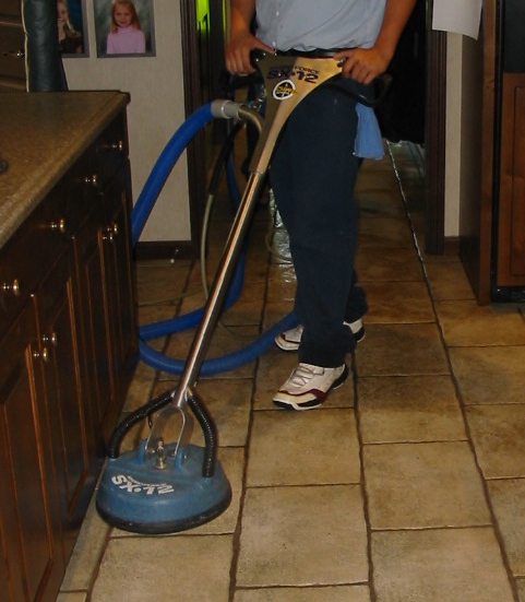

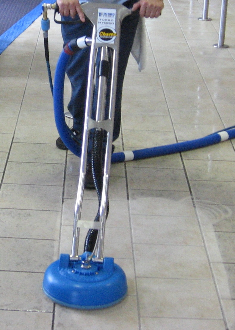

The perfect two shots between the tools by the bafoon above, you see how the turbo will get under the toe kick as to where the sx suction hoses won't allow for it.
I have not used the newer one yet but a few that have, have commented they still like the turbo better.

Listen, I understand you come from the age before time and you have seen dinosaurs but no one cares, AND I MEAN NO ONE!!!!!
Look at your pics and you can see.
Even Mikey has stated before that he like the turbo much better in many ways.
If he has forgotten I can use the search button just like you can, dang what's with the all the baboons these days!

Turbo hybrid is better than Sx. IMO The tool is just built better. Performance might be close to the same. But the sx12 just feels like 2 pressure washing guns screwed on to a 1.5 wand. The SX12 will dry a bit better. But it is barely noticeable. The 15 inch version of both aren't that great. They are just not very maneuverable.
The turbo hybrids are "throw in back of the truck" tough.

I have both and prefer the sx-12. It's still all original parts and I've had it since they first came out. The hybrids ring is already coming apart and the valve leaks. I hate the location of solution line, could catch a wall and my hand gets burned once in a while. I see on Chavez turbo it's missing the rings that hold the pins, which get in the way when going under cabinets. Bad design, they have to be cut off. Didn't notice any difference in the dryness of the tile.
