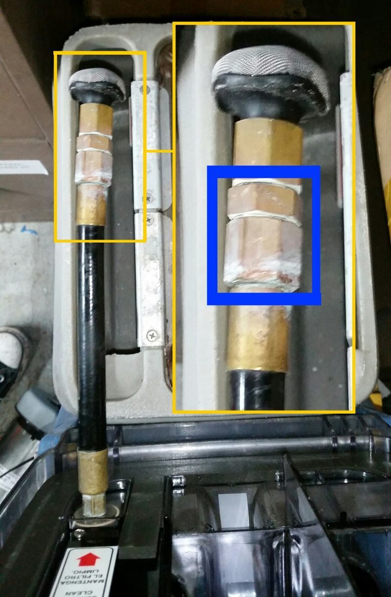

ok I have been out here for months getting involved and picking people's brains, I rebuilt an EDIC fivestar, new vacuum, new base, new brush, new pump, still has some older parts and I have checked best I can the nozzle seems clear, the pressure lines are not great but for some reason I'm not getting the flo I get in my other EDIC units, the clear top shows the soapy water, but not a lot, how can I test the volume. How can I check the volume. Only used it on an area rug and it works nice vacuume wise, but not much solution. Don't see any kinks. I'm going to check the pickup screen on the feed line, I did add the stop valve on the attachment line

I always rule out all the filters being obstructed first when dealing with low or dropping pressure.
Start with the filter at the bottom of the fresh tank and work towards your wand.
There is often a second finer filter on many machines located between the primary fresh tank filter and the pump, usually inline on the sol line feeding the pump.

The check valve is new

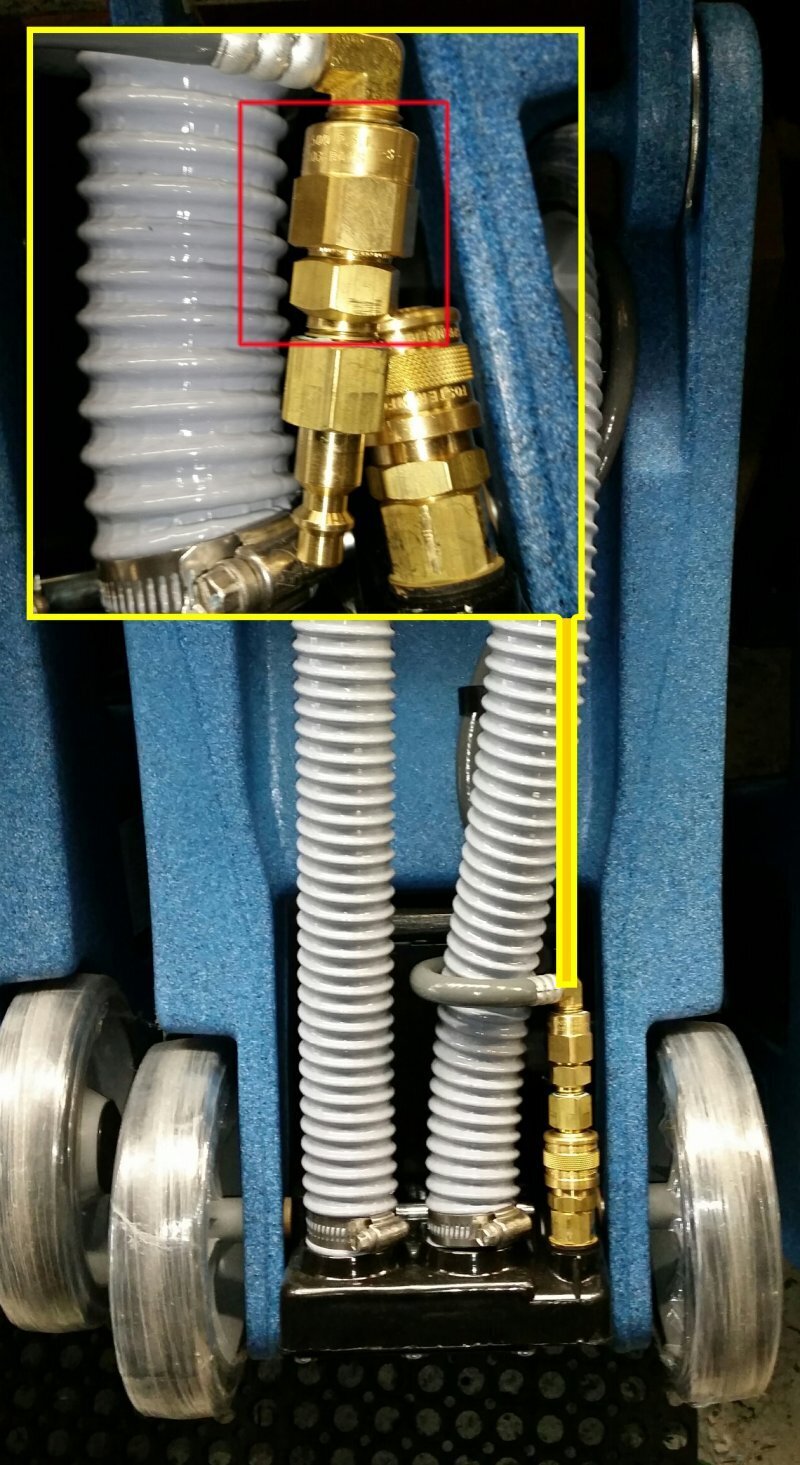

K
Ken692
This is not new on mine
I don't have the valve in the blue box, has to be here, everything else seems fine

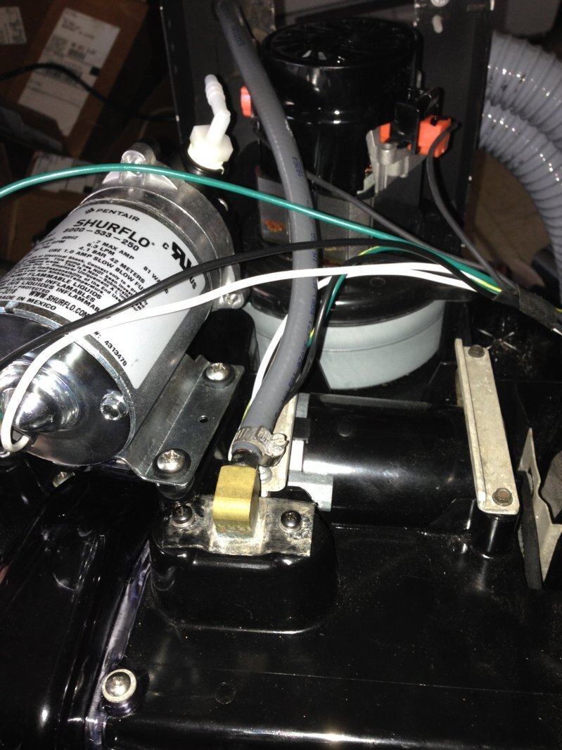

K
Ken692
It's great suction, it lifted the carpet off the floor, the dome is not showing the waste water at much volume to another unit I have it's a new pump, I'm sure it's the feed hoses, there crap 1997.

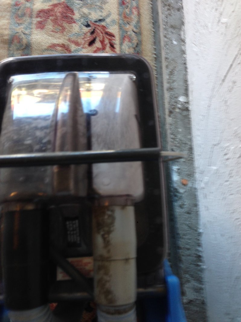

K
Ken692
Seems to be working better without doing anything ?
Maby the filter loosened it self up
