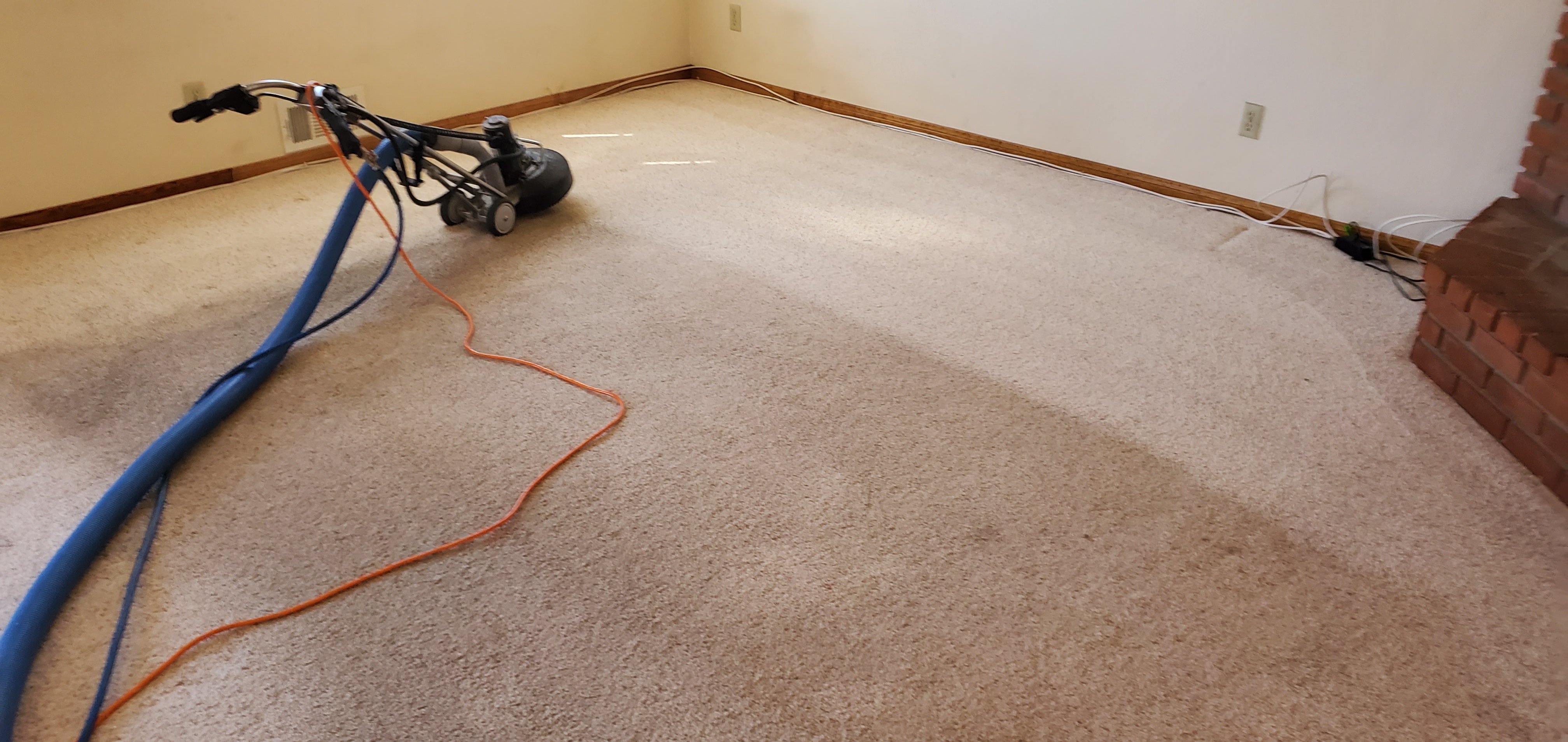

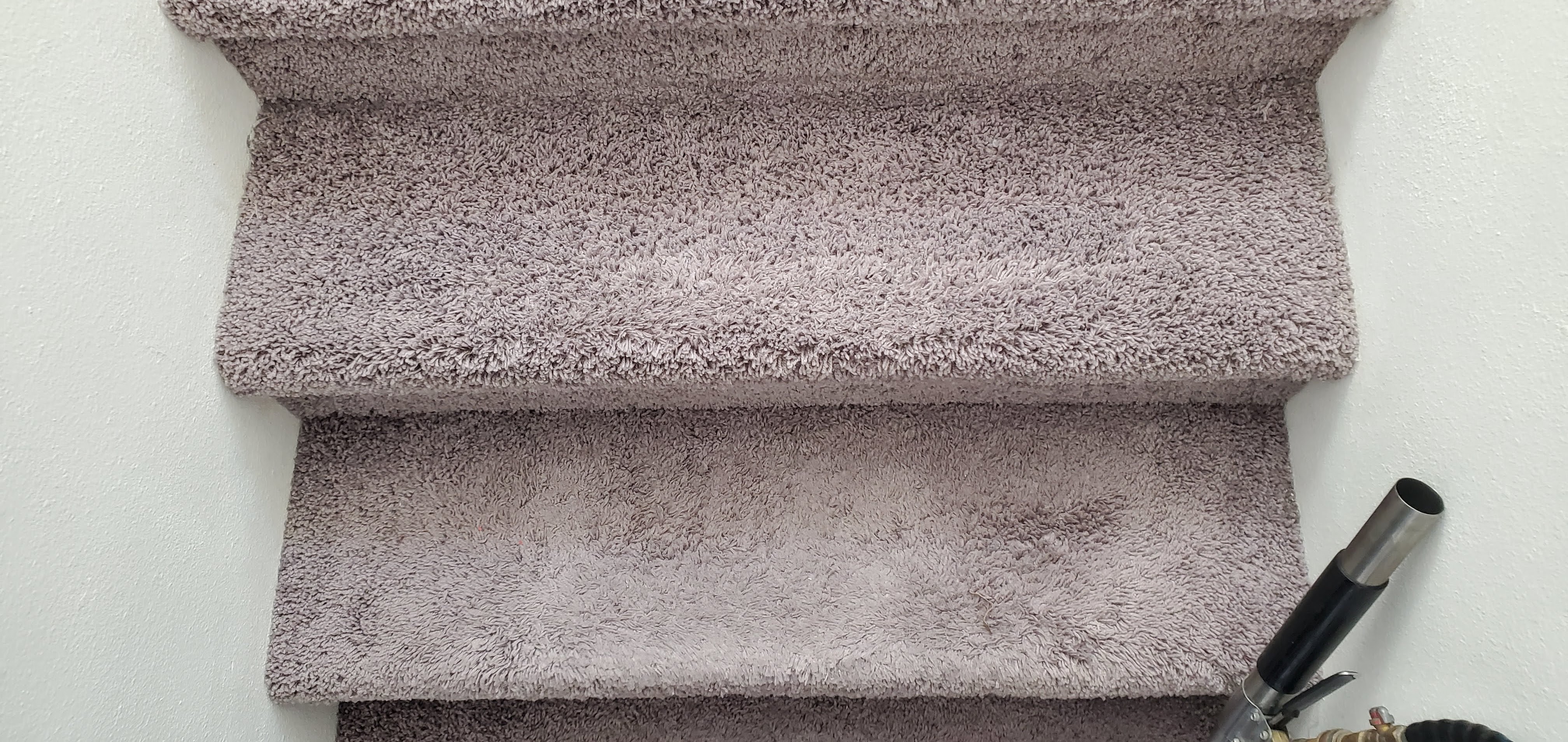

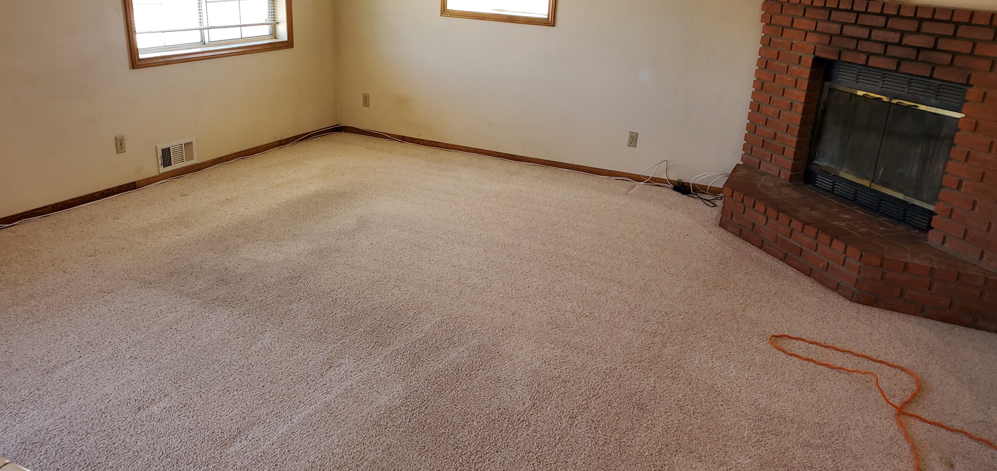

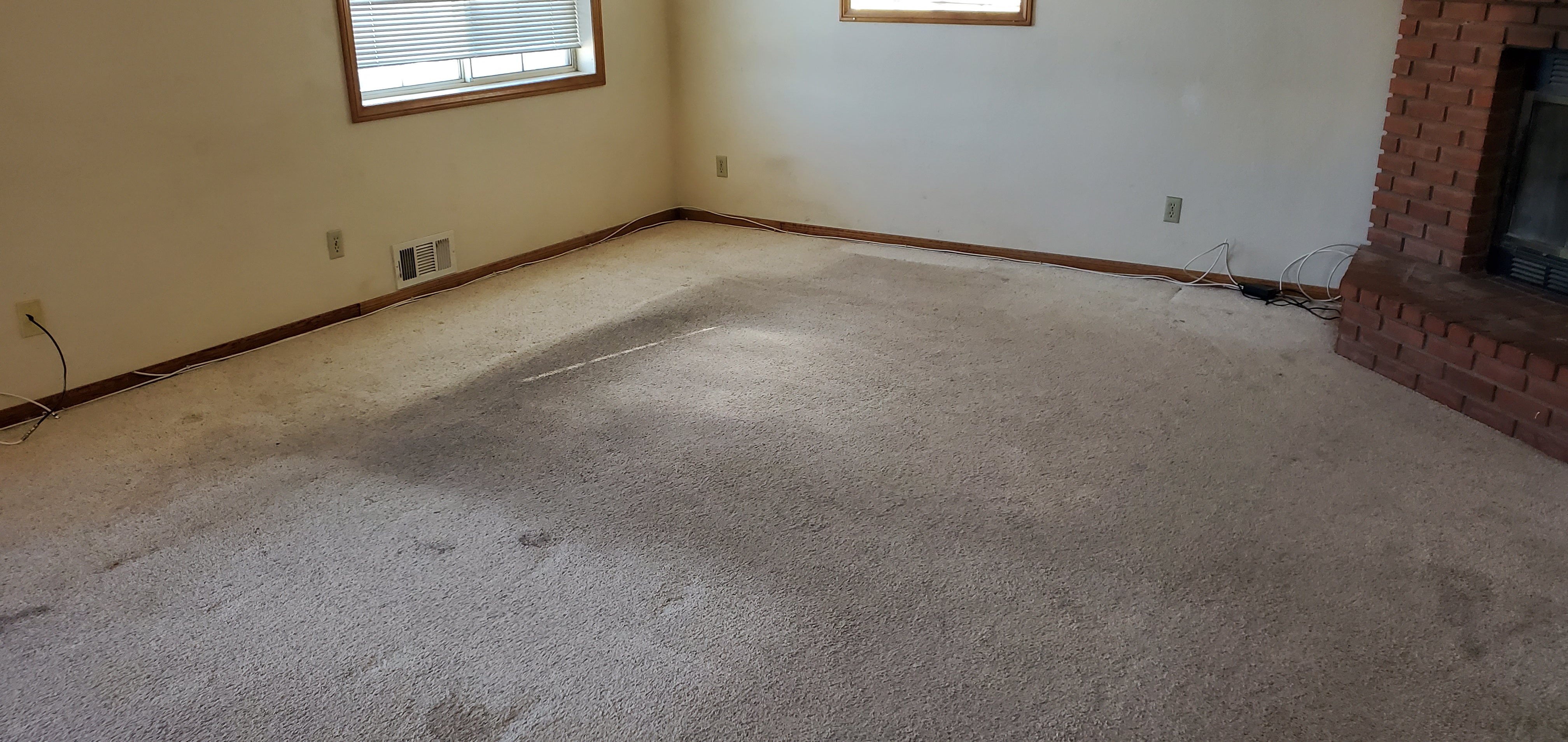

I didn’t take any, it’s not that bad, I’m just wanting a fix more for the next time....

20220311_104404.jpg 20220311_091522.jpg 20220311_110845.jpg 20220311_105740.jpg
