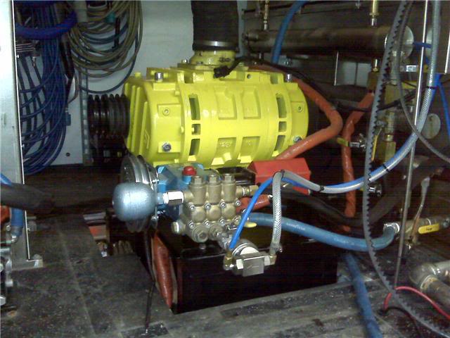

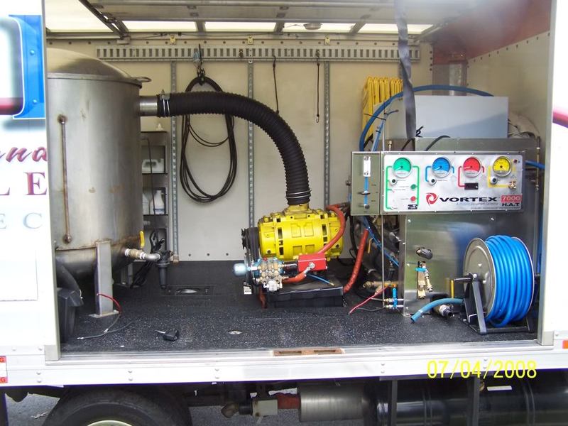

Mike, I have not had any problems with this system on my trucks. It heats up fast and the heat stays consistent. On my 7000's the lines were run kind of weird, I will be redesigning this winter. Here are some shots of last winter.

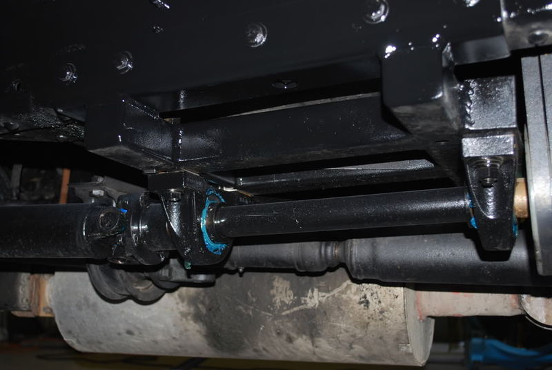

Doug, I should have put the middle picture up top. When I purchased this Vortex the blower was sitting on an angle. The top picture is after we replaced the cradle that the blower and the pump sit on. The bottom picture is after we replaced the drive shaft cradle and completed the leveling of all components. The belts are lined up so that the tension is the same on all three belts, no slip when wet. 8)

When I took delivery of the first Vortex I had trouble with the belt tension. The three belts all had different tension meaning that the drive pulleys were not lined up. When the belts got wet they would slip when you tried to engage the PTO. The other problem that we found was that the seals in the blower had been eroded by fine dirt that had gone past the filters. The seals were letting the synthetic blower oil pass to the impellers which would cause dirt to stick to the lobes. The lobes would then begin to knock against each other causing the blower to fail.
When we installed the new cradles, rebuilt and leveled the blower it solved the belt tension and slippage issues.
As far as the heat, the 7000 Series has a addition heat exchange on the blower. Between the 240 Gallon of preheated water the heat exchange on the blower, and the Zentherm we can usually have 240 Degree water in 5 Minutes.

Was your blower failure due to over-heating? Did you drop a bearing? I'm on my third re-build. The race had slipped, due to over-heating. I don't know if it is caused by the angle or the small particles getting into the blower. Make sure your flex inlet from your tank to your blower doesn't have a clear smooth insert. Once that lets loose, your blower is done for sure. That was the problem with my second blower re-build. Do you think it was more of the angle of the blower or just your belts not aligning right? If your belts just didn't align, why didn't you change the angle of the drive shaft with the spacers in the pillow block bearing?
