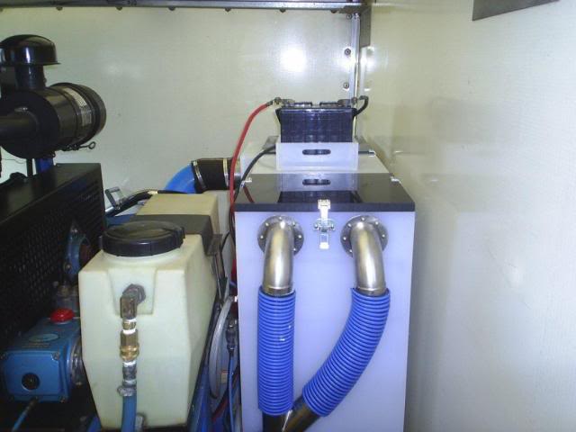

I am considering buying a Poly waste tanks from johnshotheatexchangers and I am wondering if anyone here has has any thoughts on the concept. Or knows anyone who has bought one?
http://www.hotheatexchangers.com/New.html
We have been using one for about 8 months...
ABSOLUTELY....the best tank in the INDUSTRY.... :!: :!: :!: :!:
Our's is hooked to a 59 blower :shock:
It has been perfect....easy to clean...holds NO odors...very easy to see waste water level..
We had John build it with 2.5 ports...The lid design is great..No air leaks... 8)
This tank was tested @ 24HG..... :shock:
BUY IT..."I will NEVER own another SS or aluminum tank AGAIN..... :!:

You will never look back...You really do NOT need an APO...because you can SEE
the water level @ all times..!!! The custy can also see the DIRTY water being removed.!
You can ALSO have any accessory mounted on the tank..Uph. tool holders , battery box ,
chemical shelves...ect...ect..! The lid's have a replaceable o-ring designed into a recessed
grove in the lid.."NEVER LEAK"
They are BAFFELED very well & easy to clean...NO hair or lint will stick to the tank...Simply
rinse with a hose..!! "If you will notice...my tank is NOT even bolted down... :shock: They
are so light-weight..that there is NO stress on any of the connecting accessories....
ps John will install any size Vac. port's you desire... !gotcha!

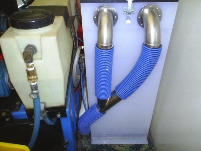

oBvIoUsLy... :roll: :mrgreen:
John "absolutely"..demands proper installation .."If he is Installing"..!!!
John supplied me with 12in.x 1in. SS bars "pre-drilled" to attach to the bottom lips
of the tank...as per this photo...........
If you HAVE to transport...I would suggest a CENTER tie-down strap...overlapping the middle
of the tank..ANCHORED to the truck floor... :idea: ...similar to a boat tie-down strap... :!:

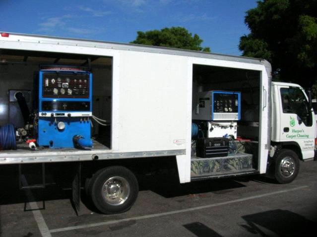

Shawn, you are AWARE of the HUGE waste tank for the Prochem 805...seen below.. :arrow:
Because we have minimal dumping restriction in my county... 8)
I NEED the addition space in the Box truck to install my Prochem 405.... !gotcha!
The 405 has a footprint "smaller" than the original 805 TANK...!
The 405 is mounted in the front of the box truck...With its own waste tank... :idea:
This TWO unit truck has been very profitably in its DESIGN..We run 3 men on this unit..!!!
This is the WAY of the FUTURE...of TM waste tanks..."IMHO"
PS..I am unaware of ANY other company operating this type of DUAL unit.... :shock:
Your "back-up" unit is always with you ...if you have a mechanical problem... 8)

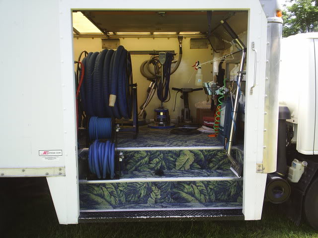

Harper I've always thought that set up was the sweetest I've ever seen. I just can't get over the flowery carpet lol! Was that already in there or did you put it in?
P.S. That trucks the one with the BL water pond in the back right?
joe harper
Oct 21, 2008
4,993
florida
joe harper
This carpet..... :oops: :lol: :lol:
Different truck....This one has the "Water-Pond"..........
