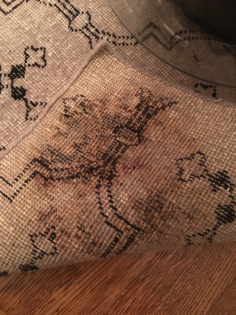

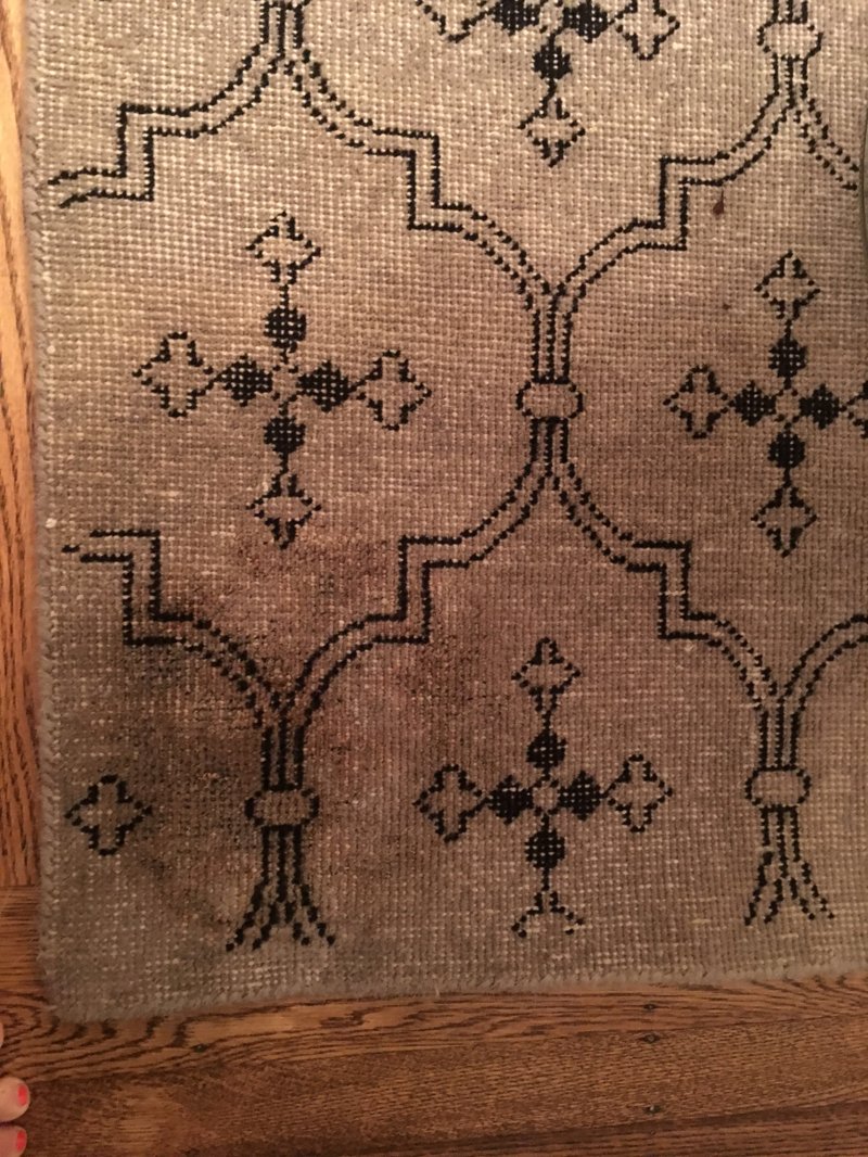

If a rug has planter caused mold/mildew on it. Not rotting but definitely some damage. Planter removed and will not be there again.
Is there an advantage in cleaning (as it may reveal more of the damage and fiber loss.) and also is it really necessary to remove it. Or is it better to spray with a products that stops the mold (which will it be in CA?) and just let it be?

I have it as pictures in the body of the email (not an attachment). How do I load it?
Phone or desktop?
Android phone put you finger on the image and hold it. Then save to gallery.
At the bottom of the MB message box it says "Upload Photo". Click it and look for it in your gallery. It will upload from there when you click on it.

How stable is it still? It looks pretty good from the picture.
If it would hold for a cleaning I'd clean both sides. You can always use the Sapphire tool and break the vacuum some. Spray with whatever disinfectants Cali allows.
If its not stable the you don't have much choice but to spray and run.
