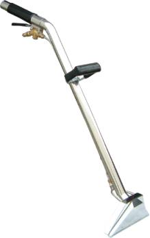

overall best stairtool?
Jerry
Nov 17, 2006
286
staight,swivel,handtool? I think I would like a longer straight, maybe with a enclosed head, I dunno. All I know is I need something different than what I got. Any suggestions?
Thanks!
Jerry

The stair tool I have now is a 30" 1 1/4 with a "open" head, PMF. I have had it for years. The biggest problem is it screams something fierce and I have to turn down the water flow to reduce overspray. PITA. What about the Prochem stairtool?

I know you've never heard this before, but what ever you use put a glide on it....simply changes the tool for the better. oh and upsize the jets while you are at it, flow cleans dirty treads.
The PMF tools totally dominate the market, not cause they are the best, but they are decent and affordable, the 30" and 40" tools will serve just fine for most and they are avail. everywhere. The Prochem tools need a serious jet upgrade, 06 flow please.

The best one is the one that works for you. Stair tools are probably the most user specific tool out there. Ask your local supplier to try a couple. If you want one that you will not be un-happy with the PMF tools is by far the least "hated" Some people really like the S bend tools and the 29" tools is the most popular and for guys like me and Mike the 40" works well but if you are under 6' you would hate it. I do not like the straight tools (Prochem,PMF etc) They suck for tall guys but short people seem to like them. So the short answer is it depends and thats the answer I give guys that come into the store. I f they don't know what they want i send them out with 3 or 4 to try when they have a stair job so they can find what fits them best.

btw my UT-40 rocked, but Mikey never could get comfortable with it, I'm 5'9 not 6'7 thou.

I like my hybrid glided swivel tool with 09 flow, it will go into some crazy tight spaces and gives you angles that no other tool can even dream of. For extremely soiled stairs, my RV swinger & swivel tool combo is the ultimate. Nothing else even competes..........................

Still waiting to see a vid of stairs gracefully being cleaned with a wand. I have tried the wand, and use it some, however almost always go back over and detail w/prochem upholstery tool, i.e., my standard stair tool of choice.
