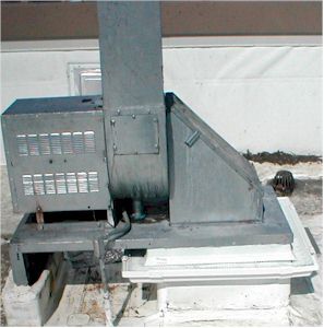

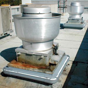

Dirty, Nasty, Smelly, Sticky, Foul, Putrid, Stinking, Cruddy work. If you have some time I will tell you how I really feel about grease vents. If you have minions at your command, you can make good money. Just need some rudimentray mechanical know how and a strong stomach. Overnight work when the restraunts are closed. Worse than a cleaning a pee saturated rug. The odor permeates your everything! I used to travel all over the US installing my bosses invention, the Grease Gutter. He came up with a concept, sold the first one to McDonalds, and assigned me to create and install them.
This is a prototype I made from Home Depot plastic gutters.
After we sold a bunch the extrusions came in, I did this install for Disney Land.
There is a video on this page. I am the guy installing.
http://www.greasegutter.com/downloads.htm
