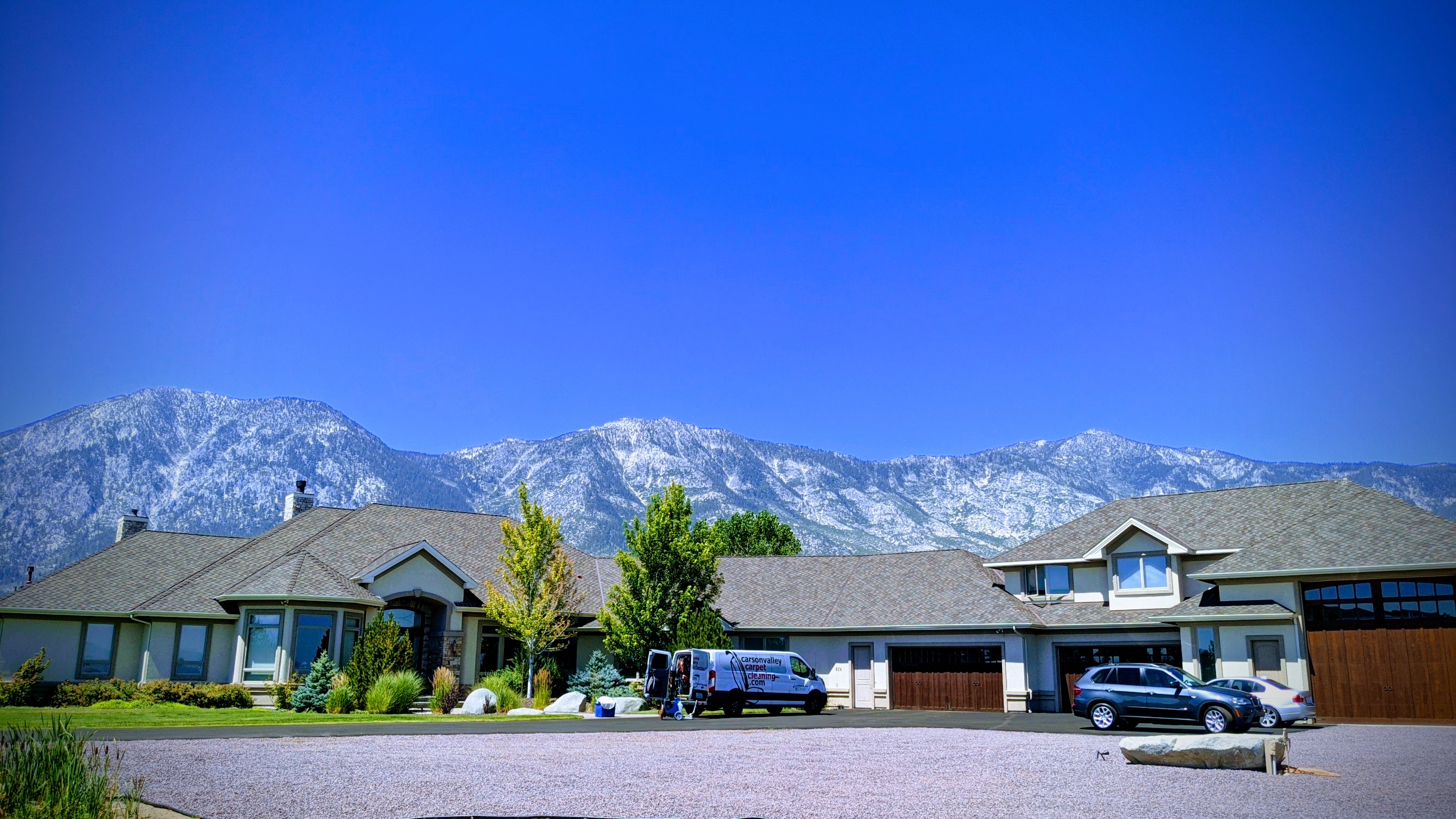

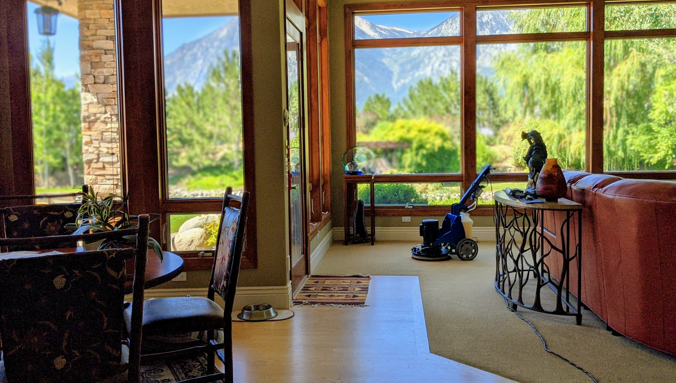

The richer and tidier the client, the more likely I'm going to use my TOPS Phoenix
5 rooms, 4 small spots..
Would have taken 200 ft of runners and 542 corner guards.
Doors stayed closed.
Carpet is fluffy, spotless and dry when I left...

I fully explain the process and she already knows I'm the only carpet cleaner they're not 100 mi of here that offers every method..
Ounce and a half a PCP maybe an ounce of peroxide maybe an ounce of top spotter and 6 pads.
