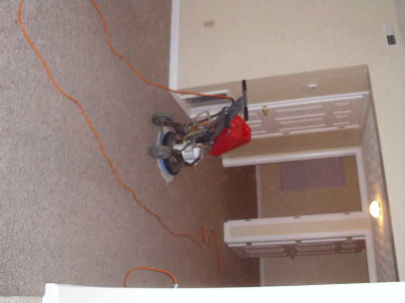

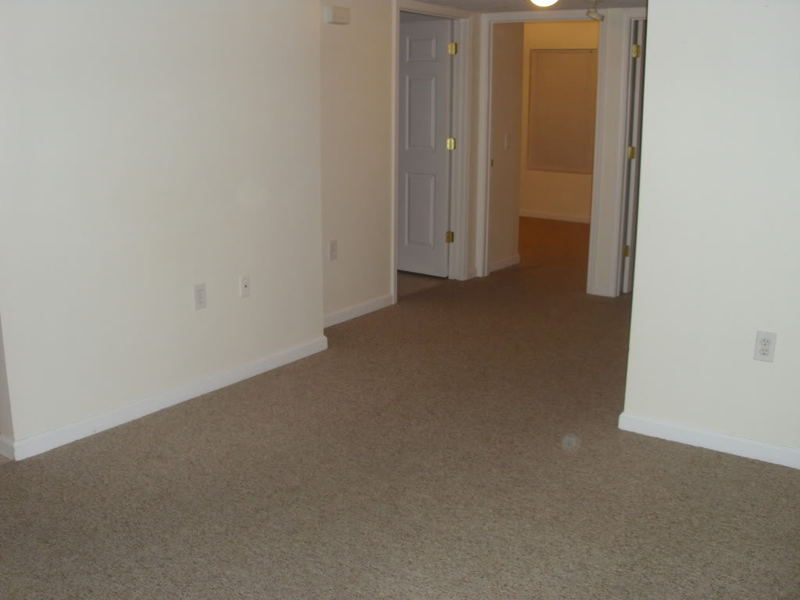

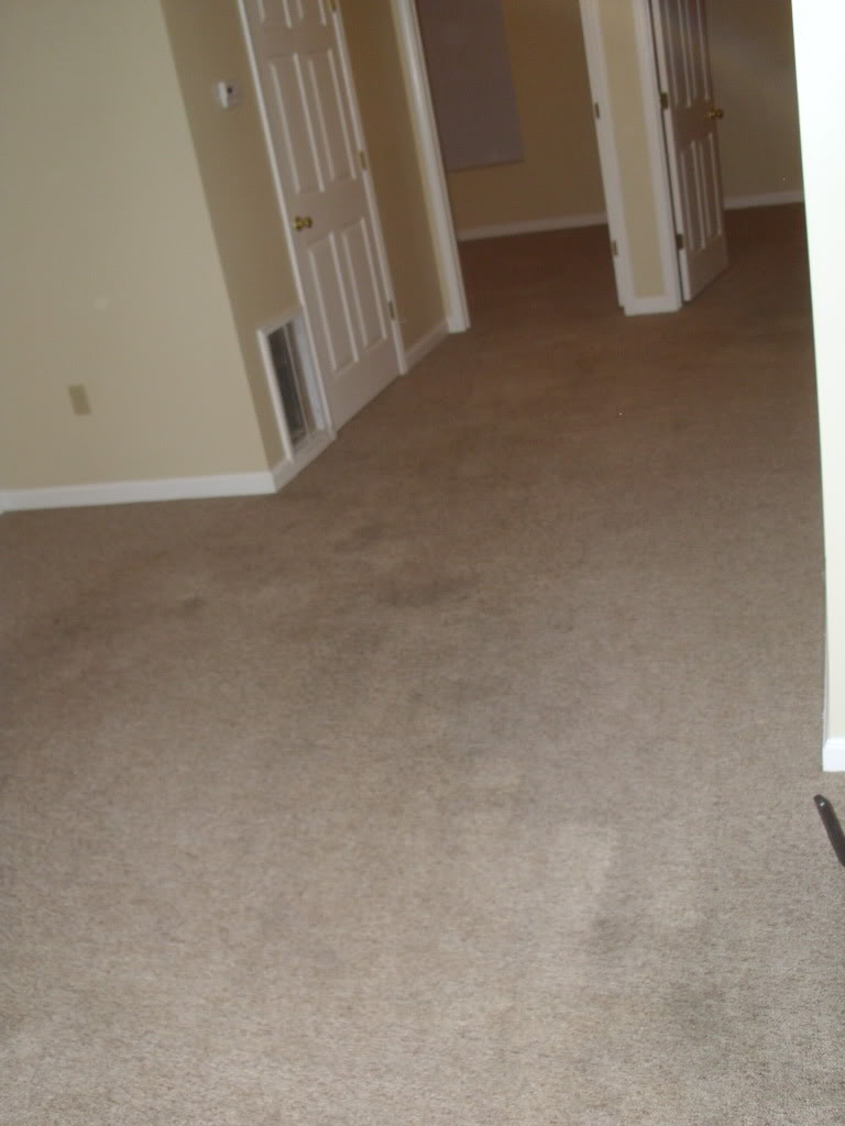

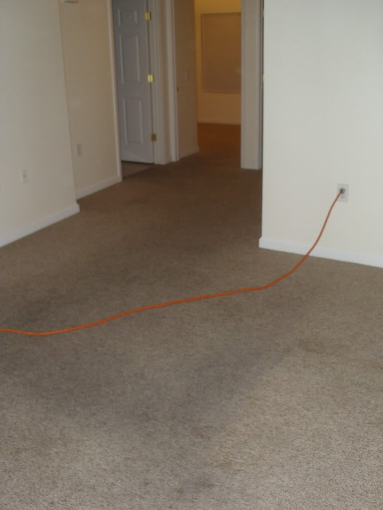

Both were sort of gross... Smelled like dogs in one and ant & roach spray in the other. Both seemed to clean up fine & the improvemant in the "bag of assholes" smell was exponetial... No smell but the Snake Oil which was mixed at 8 oz to 2.5 gallons.

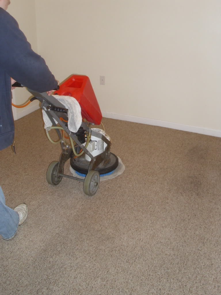

One of the "less gross" bedrooms in process:

Low paying? Depends... It was more laziness than ticket price to be honest. I didn't want to de-winterize my tm for 2.5 hours work and then re-winterize. Low moisture cleaning actually made me more $ per hour (as it usually does) but it was more about convenience for me and appearance/smell for the customer. All of those boxes were checked with Snake Oil... Judge me if you want but the check will clear.

About 6 pads front & back per unit. So 12 total. One load of pads, washed twice & 3-3.5 gallons of juice... Had some left over & did my living room... Still have over a gallon in the tank.
