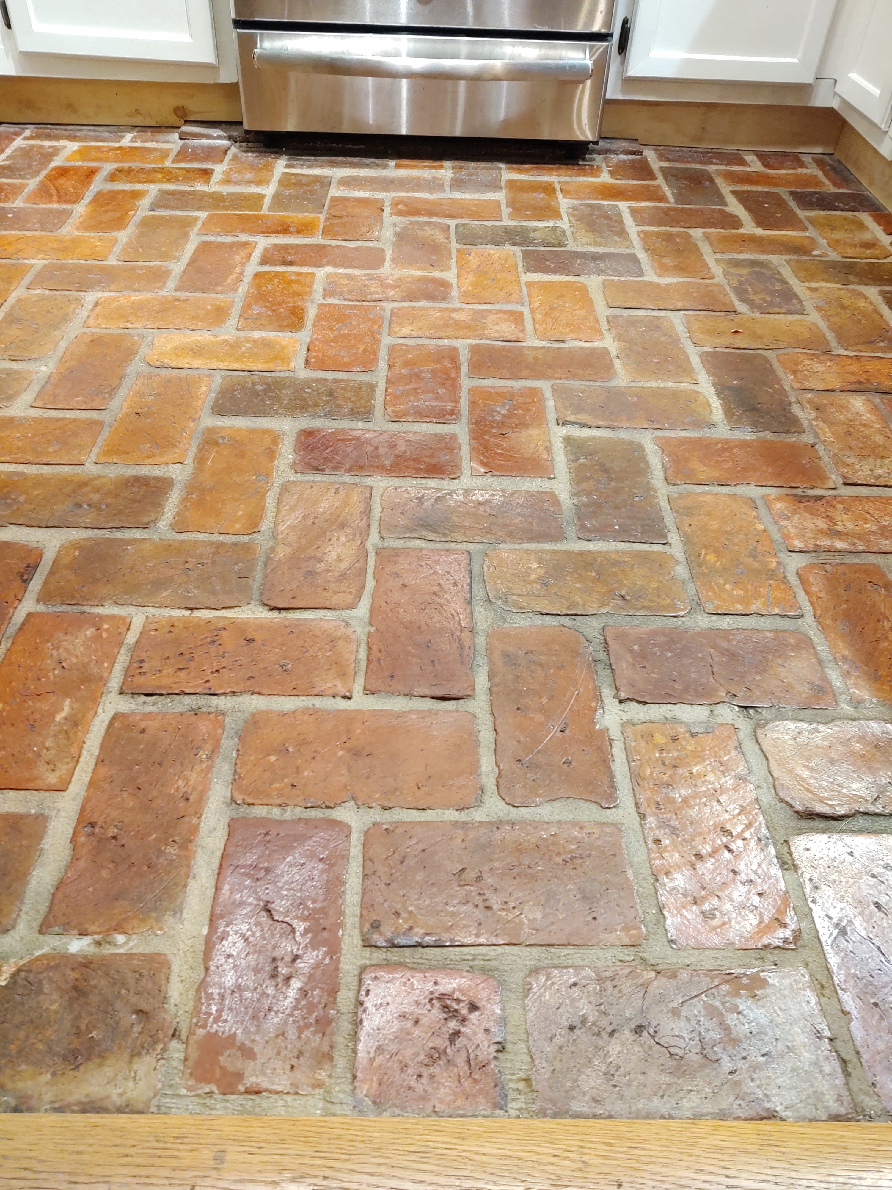

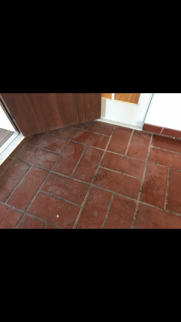

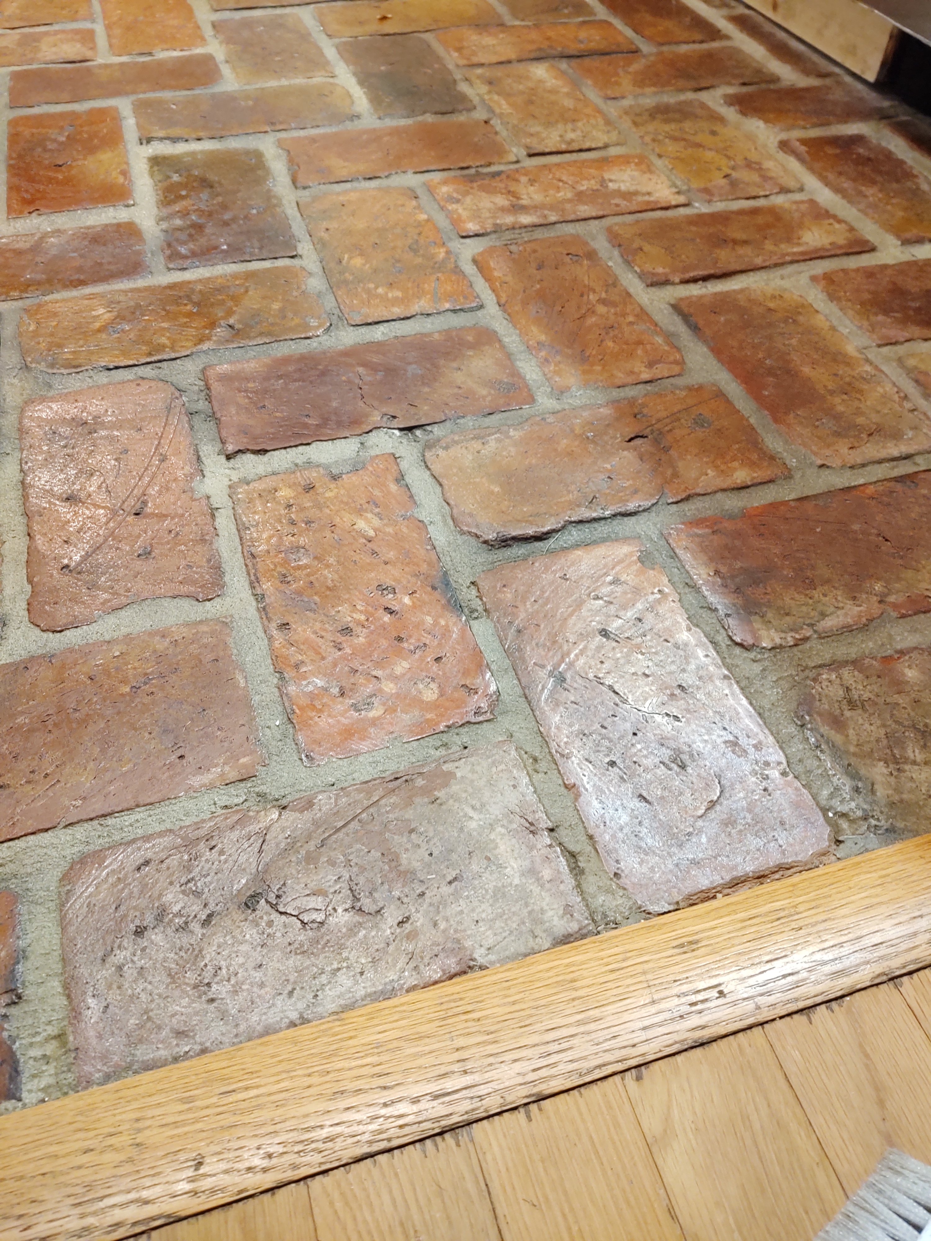

Any tips for tackling this project. Some kind of wax has been applied. They heard a polyurethane was put on.
Looks like a wax because it's flaking off in places.
Bricks are very uneven.
I plan to his it with a hot stripper then 175 black pad. Follow up with CRB for the grout.
Rinse with spinner and grout wand.

Many years ago Garth Brooks bought a house for his mom and dad that the floor looked like that. We got hired to redo it. I did it just like you said Brad, minus the spinner. We used hi-pro pads with hot stripper. Used baseboard stripper (foam) in joints and uneven spots. You can do that like spotting carpet. Take it as far as you can, then recoat. That’s what you do with vct. It was only new once Ma’am. Don’t run, unless your Damon of course.
10,256
Hi-pro will do a good job. They will tear from time to time, but will take a while. That’s why you bring a case or two. Plus, you put hi-pro over some sort of buffer pad. Under the buffer pad!
