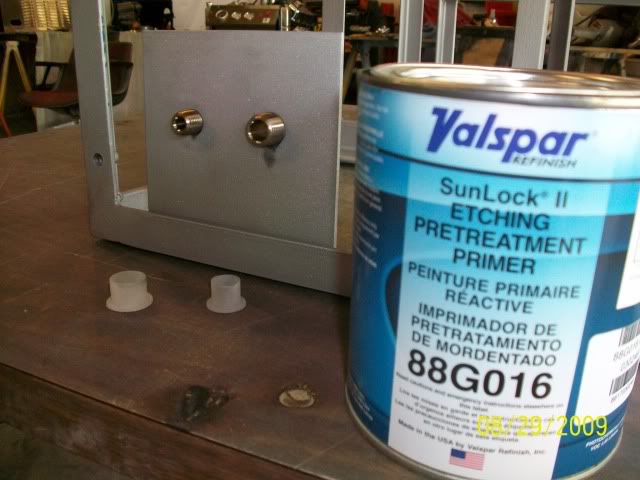

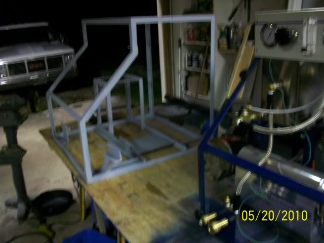

this is a picture of my next Genie....thats the etching primer...
and it will be Steam Genie Blue tomorrow!
