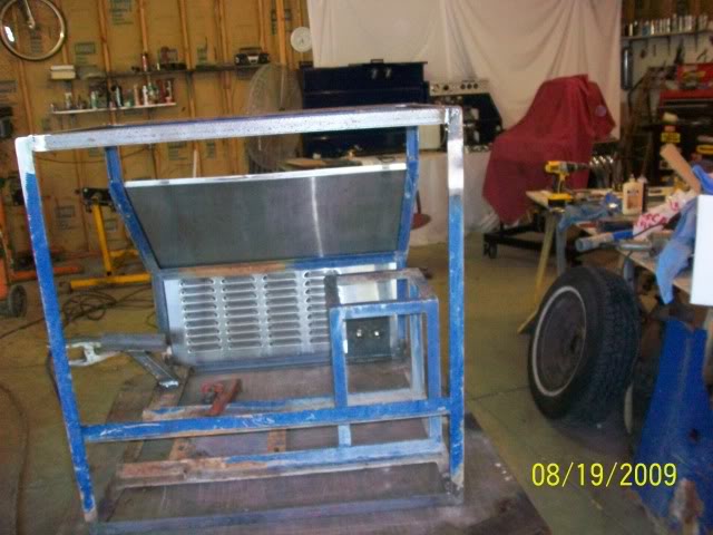

The Start:
very bent up!
much massaging later
finally straight see the new legs

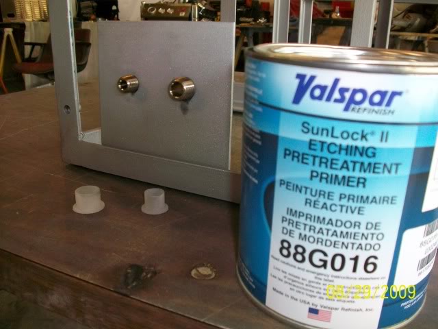

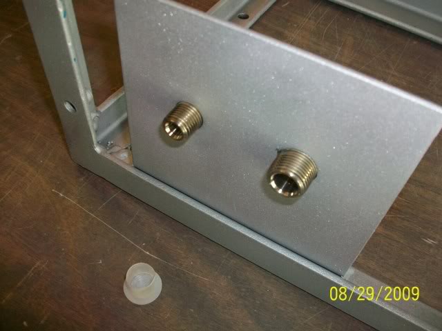

Stainless Steel Hex close nipple fitting welded on...
first it'll be primed wit the sef-etching primer..followed by the 2K epoxy

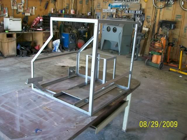

now for some sandblasting!
looks like the hot rod riding lawn mower is broken down????? :?
PS now i see why you have a heart problem. you must go 3 and sum change on da hoof!!!!!!!

bawb you must have a pretty nice air compressor to run that sand blaster.. looks like it makes quick work outa that frame.
Bawb is probably better equipped than most of the car collision places..

yes i have almost every conceivable tool known to mankind EXCEPT a plasma cutter......always wanted one !

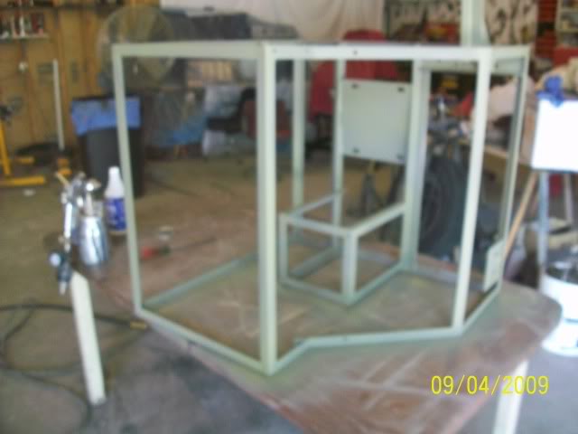

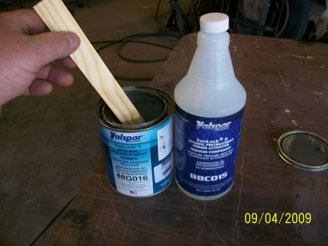

Next comes the TWO PART self-etching primer....this stuff is pretty much bullet-proof........
as you can see it dries to a GREEN color.....
next comes the two part Epoxy 2K primer after this....
