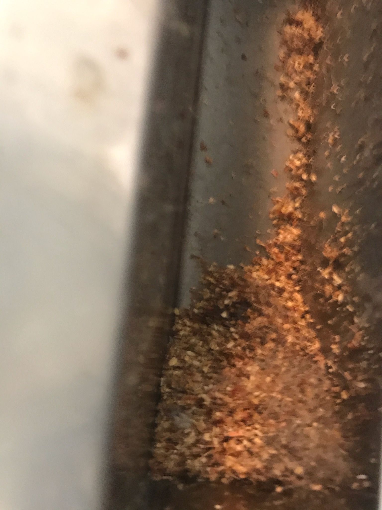

I was called in for some help where a cleaner couldn't get a cat odor out of a carpet. There were a few reasons that they didn't get the odor out, but one that I hadn't thought of much before:
Note the amount of "Kitty Litter" in the Renovator of my Brush Pro; this was from just one corner of the room where the two cat boxes were kept.
Getting this odor soaked litter out of the carpet went a big way to solving their problem
Treating the baseboards, walls, and getting rid of some furnishing the cats "used" took care of the rest.
Unlike dogs, cats like to just jump up on and "go" all over everything.

Ive tried using the home owner's vacuum on pee jobs.|
just made me sick. Once was enough.
If I did this for a living (instead of free for friends and family), I would need spare CRB brushes or time and place to clean them between jobs.
What do you do with your brushes after a urine jobs Mike and Jeff?
Reactions: Desk Jockey
It would seem even worse than a vacuum because you're grinding more.
Although the advantage is they can be cleaned vs the vacuum which would be difficult.

I'll pre-spray the shit out of them and then run the CRB to get cat litter and sand and hair out and then rinse it...

The main reason 2vacuums are in my truck. I don’t care if my slum apartment vacuum runs over cat piss. Just sprinkle some pink ultrapak powder for smell good in the bag and mow it over
And take the pretty clean vacuum in my normal houses

Only use UV light for YOUR diagnostic needs, not to sell the job. It will come back to bite you. Did one for a lawyer today that we ran the CRB both pre and post prespraying. Vacuumed the shitlins' with the TM hose.
Cleanup is easy, pop out the brushes and hit with the pressure wand as we wrap up.
