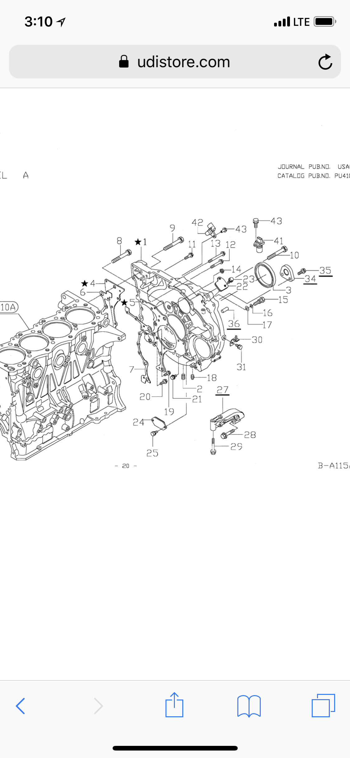

There are 2 sensors around the flywheel housing, check wiring for damage.
Next would be to ohm them out to check if they have failed.
Both sensors only have 1 screw holding each.

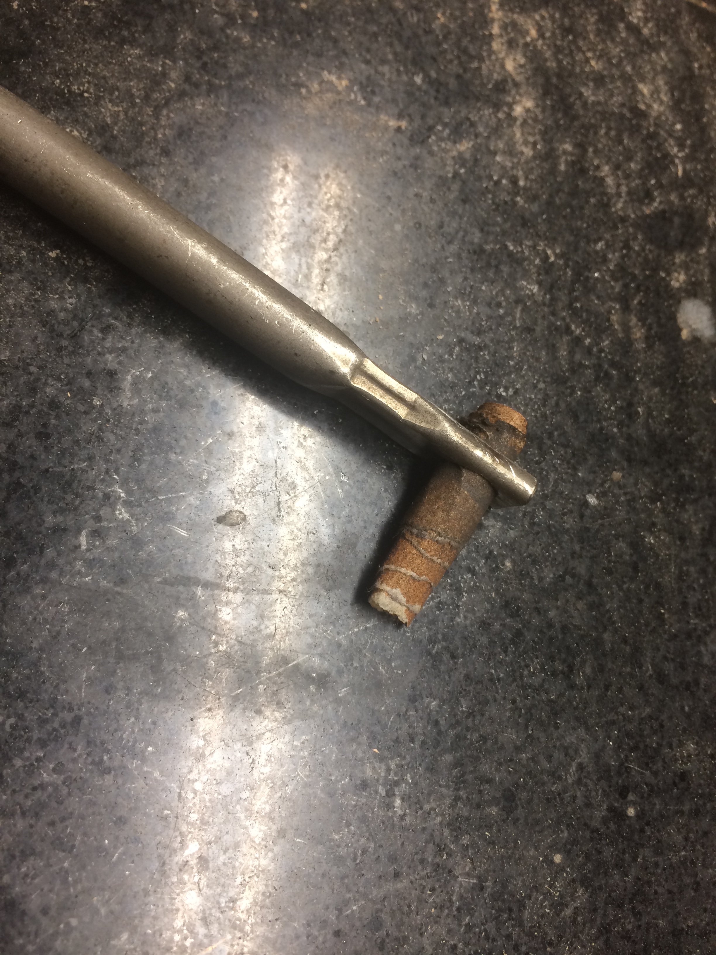

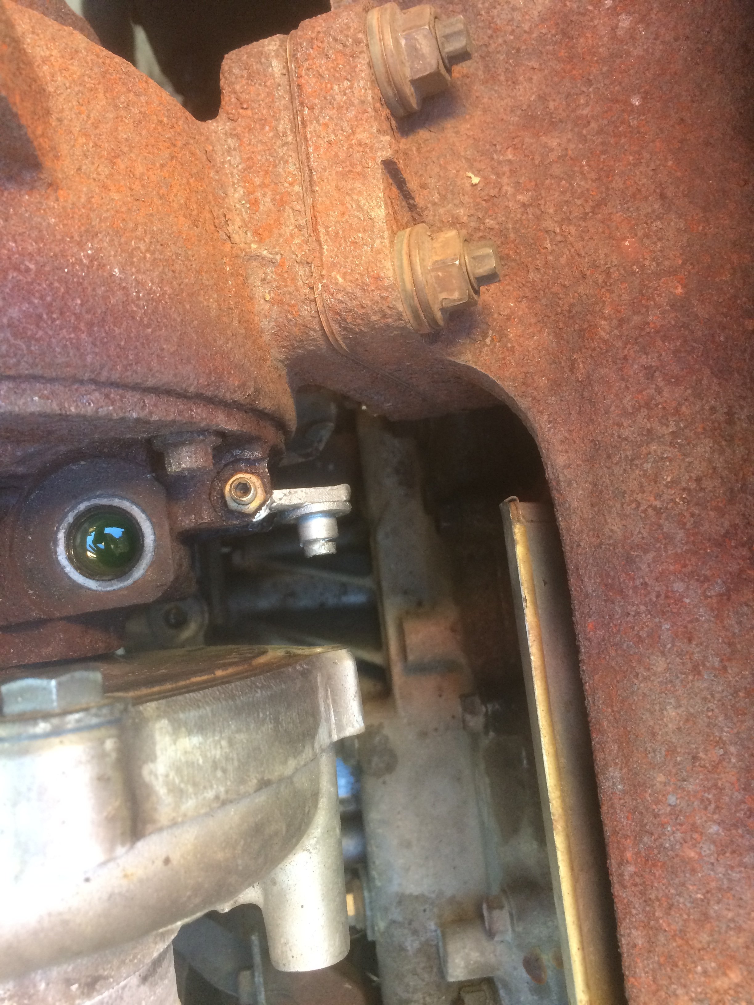

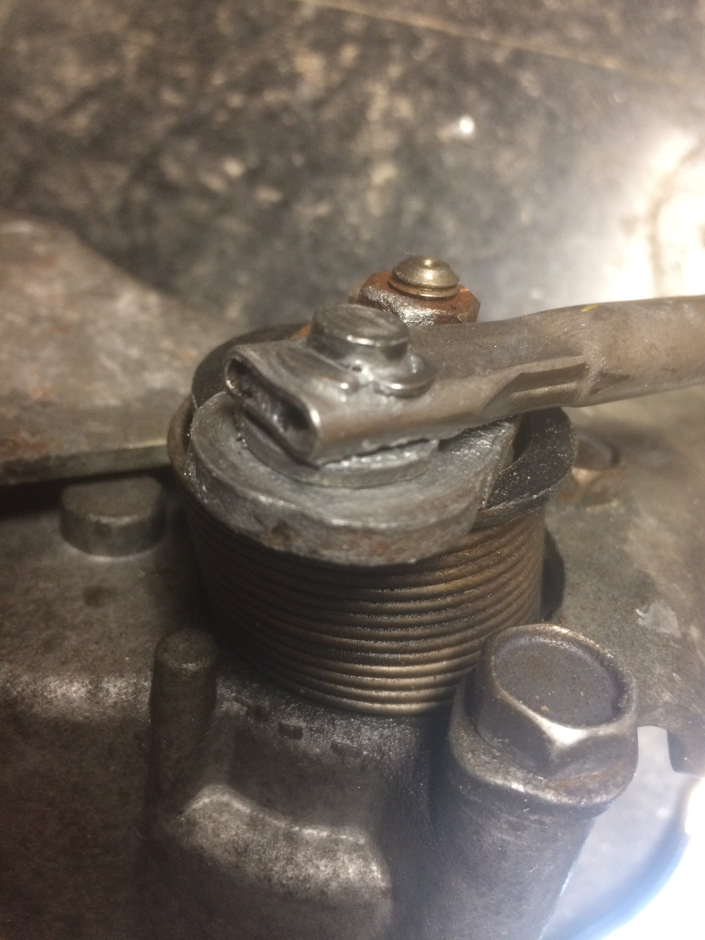

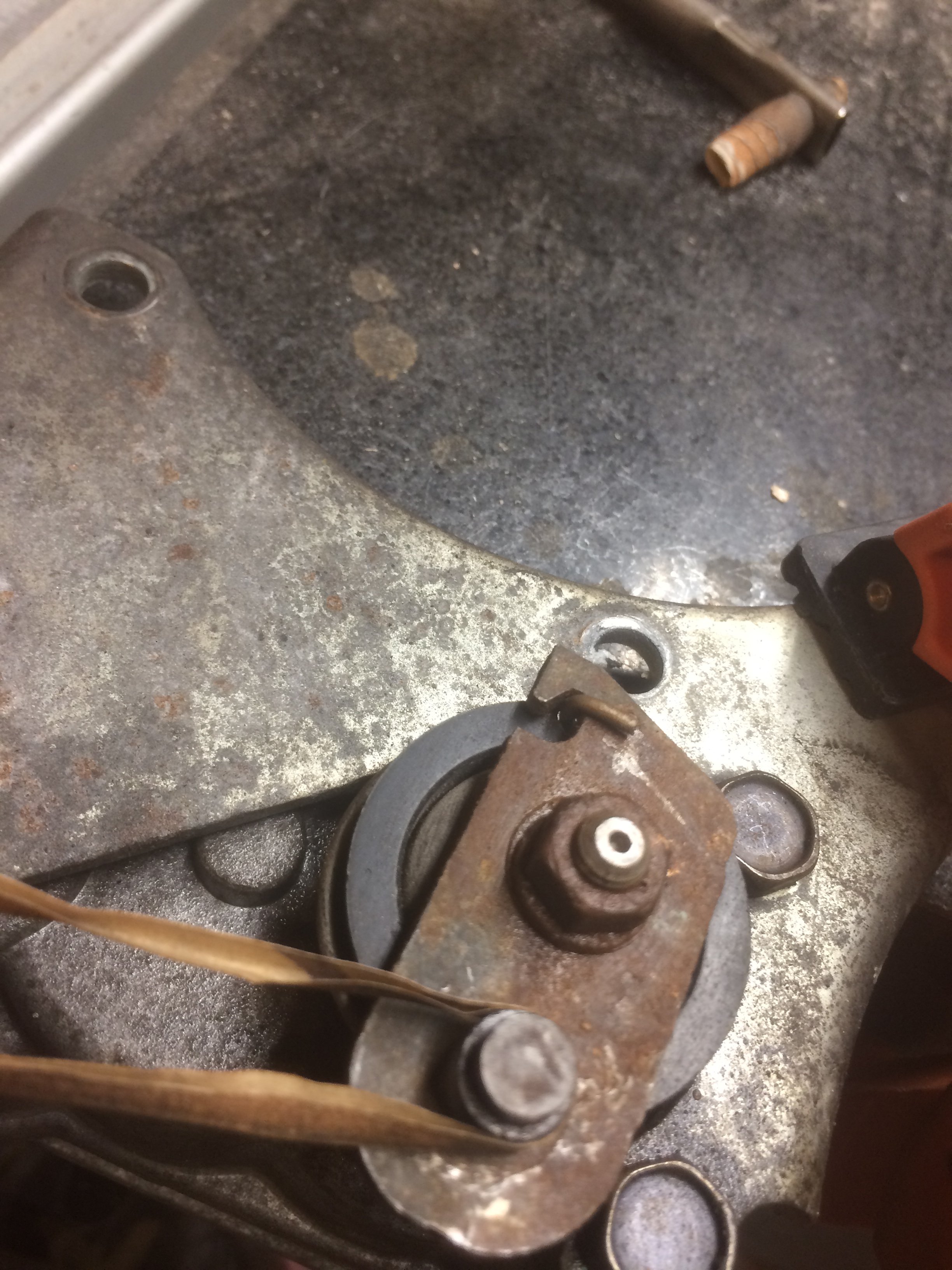

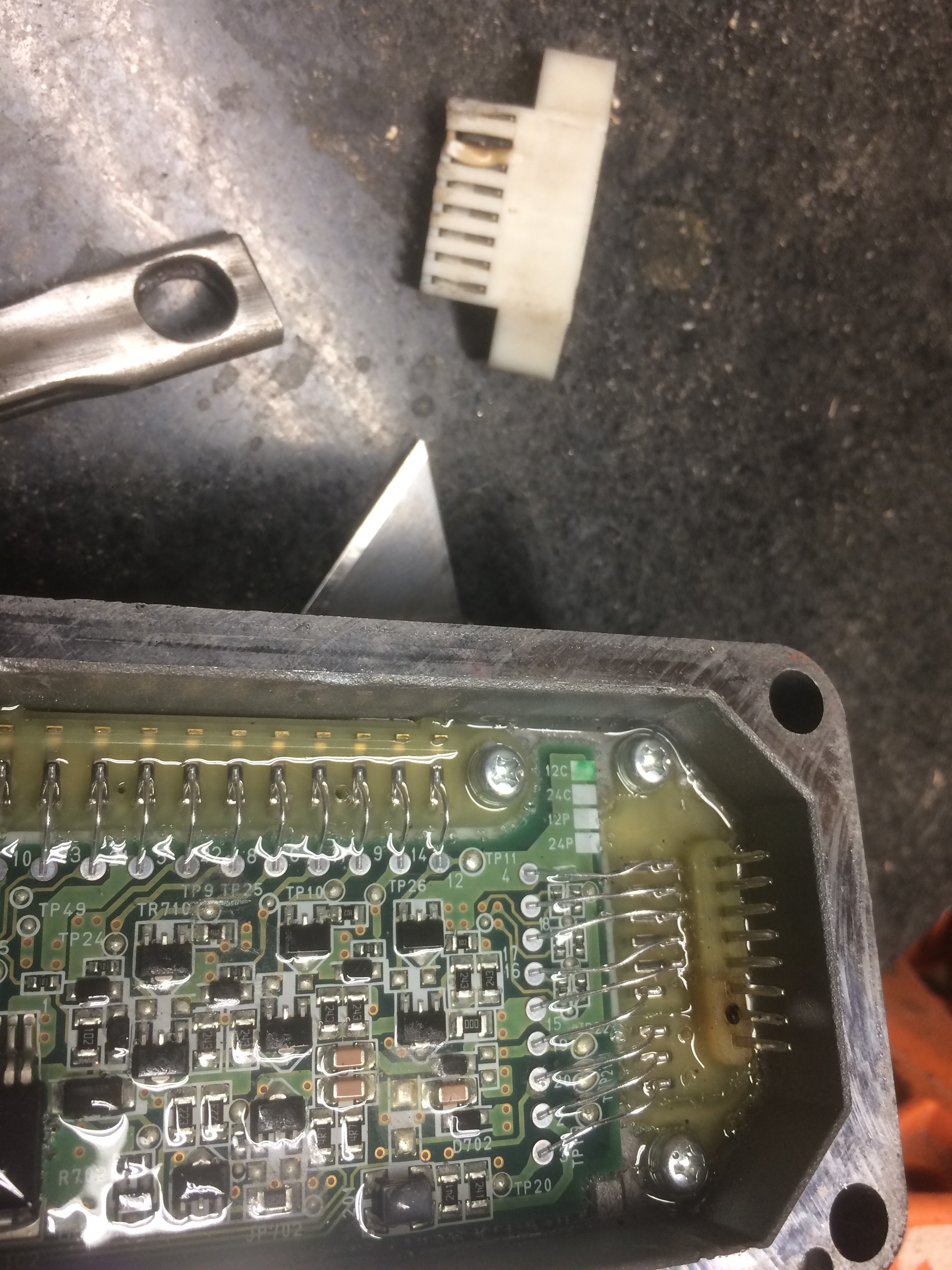

So I've decided to dig this one up from the grave! I waited for some time to update because I wanted to make sure I got it right. A couple years ago I had some turbo problems and I was unable to figure it out. If you read above👆, you will learn more of my pain! I wanted to follow up on this post just in case some other poor fool has the same problems because there is a serious lack of information and technical support on these UD trucks(on purpose I'm sure). A quick run down...truck went into limp mode and wouldn't give it the power it needs. Check engine light flashes 35 and I learned that its the turbo actuator having problems. Some awesome members here had some great ideas and valuable input. I so appreciate it! So here is what has happened since. 2007 UD 1400 Vortex H.A.T. (made in Arizona)
The Hino dealer told me how long the truck was going to be down for repairs and I thought that that was unacceptable. I'd lose more $ than the cost of the turbo. So I thought, "lets see what I can accomplish over the weekend". I had my 6yr old son climb in the cab and cycle the key (without starting it) and see what the turbo actuator would do. It would move but I could easily stop it with my finger. So upon closer inspection, I noticed that the "C" clip that holds the push rod on the turbo was missing, causing the rod to bind a bit because it wasn't lined up where it was supposed to be. So I took it off and lightly sanded the surfaces and reassembled it with some high temp nickel grease and a $.39 clip and I was back in the game! Woo Hoo! Well, that lasted about 6 months and I was back to square one again with code 35.....AAAAAARRRRGGGGHHHHH!!!!! The next available weekend I was up to my elbows in grease again with no new ideas, only determination. Clip was still on there and grease looked good. 6yr old son back in the cab and cycling the key for me. The actuator would barely travel half an inch during the cycle and I could easily stop it with my finger. I had read on another forum (maybe a tow truck forum) that the turbos on these trucks rarely have problems and it almost always is the actuator. So I tried to be brave and dig into the actuator to see what I can find. Pulled it off the turbo, cracked it open and I could see where one of the pins on the inside connector looked a bit burned. It tells me that there was a lot of juice sent to the actuator without results. I cleaned up the pins and applied dielectric grease to the connections. Then I tried to move the electric motor and could barely move it using pliers. "That doesn't seem right!" so I put on my big boy pants and opened the motor and "HOLY CRAP" there is the problem! It turns out that the motor armature was slightly rubbing on the side of the magnets inside and the more it would rub, the more magnetic metal shavings would come off. It was completely jammed up with metal shavings. I cleaned it all up and reassembled the motor but unsure if there was a certain alignment or gear position it should be in. Turns out it doesn't matter! I think that the computer learns the new parameters. Put everything back together and had my son cycle the key again. BIG difference! You cannot stop the actuator with your finger and be careful to not lose your finger! Its been a year and a half and not so much as a hiccup! I hope somebody some day finds this post and helps them out!

I was so excited to put it back together, that I forgot to take pictures of the gummed up motor assembly. Oops!
