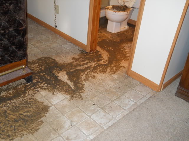

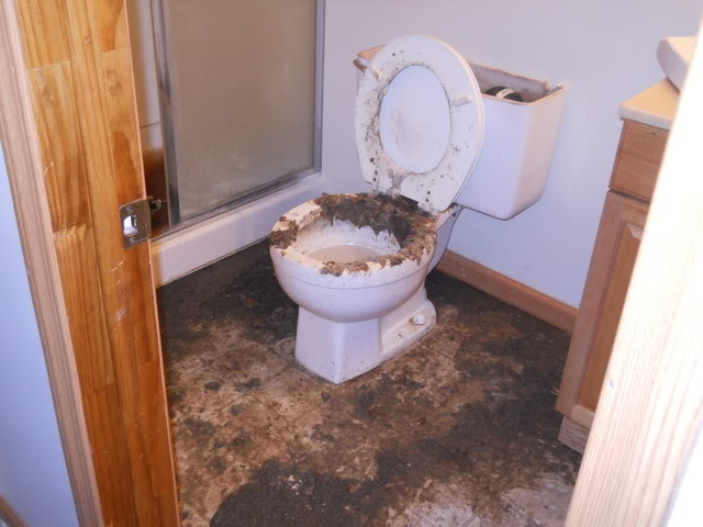

Not exactly the yellow brick road but sewage cleanup helps pay the bills.
<!--[if gte mso 9]><xml> <o:OfficeDocumentSettings> <o:AllowPNG/> </o:OfficeDocumentSettings> </xml><![endif]--> Yes we actually market for this kind of work. We’d like it if when people think of sh*t, they think of us….wait minute…….well something like that anyway. ;)
Ok seriously after a good pressure washing and once over with the turbo you are ready for testing with the Bio-Reveal ATP meter.
What's the trick to pressure washing shit soup inside someones home without making more of a mess??

How do you go into a job like that without gagging?
Full PPE. Heck the pictures were so vivid I had to check my boots for a second there.
Definitely not work for those with a week stomach, some guys can't take it.
However money motivates most and they will actually fight for who "gets" to go. :icon_rolleyes:

What caused that anyways?
Sh*t and a little water, it came up out of the toilet. :p
Mike I'm really not sure, sometimes they tell us but most of the time we just ask if the situation is corrected before we respond. So unless they mention it we usually don't ask. The plumber or drain always know but we are really just focused on the cleanup.

What is the best and or device for sucking that up..
Do you use your truckmount?
How do you clean the houses and equipment afterwords?
We prefer a TM but a portable would be ok too. The TM has the capacity to haul away the contaminants, where the portable you would have to pump it back where it came from.
Actual tools, we like the hard surface tool with the brush head, pressure gun and turbo tool. We charge $250.00 to decontaminate the tools and equipment. Takes a couple of guys a few of hours.

seriously I have done a ton of these sorts of cleanups I would actually call that one a light to medium one. I don't use a hard surface tool but rather just a green glide wand. suck up what I can first. then key the wand like cleaning carpets. get up nearly all of it like that then I have a spray wand I hook up and spray it with that usually while another guy sucks up what I am spraying. the toilet is sprayed off and all the debris is sucked up, DONE. its not that hard but it is gross and I don't particularly like doing it. a truckmount is ideal because of the pressure and heat plus the ability to suck up the shietta. I have lots of stories of sewer from back in the day when I worked for the BIG local company. here is one

PS Those are some good photos, Richard.
I agree Steve G that is not anywhere near the worst we see, it was just the most recent.
