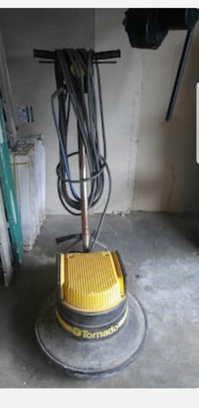

Hey All,
I was finally able to contact the guy with the Tornado and picked it up just now. I now have come across another person that has 5 5Gal containers of GEMSTAR Stratus. He said he's " looking to get" $80 for the lot of 5.
Is this what I want to apply? or should I skip it an go with whatever the Supply place carries.
