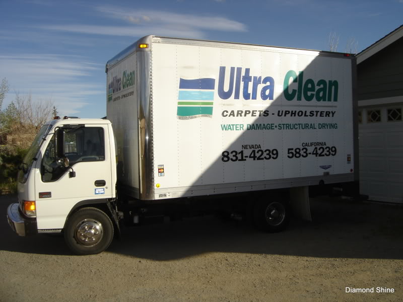

So I bought out a friend's equipment...
PTO...6008 Blower
SS Waste and fresh tanks...large
Lots of room inside...
I'd just like to get a little more heat...
It has a coolant heat exchanger...And an exhaust heat exchanger...
I'm leaning towards propane...maybe a Hotamatic #4...
What do you guys think?
Would you consider a fuel oil burner unit? Pros and cons?
Thanks in advance!- Jim
ps...I know the 10 foot ceiling in the garage is a little low!

Michael...It is a 4 cyl turbo diesel engine...the GMC W4500 42k miles
I would like it to be my main truck...using the Duramax van with ProChem Everest now
Don't mind buying heat...the gigantor truck only runs about 200 now...after warming it up...I'd like 225 at the start...and be able to adjust up if needed.
The exhaust diverter is a 2" gate valve in the exhaust system...

Hey Michael...coolant exchanger is a box...approx size 30' length...18 inches width...14" height ss construction
The exhaust heat exchanger is in the box...just a little smaller in size
I will give you a call just after 8am my time. Thanks
