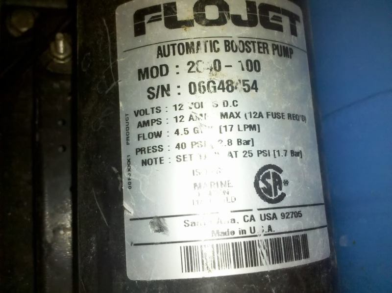

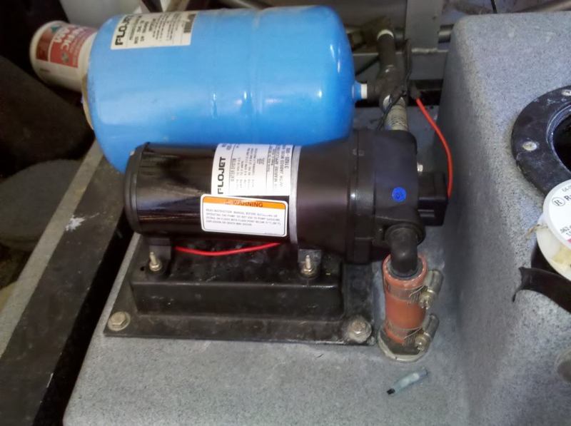

Ok, I've determined my flojet pump is kaput. Did a job today and had no water, checked fresh tank and it was full. I have power to the pump. So I took the pump out to check the switch. Switch works just dandy, has continuity and no continuity when pressed in. I hooked the pump directly to a battery and it worked for a second then wont anymore. The motor has no continuity. I also noticed fluctuations when cleaning yesterday so I'm pretty sure it's the motor.
So that's the testing I went through.
Anyways. I'm looking at dultmier and have found some for around 90 bucks or so. It's a 45 psi 4.5 gpm pump model FJ4300-504 http://www.dultmeier.com/products/search/7491
This is the pump
I think it will work but want to check with someone who probably knows.
I also need a new pump for my omni sprayer and want to convert it to a demand pump if possible. Any suggestions for a replacement pump for the omni also?

I found the model # of the exact pump flojet 04325-143A
I think it will probably be best to buy what it came with because it should fit and work properly. So far best price I've found is 142. I'm going to keep looking and if I can't find a better price that's what I'll get....

Do you have a filter on the pump? Maybe it clogged causing the pump not to pump or shut down. Do you run a blue tank so the pump doesn't have to run as long. can't think of what its called. maybe a bladder. Only replaced 1 pump in 8 years.
TimP
May 19, 2007
4,055
Yes to both of your questions. It's a hydramaster 85 gallon rotomolded fresh water tank. I run an Rx-20 and a high flow wand so I think that had something to do with the problem, with it running all the time.

I just got it installed. The pump came in yesterday....I didn't have time to put it in. I put it in today between jobs. I have my last job scheduled at 4:30 today. Works great. I twisted the wires together after checking polarity, soldered them and then put electrical tape over them It may not be the most professional wiring job but it works....

Both were done before I got the machine..... The pump was still good the motor went out is all. There was no strain what so ever for it to self prime. The water goes to the bladder and cuts off when the pressure gets to a certain point. When the pump reaches like 40 psi it stops. Also the motor is supposed to be continuous duty, that's why I think it cost a bit more but an electric motor isn't going to last forever.
