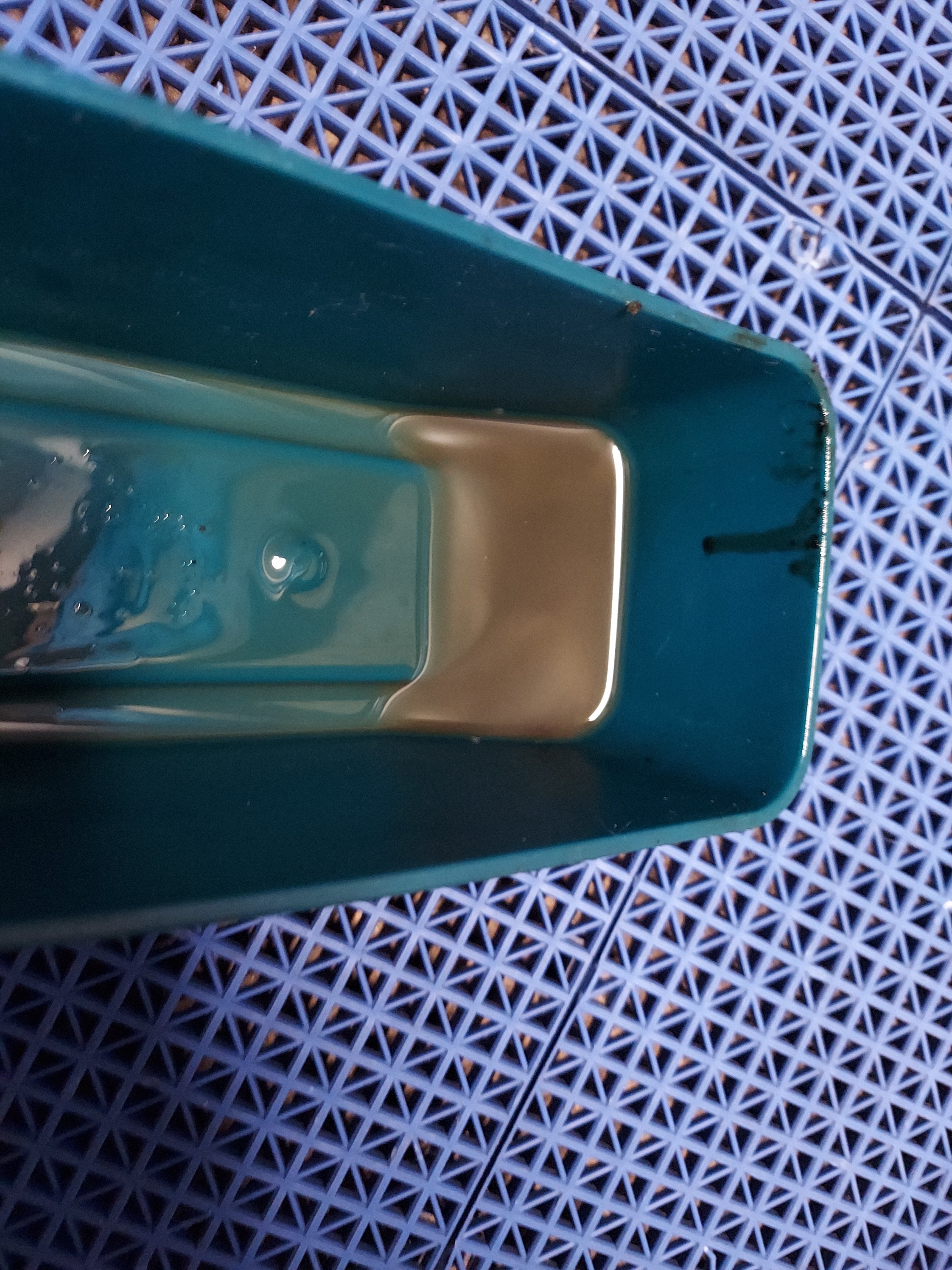

so I did 2 things today that the machine does not like. I ran out of water and I shut it off b4 it cooled down to below 170.
So now I dont have water pressure.
in the past it would fix itself once it cooled down and perhaps a vapor lock worked its self out.
I lubed the pressure regulator and the transfer pump I working.
it has 935 hours on it.
here is a photo of the water pump oil. sorta looks like it might have water in it. could it be the seals need replacing?

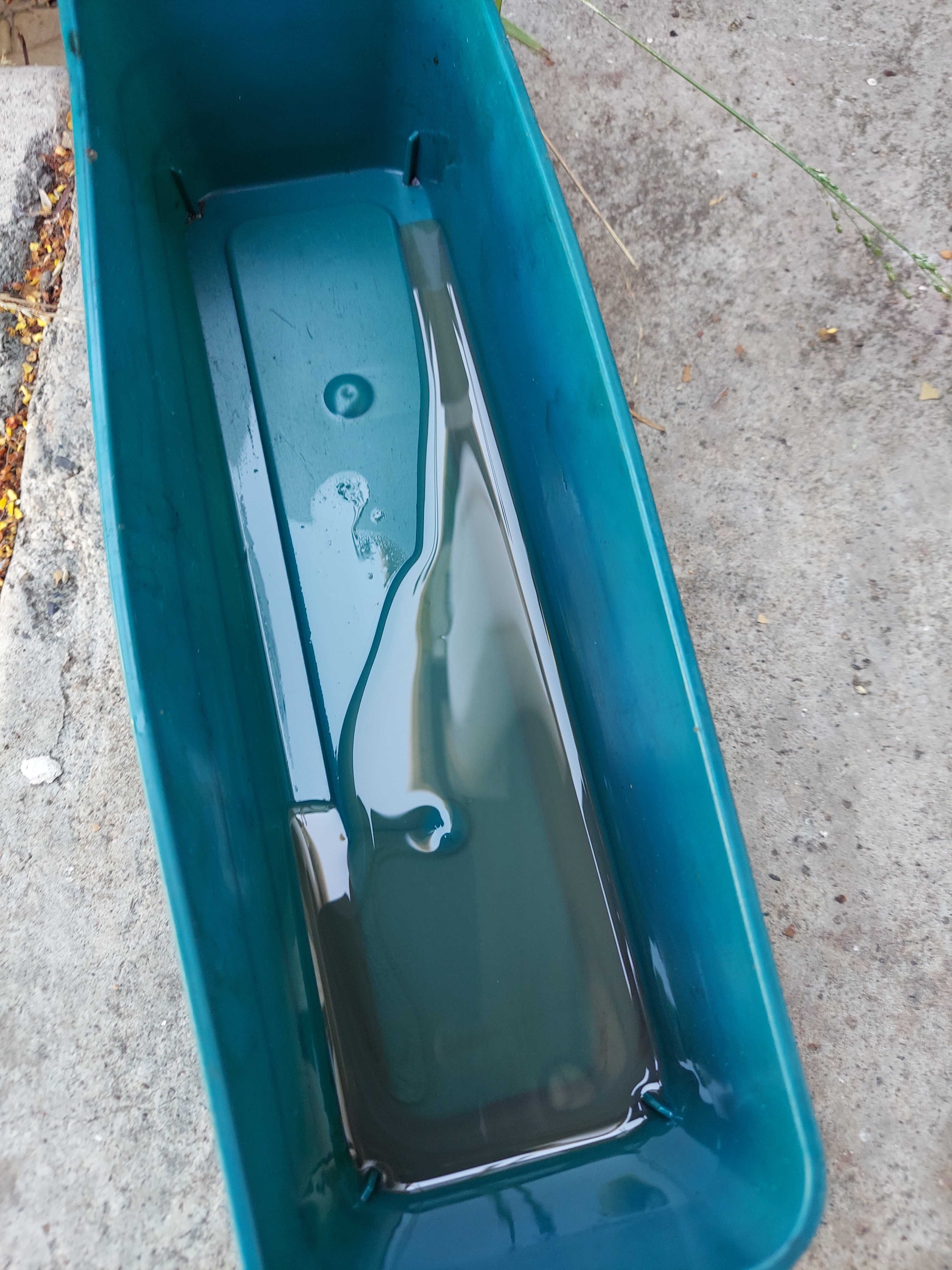

Justin with Legend brands said the oil looked milky-- but i did send him a better picture than the one i posted.
Only ran dry for few minutes. I Installed a new belt and will bring to dealer tomorrow.20211010_174157.jpg
doesnt this oil look milky?

must be a much better pic cause i'm not seeing it either
edit: I guess the second pic kind of has the chocolate milk appearance....but if I had to guess given your description of events it's more likely running out of water just allowed another problem preventing prime to present itself
Only ran dry for few minutes. I Installed a new belt and will bring to dealer tomorrow.View attachment 111153
that pic looks a little different than the first one.
but that's not why you can't get it to prime
