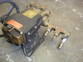

I like Mike's a little more, but this is the set up I had when I cleaned (before having access to Les's wisdom), in fact the pump still ran fine the day i removed it, if someone needs a pump cheap ready to go, just PM me.
As you can see, I had the starve set with a ball valve barely closed, and the regulator bypass came inclose to the pump head, and the dwyer fed in between....]foolproof, always worked.
I can think of another reason to Stay with a simple siphon, you don't have to worry about blowing diaphrams and bypassing your chem system just because you are running high pressure, 800 psi is brutal on diaphram pumps.

I was using Greenie's pump pic in the quoted post above for reference... I'm still trying to decipher Bawb's cryptic codes he speaks in.....
