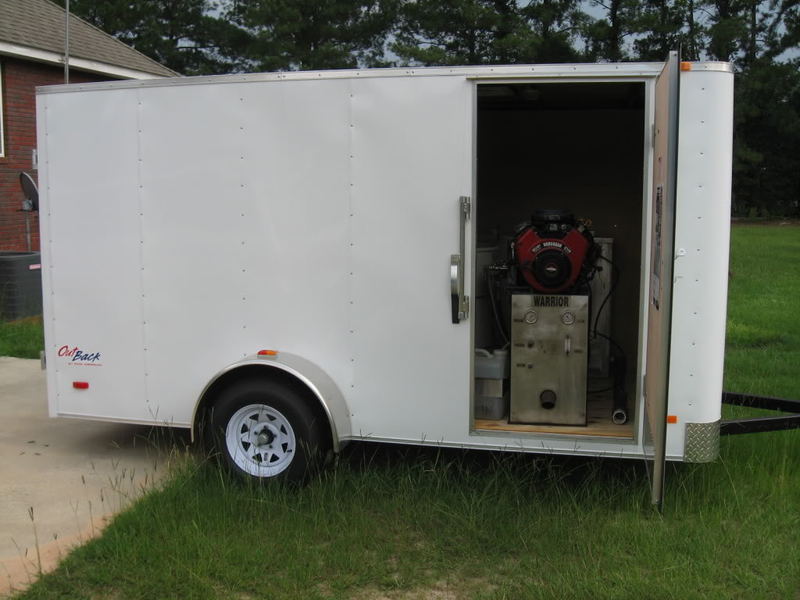

Yes it is a TCS warrior. A Marty special as I like to call it. 18 hp briggs engine, cat 3 pump, a lg 3ht, and a 36 blower. It actually has good suck from the vac port off the blower. I can't wait to see if it puts my cds to shame in suck at the wand.

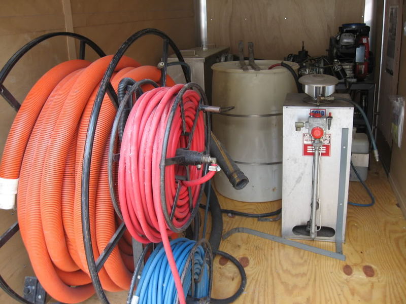

It looks like it would do the job. I like the simplicity of that setup. That’s a fancy live fresh water real. Is there a float shut off or overflow drain on the fresh water 55 gal drum?

The drum has a float and there is no overflow for it. That reel is an electric vac reel too buddy so it sure is FANCY :shock:
BTW I did buy this machine off a Mikeys Board member.

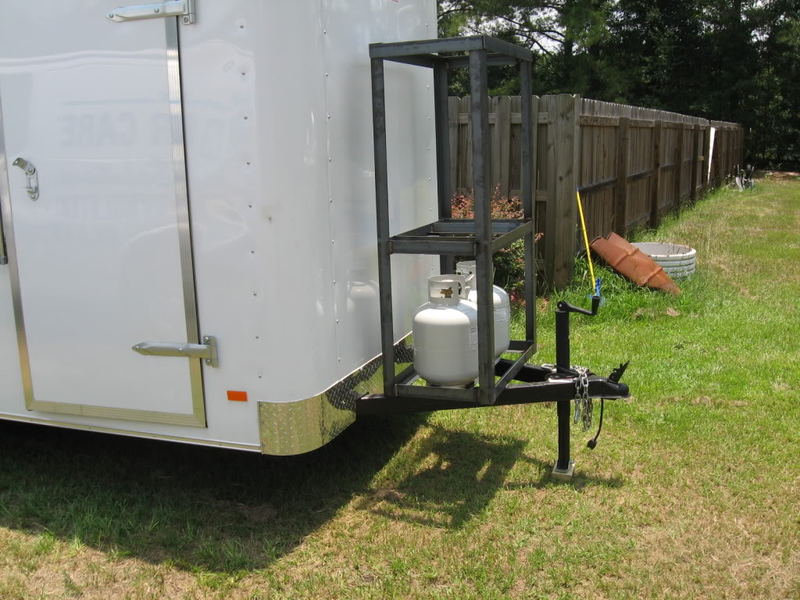

Ok here is the stuff they welded on the tongue. I'm going to have to paint it eventually to keep it from rusting but it's the best I could get done in such a short time. Tomorrow I'm going to get it all connected and it should be good to go. And if you couldn't tell we cut the grass....

Tim, nice set up, did you buy the trailer separate, or was the equip. already in it?
TimP
May 19, 2007
4,055
I bought the equipment from a member on MB and bought the trailer seperate and I'm trying to get it all going now.

That's a nice rig. If you put a swept 2.5 inch port on the waste tank and run 2.5 to the trailer door, you'll have more suck. TCS doesn't plumb as well as I would like for them to.

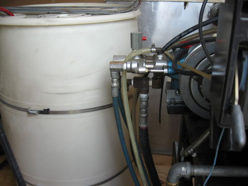

It's up and running now. It will be a machine I have to get used to as far as my cleaning habbits. There isn't as much suck off the carpet is what I noticed but when you put the wand on the carpet it takes about 5-10 seconds for the power to build up under the load. It sucks pretty good at 1 lenght of hose which I tried. Just as good suck or better than my cds once it builds back up. My CDS has the electronic idle so it adjusts a lot quicker I guess.
I think the water pump may need new seals other than that it's good to go for tomorrow.
