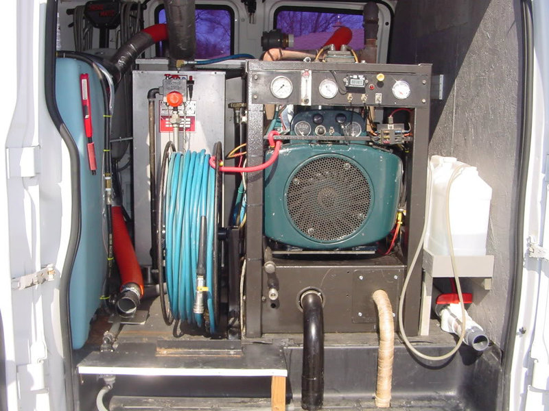

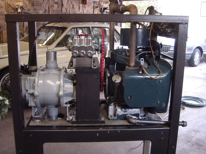

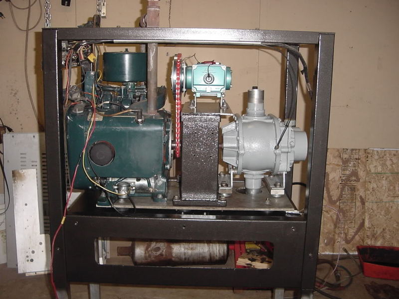

Just saw Andy's post with his 30yr old Hydracat and thought I'd show some pics of my 30yr old TurboTech Commander. It was my first TM when I bought it used in 1987. Other than having the same basic layout it doesn't look at all original. It came with a 20 horse Onan connected with a Dodge coupler to #4 Sutorbilt, Cat 290 w/clutch, Stoddard silencer, and 95 gallon aluminium recovery tank. Water is heated with a 120,000 btu Little Giant. It's had many renovations over the years. First the engine wore out so I upgraded to the 23 horse Kohler. After the blower went out I replaced it with the Roots 45. I never really liked the Cat 290 so I just replaced it with a 310. This past winter I stripped it down, cleaned, painted and re-plumbed it.
It is pumbed with 2.5" into one end of the recovery lid and out the other end with 2.5" using Greenies elbows. I also put a 14" Kunkle in the lid. This engine and blower combination have well over 6000 hrs and the only thing I've had to do over the years is routine maintence. I love using this unit.

Sweet! Paid for itself 100x plus! Good job on the upgrades and rebuild. What's the hard line/pipe for the propane intake hose for? Why'd you make it a hard line?
Shane T
Nov 7, 2006
1,663
Waukesha, WI
Shane Tiegs
I have my propane tank mounted in the back corner of the van and the flexible hose was to short to reach in a safe and out of the way manner.
