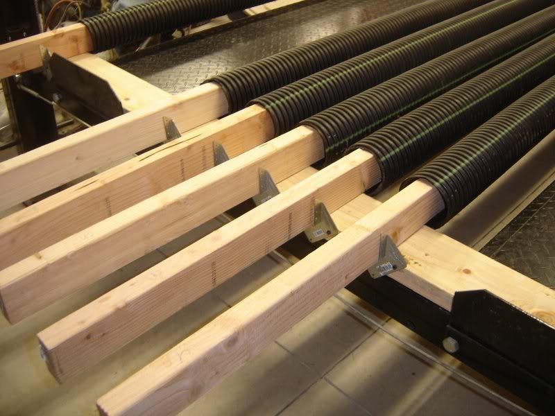

Thank you, Lisa!
I guess my rug drying rack fits into the 'homegrown' method...
All the rugs get lifted by the 4 post 7000 lb hot rod lift.

Mine's "home grown" too. =) Nothing wrong with that!
