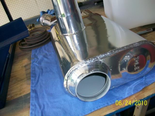

i guess i should remember the part # but i don't.....its the 13" body off/in..off out 3"...you gotta get it ceramic coated yorsef if you want it to last forever...........

No larry it takes TWO to quiet a 47.....one at the blower ...then ANOTHER underneath....
CRASH gets 16Hg wit his Genie plumbed that way...
ask him!

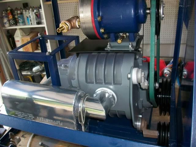

Bob- does that matter that there is a sharp 45 degree angle right at the blower outlet?
For some reason I always believed that the blower should have the straightest plumbing possible on both the in and out side to not choke it down.
We need to quiet down an old Sledge Hammer unit (duane bulit) with a 47 in it, and was just wondering about a muffler too.

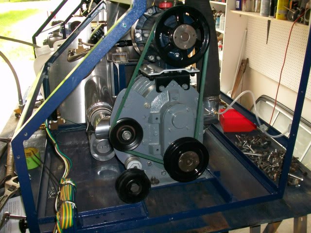

nice belt tensioner on that Bob. Very simple
a BETTER picture of the tensioner system...
very easy to change belts......
notice the Gates green belts....the very best to use

I'll have to check but I dont think I can fit one inside by the Blower. It has two HX's setting beside it also.

A 47 turning at 3200+rpms makes alot of noise, you really need a Stoddard silencer If you want it quieter. I used a 36 for a while with dual mufflers and it was a little too loud at 3400rpms but with a silencer it humms. More expensive yes but well worth it. Bobs Genie's are great with mufflers with the system turning at a quiet 2000rpms or so. He makes a nice genie thats for sure. :mrgreen:

thanks....... but if you can get 15-16 Hg turning it 1900-2000 RPMs....
why not?
and Larry...you can MOVE that HX anywhere you want...ya know!
i lik to set them between the seats...so i can keep an eye on it!

Like Jay said. If you run that 47 blower faster thn 2000rpms its going to be real loud even with two mufflers. I run a blower heat exchanger and two mufflers that Les recommends. Normally run at 2800rpms and it is too loud for my liking. Going to install a Stoddard this winter.

Nope. Doesn't look all that different. Just looks like a muffler with baffles and perhaps some insulation. The only thing that may help some when using mufflers as silencers is to put the first one directly attached to the blower(like Bob's). I think silencers are also made of much heavier gauge metal with insulation between layers. This reduces noice through the body of the silencer. The mufflers on mine have done a fair job of quieting the noise out the end, but still too much resonate noise around the system. Just my humble opinion.
