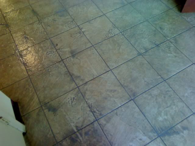

I've walked over this tramp 1200 times to get to the CGD beyond.
They finally gave me the go ahead to get the Mop and Glow residue off her.
before..
during the initial striping (Oxy Blaster and Zep)

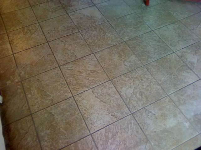

After the first strip tease..

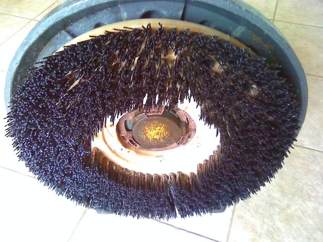

and one more lap dance with the Malgrit brush from JonDon
the Beast... Don't leave home with out it and a pocket full of singles..

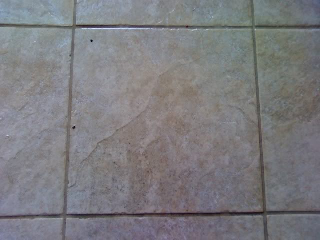

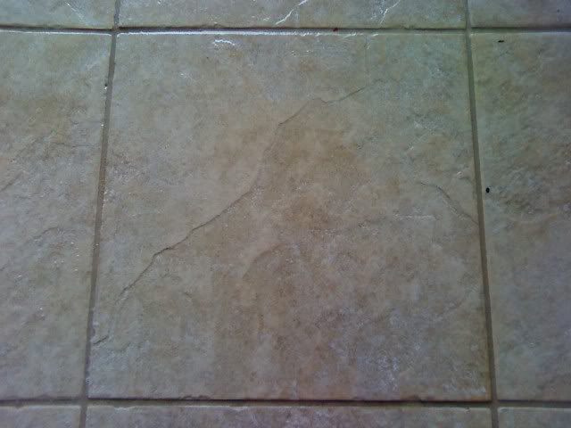

Wow great job!! Mop and glow is a bitch. I just did two area's last week at a University that had years of VCT wax and dirty mop water on the T&G, Barebones Stripper twice then hit it with acid , used the same brush on the rotary , plus still had to scrub the grout lines twice. Just to get enough crap removed to color seal.
