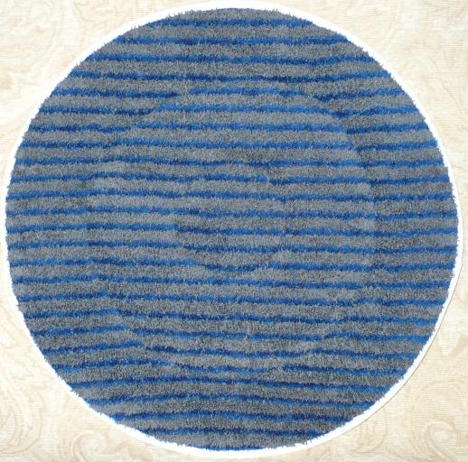

We have used both microfiber and 100% cotton bonnets.
A "quality" microfiber bonnet does a very good job.
It is also more durable to laundering cycles.
These are the ones I like:
Larry
