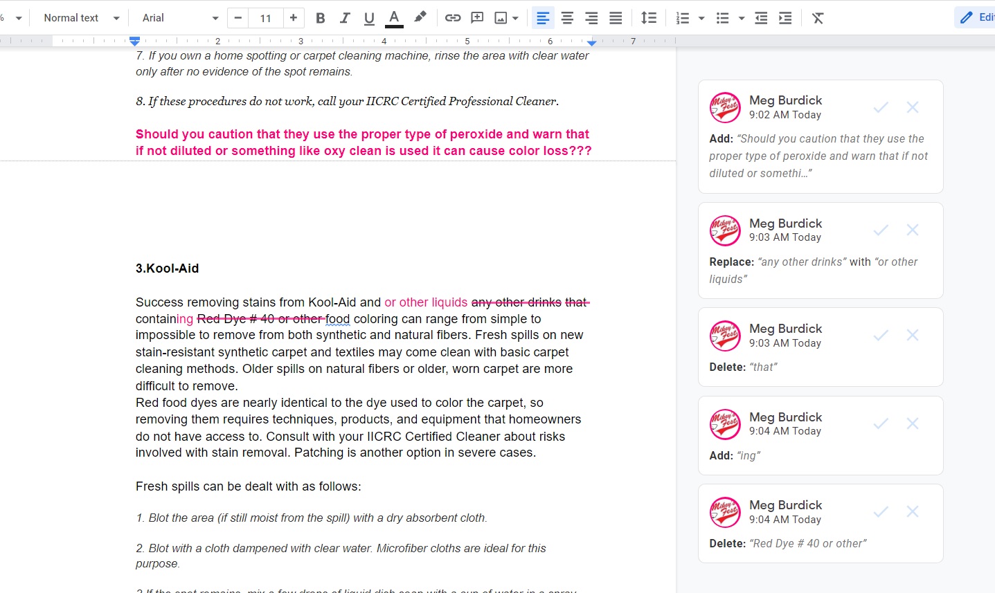

3.Kool-Aid
Success in removing stains from Kool-Aid and or other liquids containing food coloring, can be very difficult to remove. Fresh spills on new stain-resistant synthetic carpet and textiles may come clean with basic carpet cleaning methods. Older spills on natural fibers or older, worn carpet are more difficult to remove.
Red food dyes are nearly identical to the dye used to color the carpet, so removing them requires techniques, products, and equipment that homeowners do not have access to. Consult with your IICRC Certified Cleaner about risks involved with stain removal. Patching is another option in severe cases.
Fresh spills can be dealt with as follows:
1. Blot the area (if still moist from the spill) with a dry absorbent cloth.
2. Blot with a cloth dampened with clear water. Microfiber cloths are ideal for this purpose.
3.If the spot remains, mix a few drops of liquid dish soap with a cup of water in a spray bottle and mist onto the area and blot
4. Repeat until the spot disappears, making sure to blot between each application
5. Residual discoloration may be removed by applying 3% hydrogen peroxide, and leaving it on the spot until the desired result is achieved. This may take several hours or a few attempts.
6. If you own a home spotting or carpet cleaning machine, rinse the area with clear water only after no evidence of the spot remains.
7. If these procedures do not work, call your IICRC Certified Professional Cleaner.
