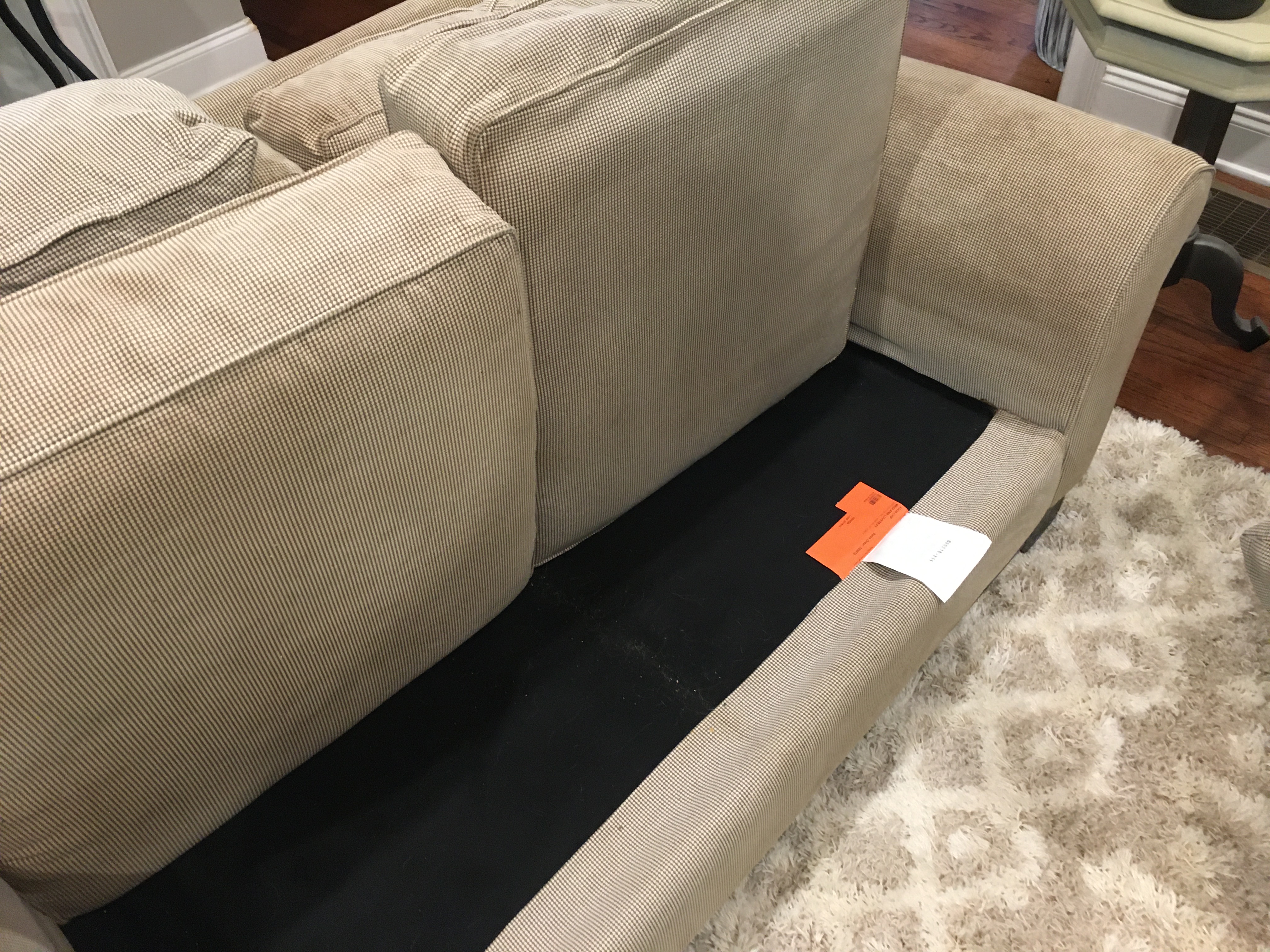

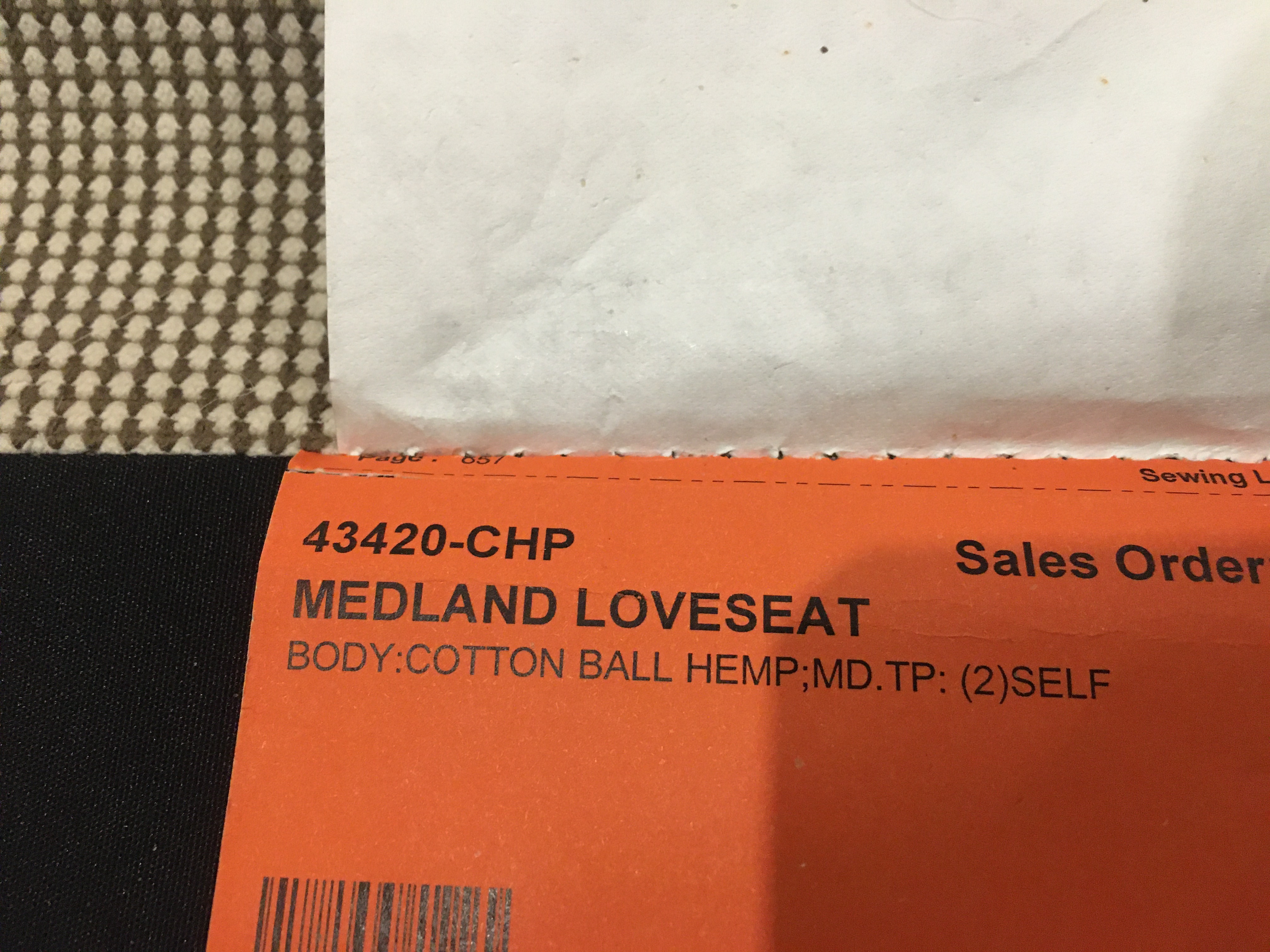

Cotton ball hemp is the correct name.
I just used prochem upholstery spray and hot water extracted. It had heavy dog body oils and red clay.
Any other suggestions on how to clean hemp?
0BC75DF5-9521-4147-9F2D-024840FE3DD8.jpeg 70FB4F6B-6644-4A2C-A87F-1F9EE7498914.jpeg
12,590
If you follow cotton cleaning procedures, you should be fine. Watch using too much percarbonate as a booster or peroxide as a spotter, as you can overwhiten it
14,128
I had no desire to mess with peroxide on this material, but I was concerned about any browning, since it is cotton
12,590
I considered low moisture but that was not an option due to the heavy soiling
To be more clear, I didn't mean dry foam or encap, but just a limited wetting tool and not an old fashioned "hose it down with the Prochem stainless steel tool or the equivalent technique".
It seems it turned out well for you, so its all good.
Always feel free to call me.
