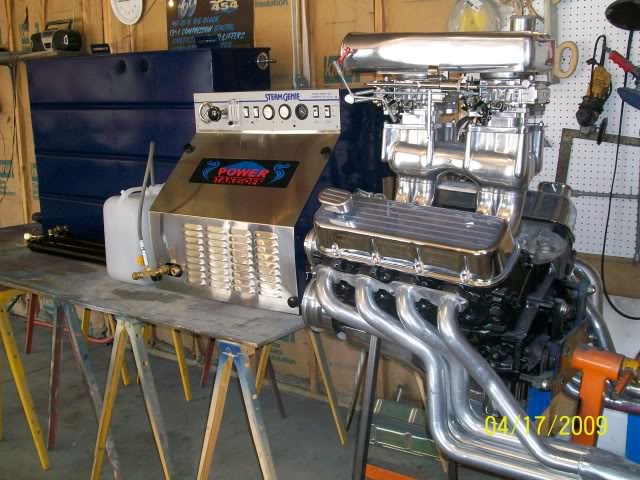

44,401
La La Land
sooooooooooo some doofuss pedestrian comes walkin' along... sees the unit...starts twisting dials an blows up more people than the unibomber.
then whats ya gonna do...huh...
YOU CAN'T BEAT ME!!!
dgardner
Apr 7, 2008
5,109
Phoenix, AZ
Dan Gardner
Or I could crank your super Paraplate regulator to the max and that great Wanner pump will pop the hoses and scald everyone in the room to death... That's kinda a problem everyone faces.
But enough! I cower before your superior intellect, knowledge and reasoning ability. You win. :roll:
I'm going outside to practice a little TIG welding before bedtime.
44,401
La La Land
i'll leave you wit THIS image
