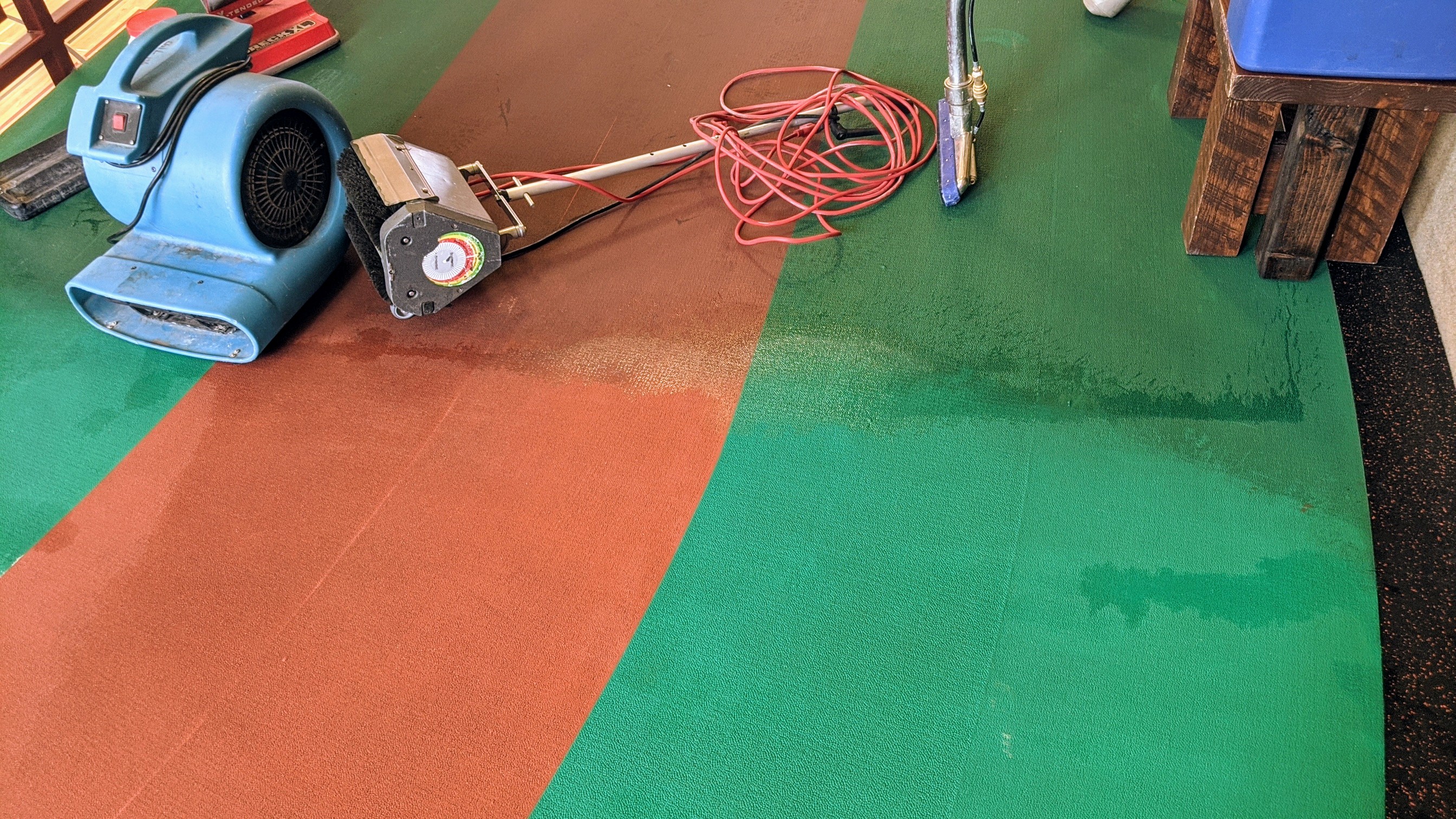

Lordy be, rubber track to hell...
116,241

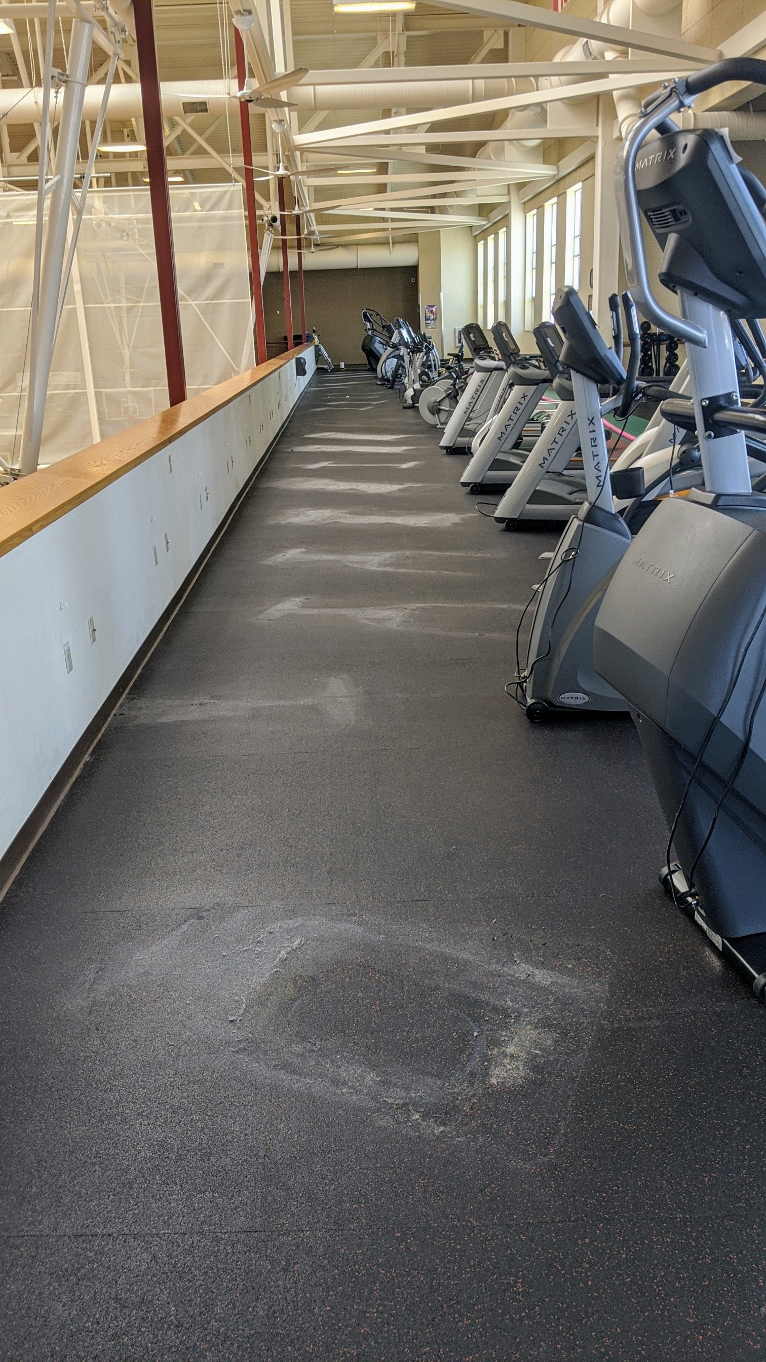

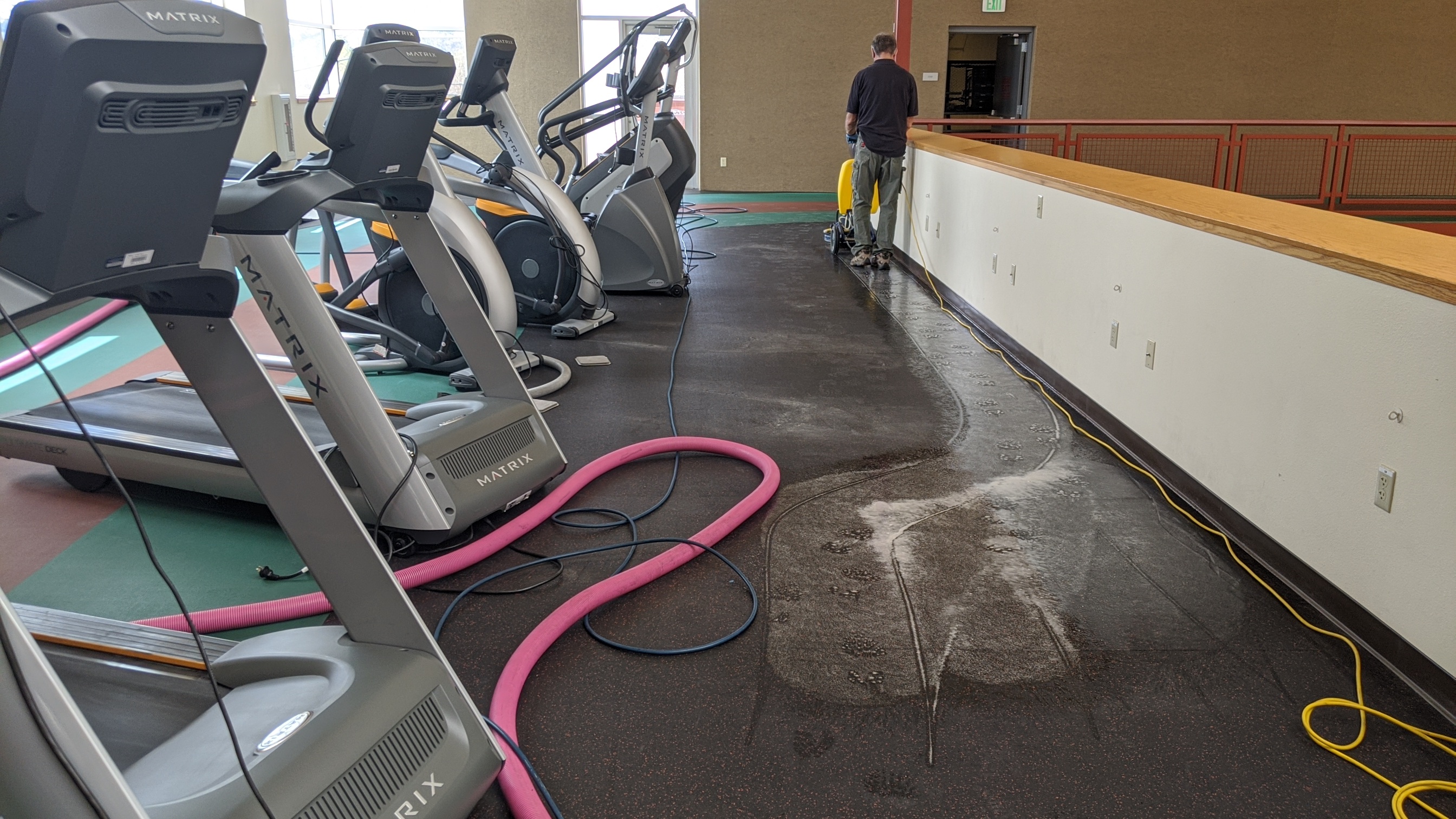

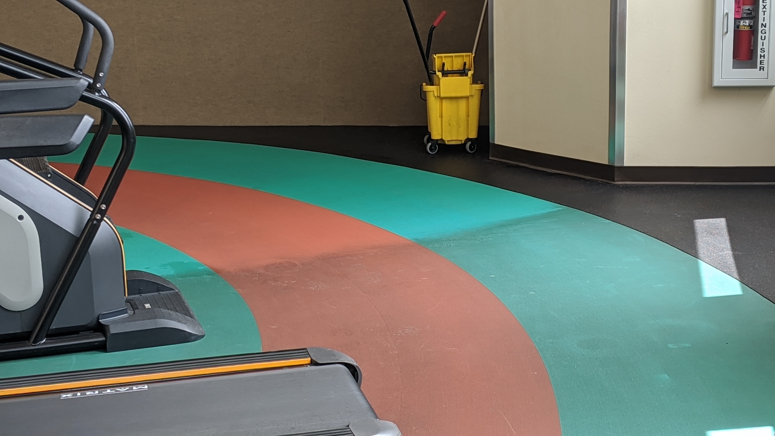

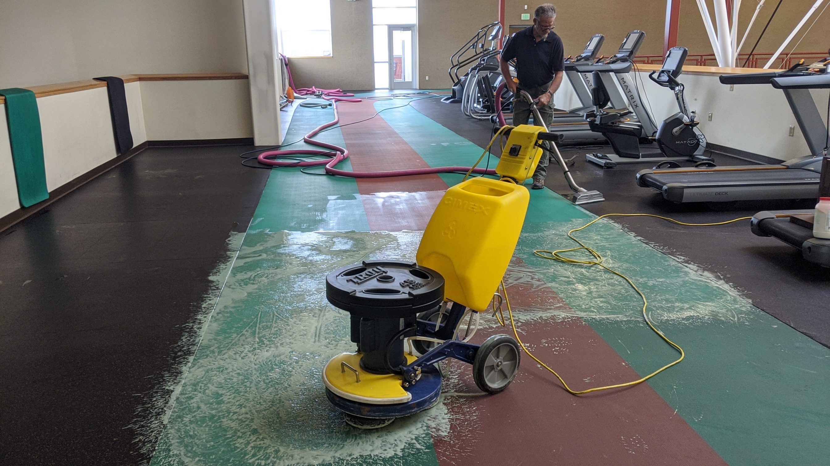

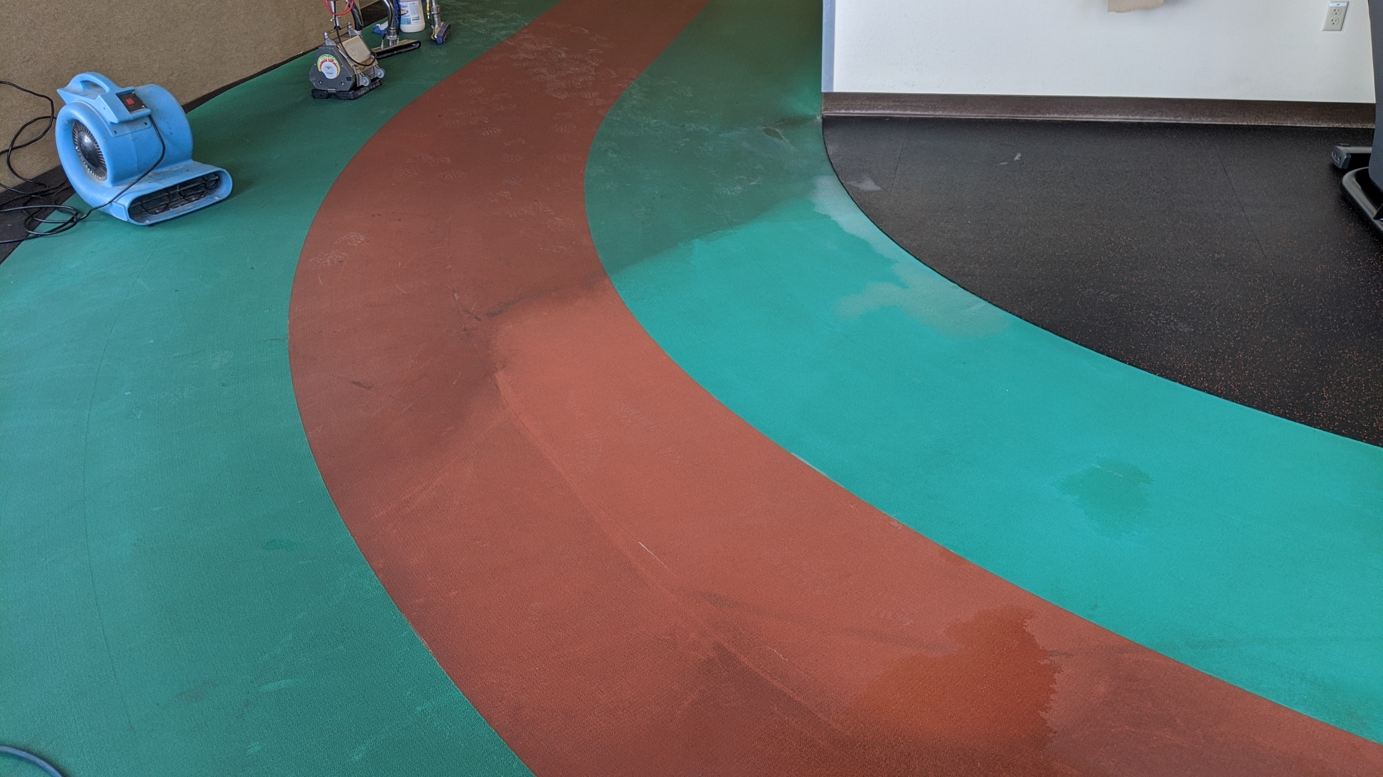

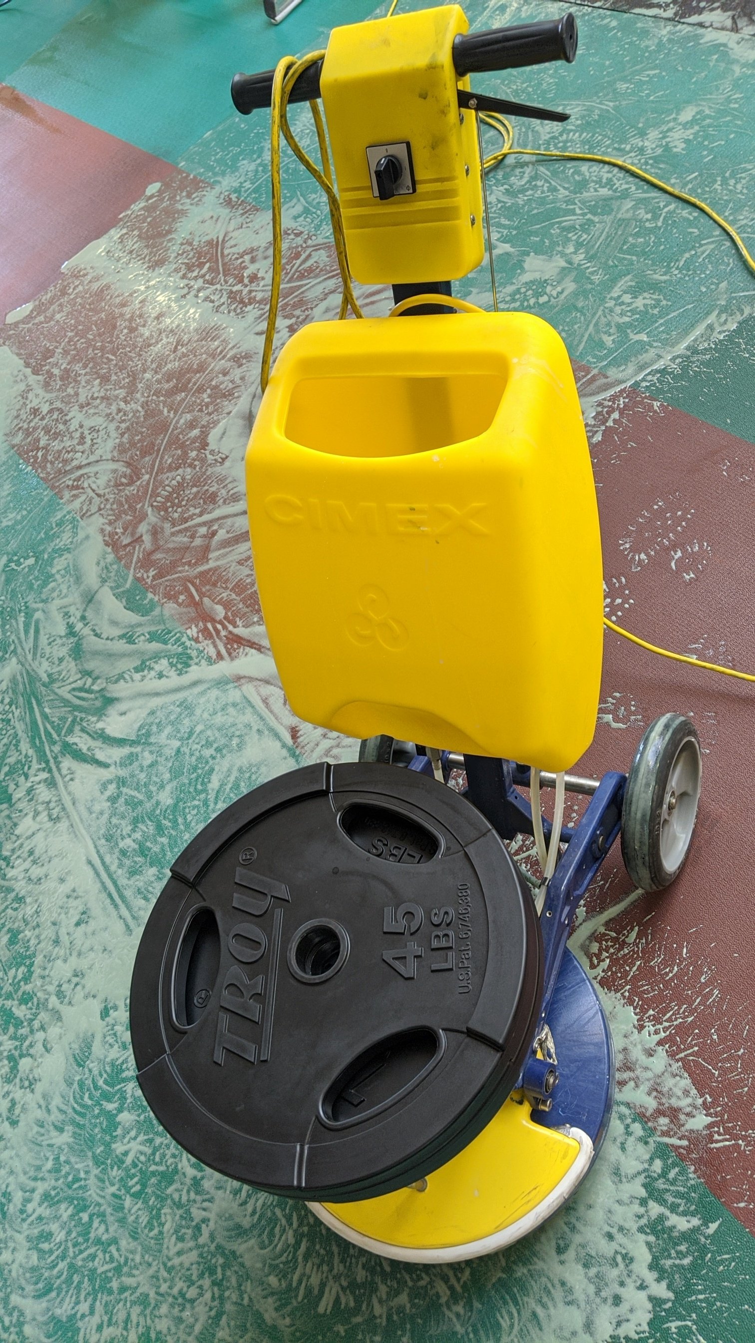

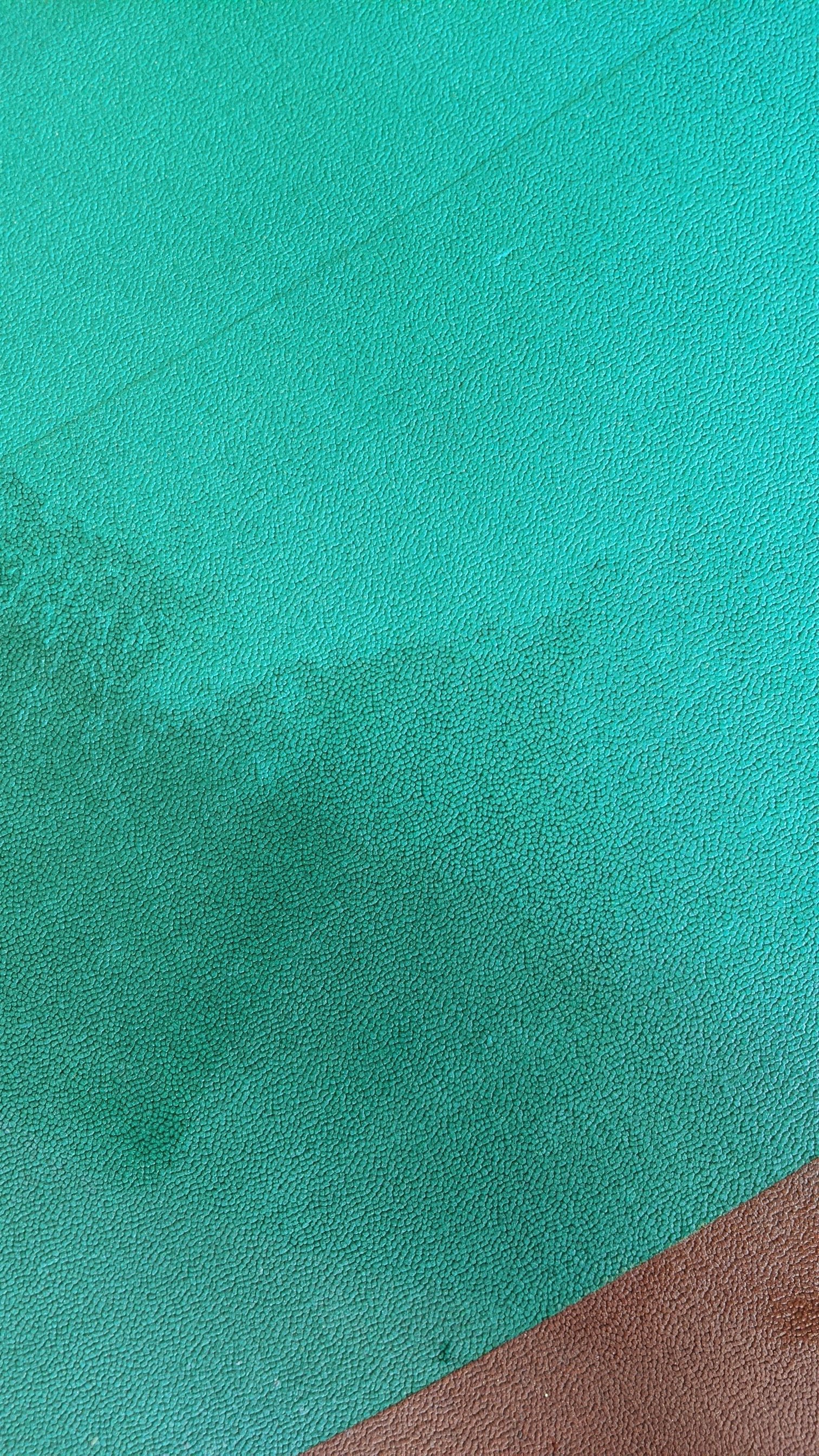

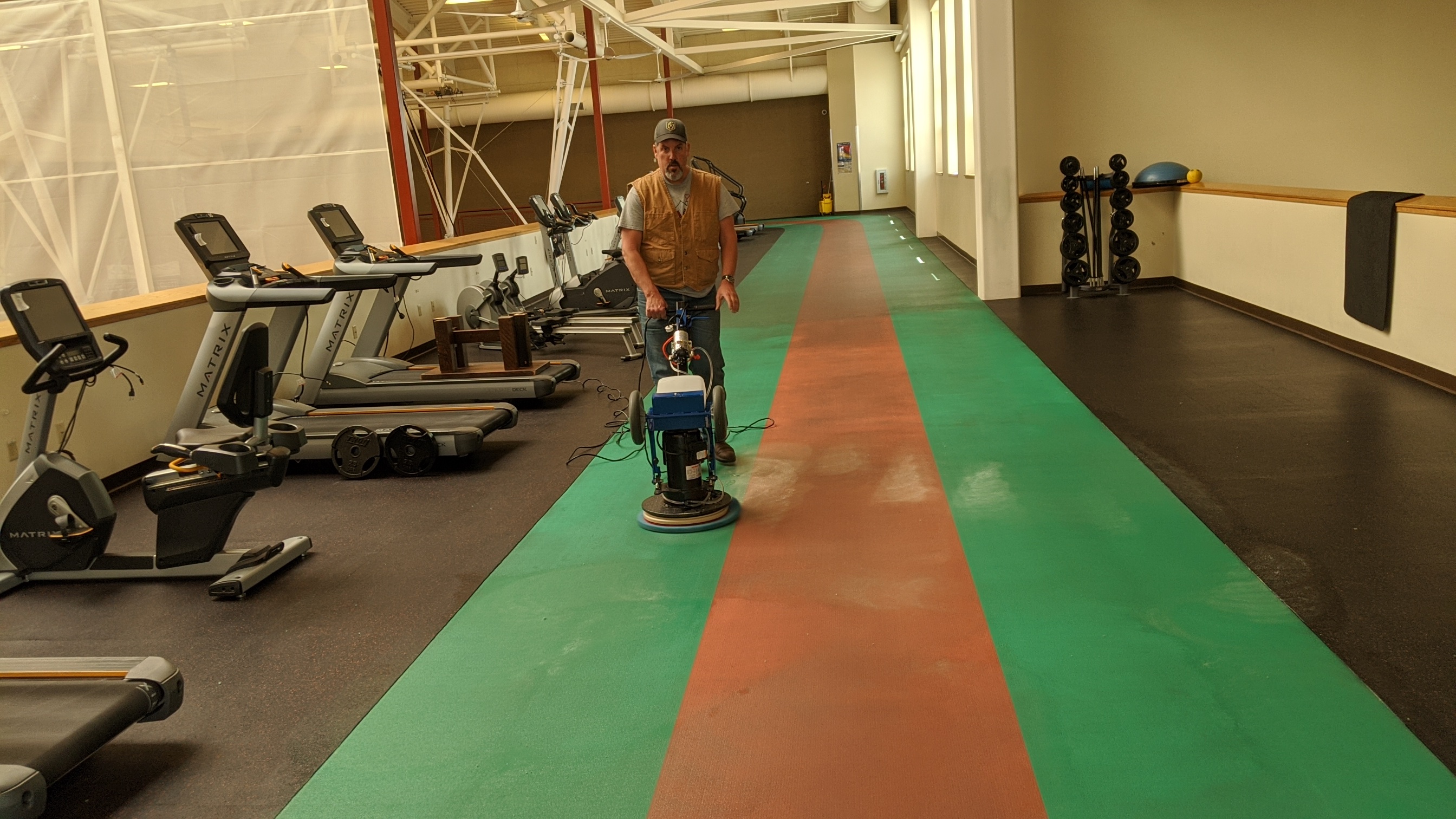

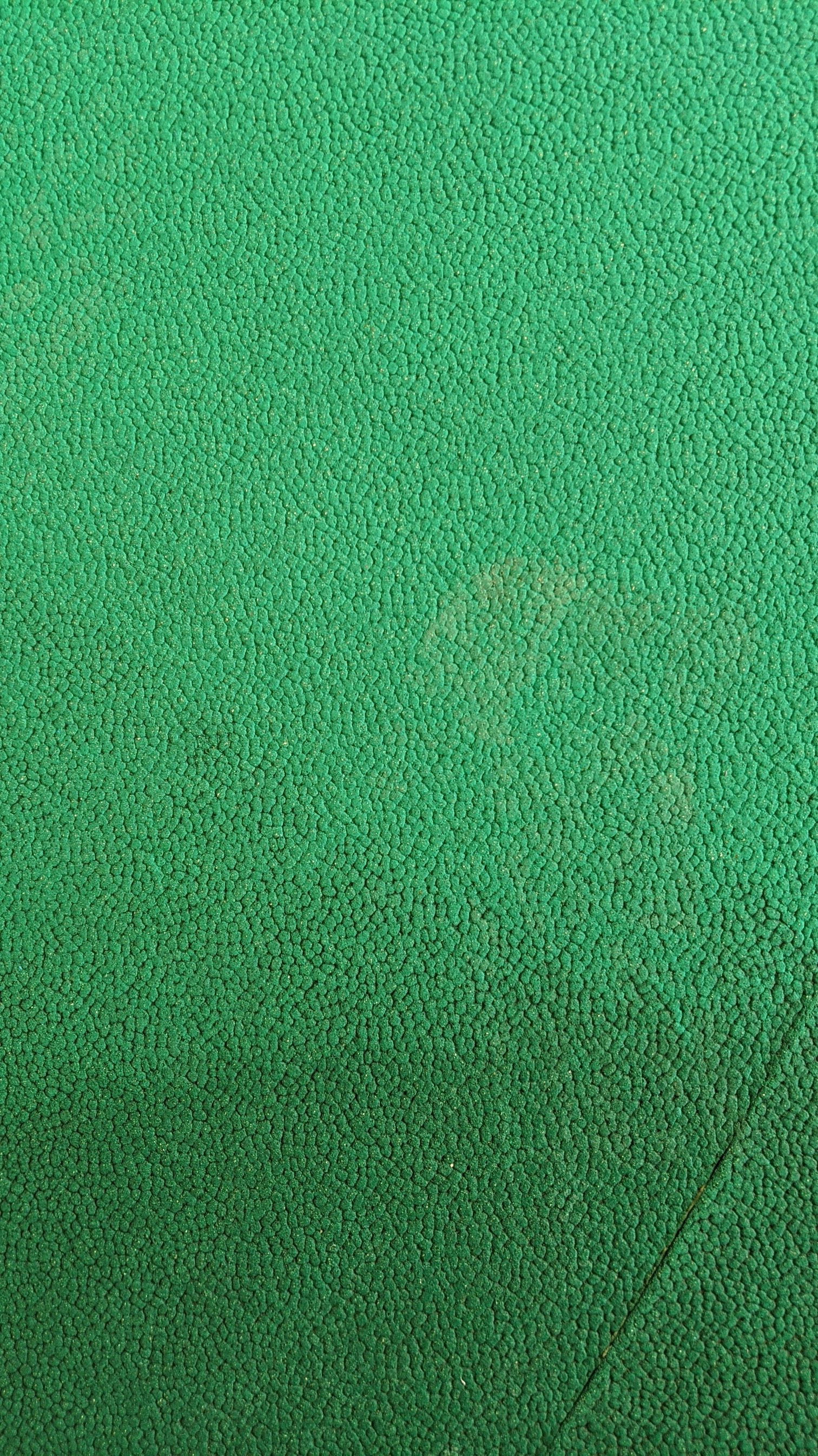

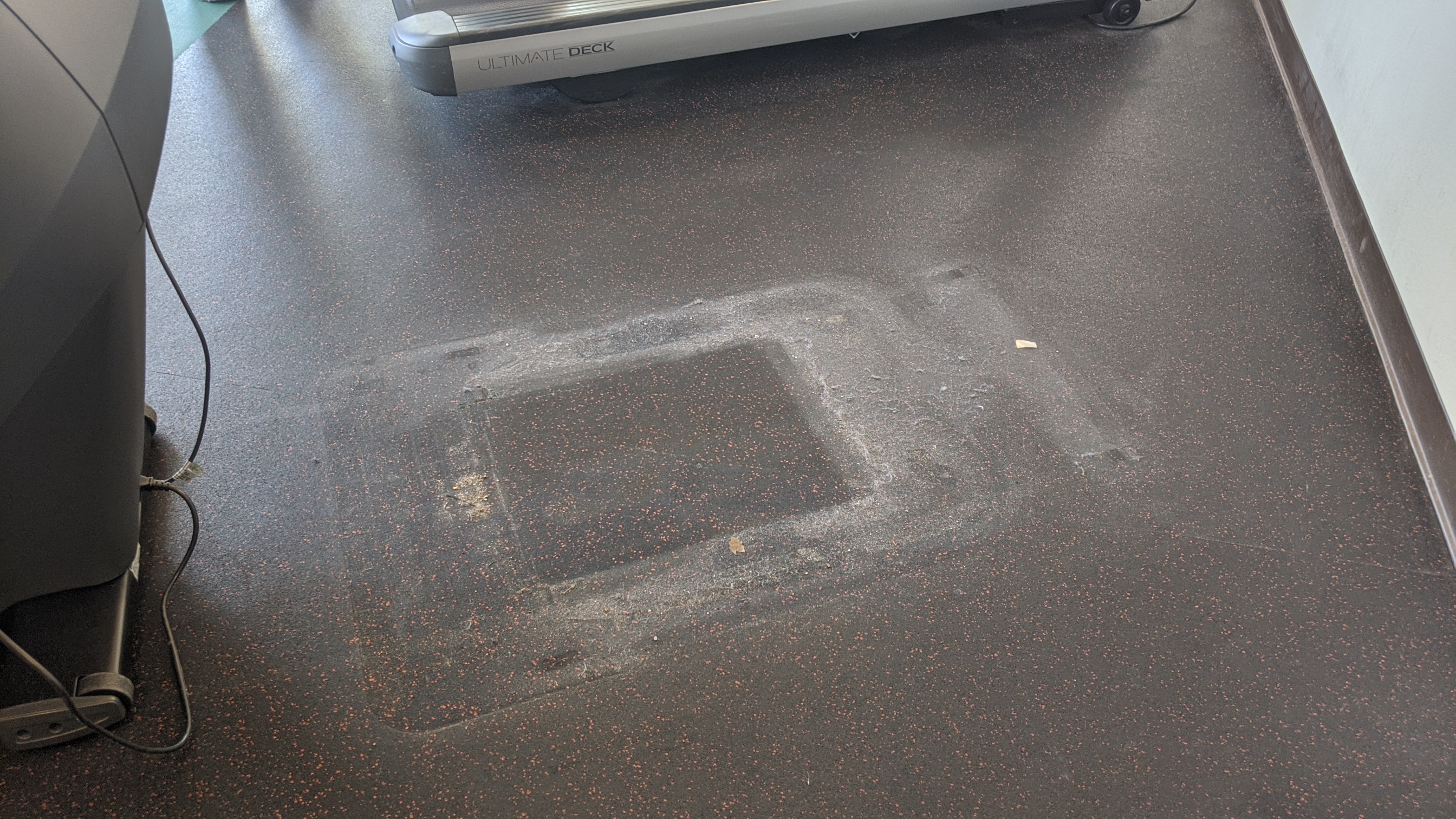

Trial and error has lead to:
green 3M pads
weighted Cimex
high pH encap
glided wand rinse
Waste of time:
Tsunami (too aggressive for rubber)
Procyon(the opposite)
Spinner
Tile wands
CRB
IMG_20200330_102553.jpgIMG_20200330_103805.jpgIMG_20200330_125958.jpgIMG_20200330_125235.jpgIMG_20200330_131726.jpgIMG_20200330_133052.jpgIMG_20200330_151825.jpgIMG_20200330_151831.jpgIMG_20200330_162536.jpgIMG_20200330_163619.jpg
