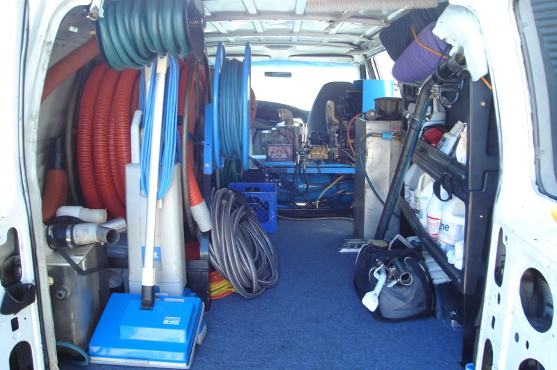

I got only 50' on the reel, but I carry an extra 50' and 100' garden hose. Most of the time I can get it with the 50', but sometimes I need to break out the other 50'. Rarely do I need the extra 100', but I keep it just cuz I never know.
Douglas, I have a regular E250 cargo van. That reel won't fit in it even without the wheels.
This is how I set up my van, but I'm going to redo it and change the vacuum hose reel from 200' to 400' and move it further back making it "powered" of course. I run 4-2-door and would only keep 150' on the current reel and 25' on the side. I'm want to order 100' of 2.5" hose, but might only be able to do 50' because shipping is around $150. I have a lot 2" hose, that's why I'm making due with what I got for now.
I'm looking for a hose reel like Duane Oxley's one in this pic.

thats just a regular hose reel.....only problem you have to take it ALL off...unless you make a quick connector to screw inside

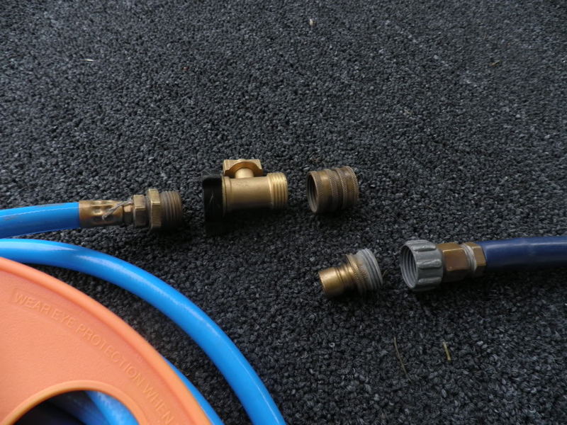

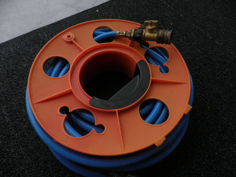

I carry my supply hose on the little $7 electric cord reels, 50' of 3/8" (air hose) per reel. I have three on the truck. At Lowes get the fittings to convert the 1/4" npt to garden hose fittings and add garden hose quick couples and metal ball valve shut-off to each section.
Much easier to setup, transport, and wind up than the fixed van-mounted reels were. Works great for hot or cold water feed.

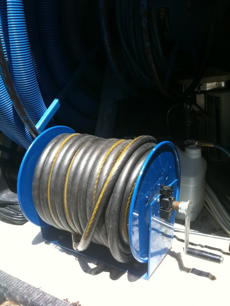

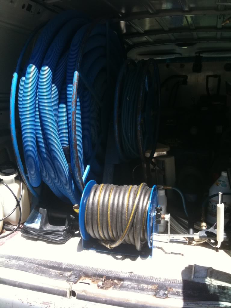

Here is mine, works great so much better than rolling into a coil.
