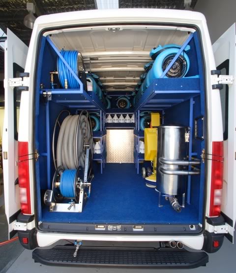

Hi Ofer,
This is a Sprinter (but it is a cab chassis) - viewtopic.php?f=1&t=34531&p=379727&hilit=genesis#p379727
And Phil's Fiat isn't so small, it is just a large as a spinter. Here is the link for more pics of it - viewtopic.php?f=2&t=20507&p=223878&hilit=genesis#p223878

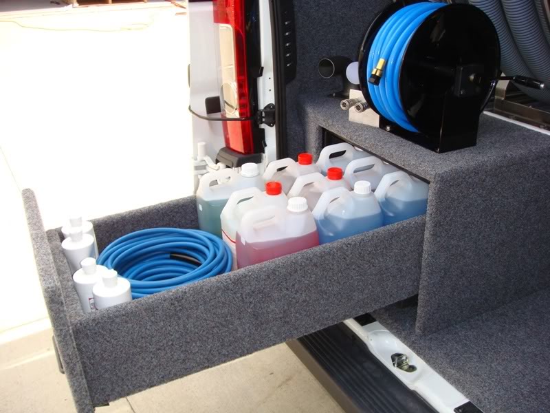

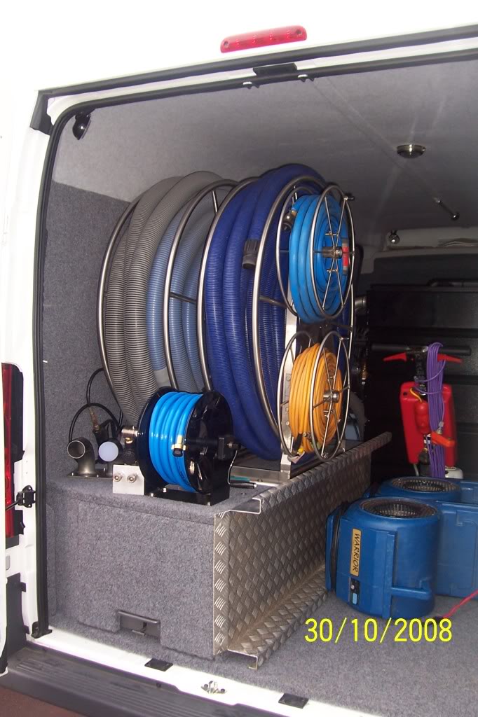

Here is a Iveco Daily van (same size as a spinter)

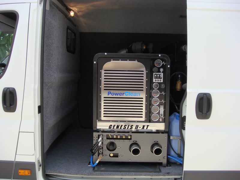

And this is one option for the inside of a van of this size is to install the TM up the front sliding door, and rack out the back to carry whatever you want. This has a water tank and can carry quite a few airmovers
Jim

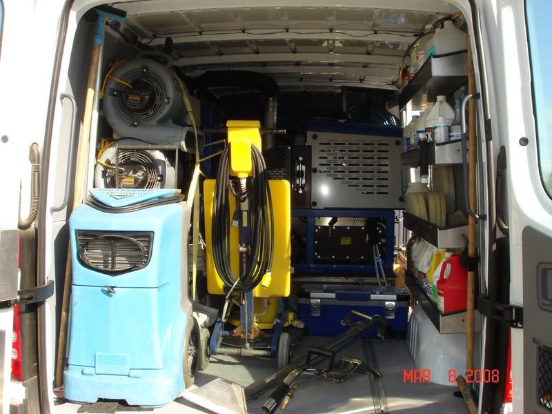

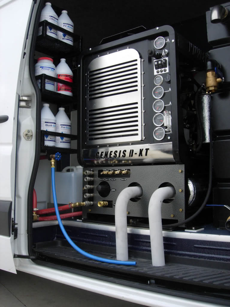

Hello,

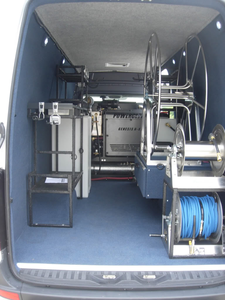

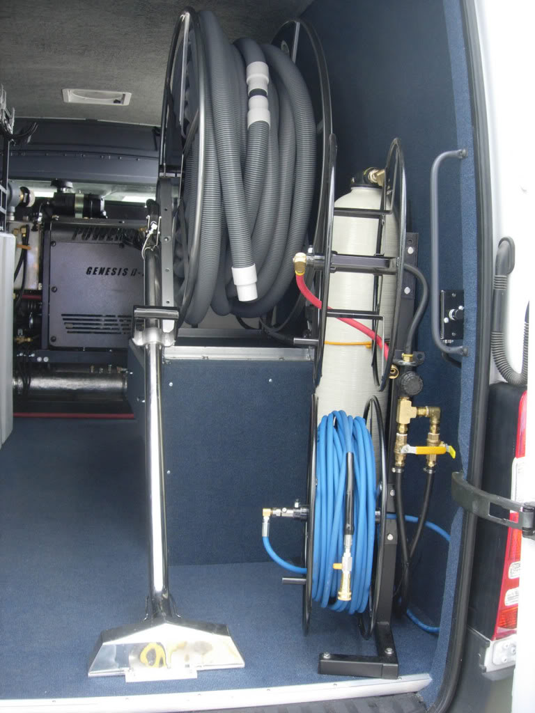

Here are some pics of the fit-outs we have done here @ PowerClean. Hopefully you can get some ideas from them.

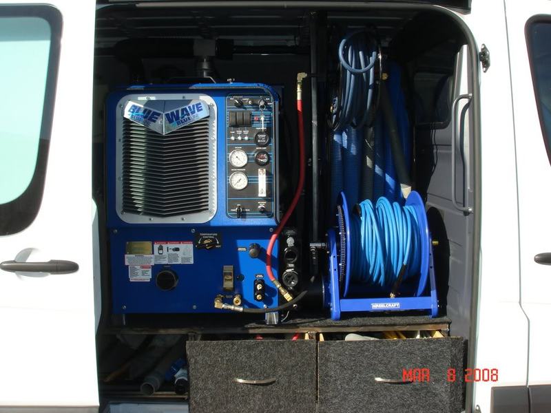

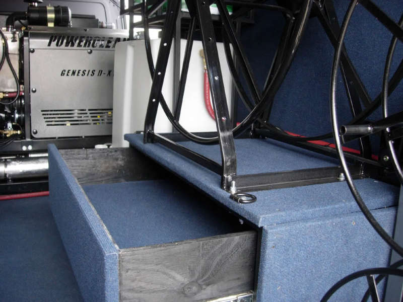

couple things i like about my set up is the extra storage under my tm ( sprinters are so tall u lose much use of the height advantage were the tm sits )
second is the AT shelves are adjustable and have 4 shelves.
This van is the shortest of the height and length that they now make.
