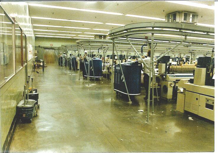

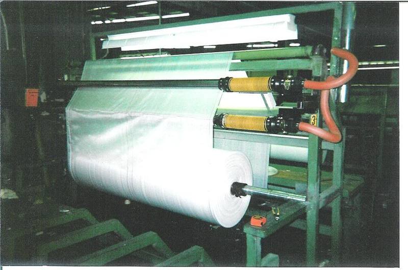

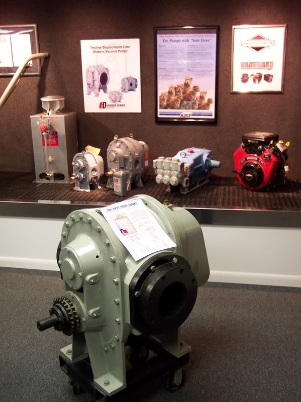

Gene
Do you still have the old blower? These blowers have vents that let the grease vent out if you do over- grease them.
Over- greasing will not make the blower go bad. Judson Vacuum has over 600 of our blowers still in operation in Milliken textile manufacturing factories http://www.millikenmilitary.com/Pages/index.aspx and some of them have over 200,000 hrs on them, and they get over-greased every 15 days.
If you still have the old blower send it to me and if it’s good I will buy it from you.
Thanks
Les
