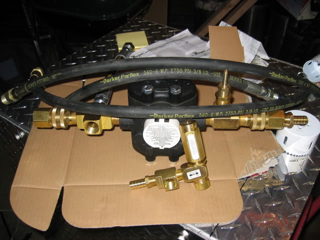

amp draw only 9.6 per leg with all components running get equal power
nothing but the best hose and connects all custom
pump will do 500 psi at 2.2 gallons a minute
no pump teck porti pump
Bjorn
2,450
cfms 230+ lift 11 hg
with booster 330+ cfms
total amp draw is only 9.6 per leg
500 psi @ 2.2 gallons per minute

Is the vac amp draw the same for both motors and your sharing the pump amp to both legs, or is one vac smaller and the pump is run on that leg? Are they 2 or 3 stage motors? What is the approximate weight of the unit?

I have used this machine for over two years with only 15 minutes of down time. Maybe if bleu line could make something this reliable you would still have a job?
most hose runs that anyone cleans are around 100 to 150 feet booster is not needed but comes in handy I have run 300 feet with booster. I use the booster two or thee times a month ( big deal )
Takes no more time to set up than any-other truck mount
here is the big deal is the amp draw of my unit so you don't have the problem of blowing breakers this amp load is full with pump running flat out and is high as it gets.
Is this a SUPER SUCKER with one million cfms no it cleans carpet efficiently and cost effectively with savings in fuel over other gas only powered truck mounts.

what we have done is got over the total amp draw problem that most electric units have
this takes no more time to set up than a gas truck mount

propane use depends on how hot you like it I use a little giant #3 and on a busy week I might use up around 20 dollars worth
not too often I have to run more than 75 feet each of cord use #10 gauge cords roll up just like high pressure line on a reel
