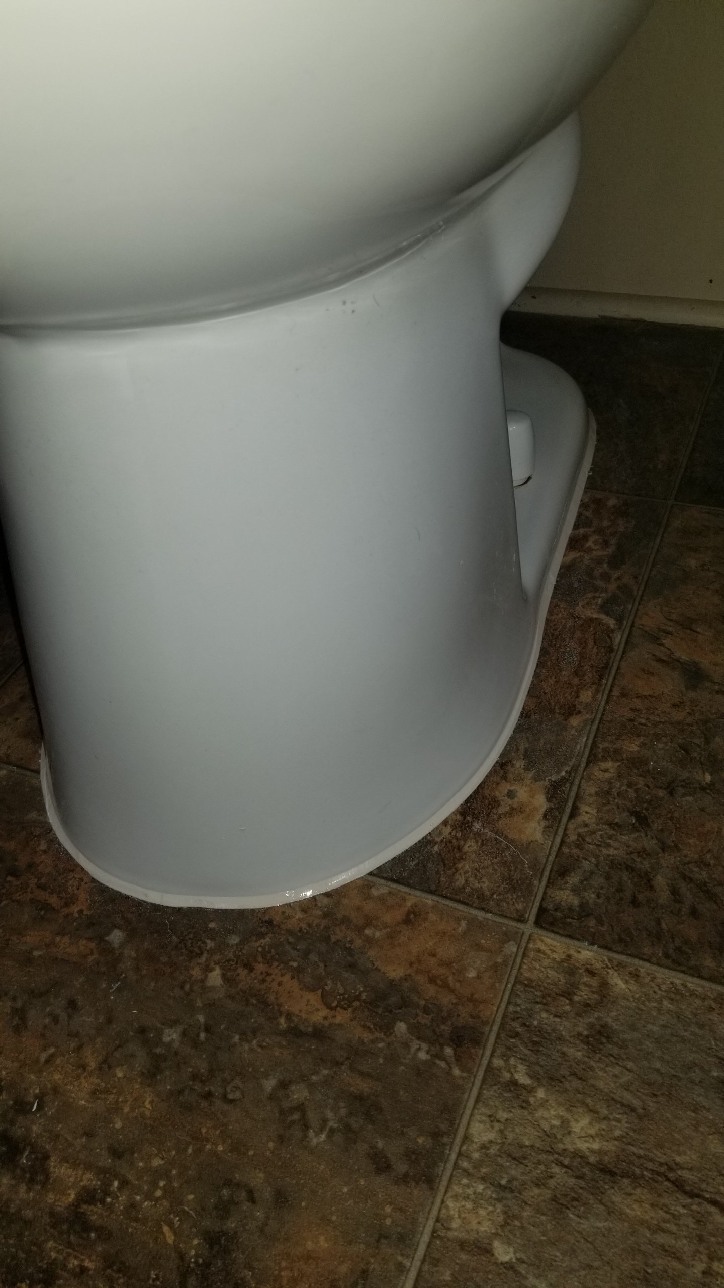

It was my toilet. I was just testing the the profile tool. I do prefer smaller bead.

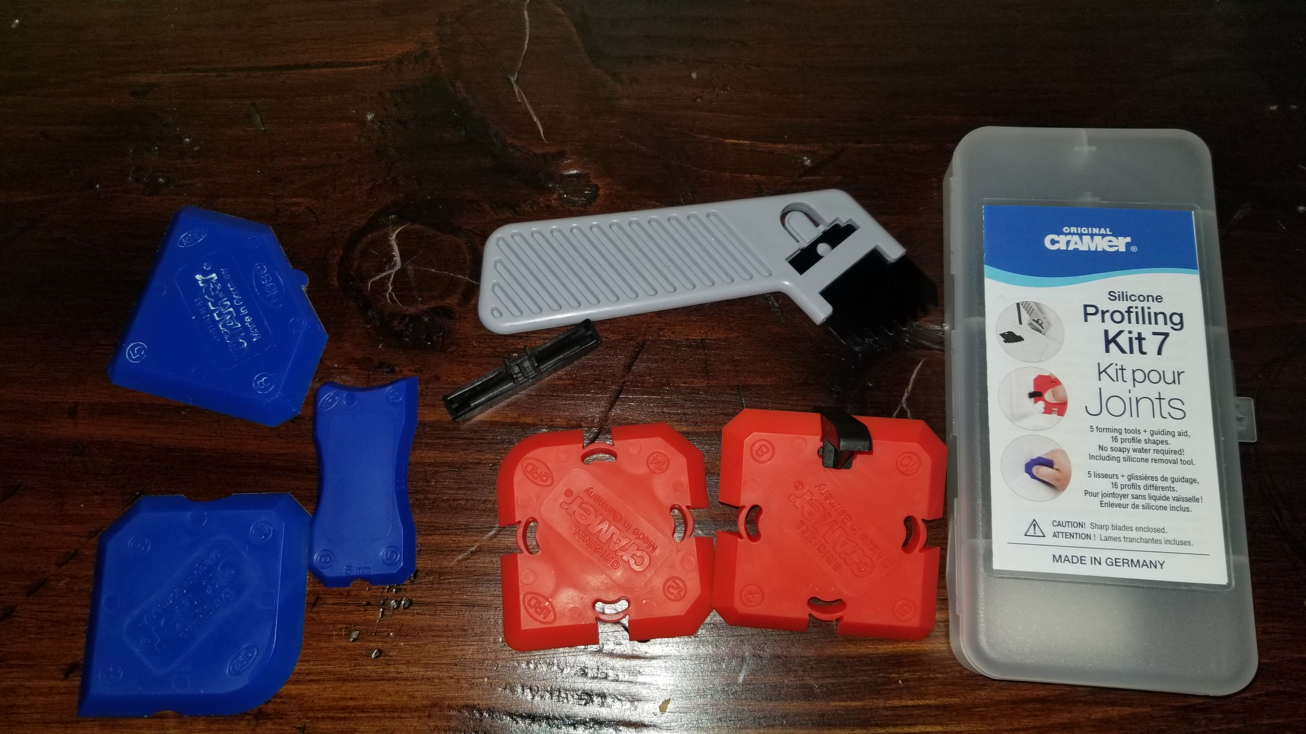

That's what nice about this profile tool. It cleans it up real nice. I agree about bead being too big. It can be pretty unsightly.

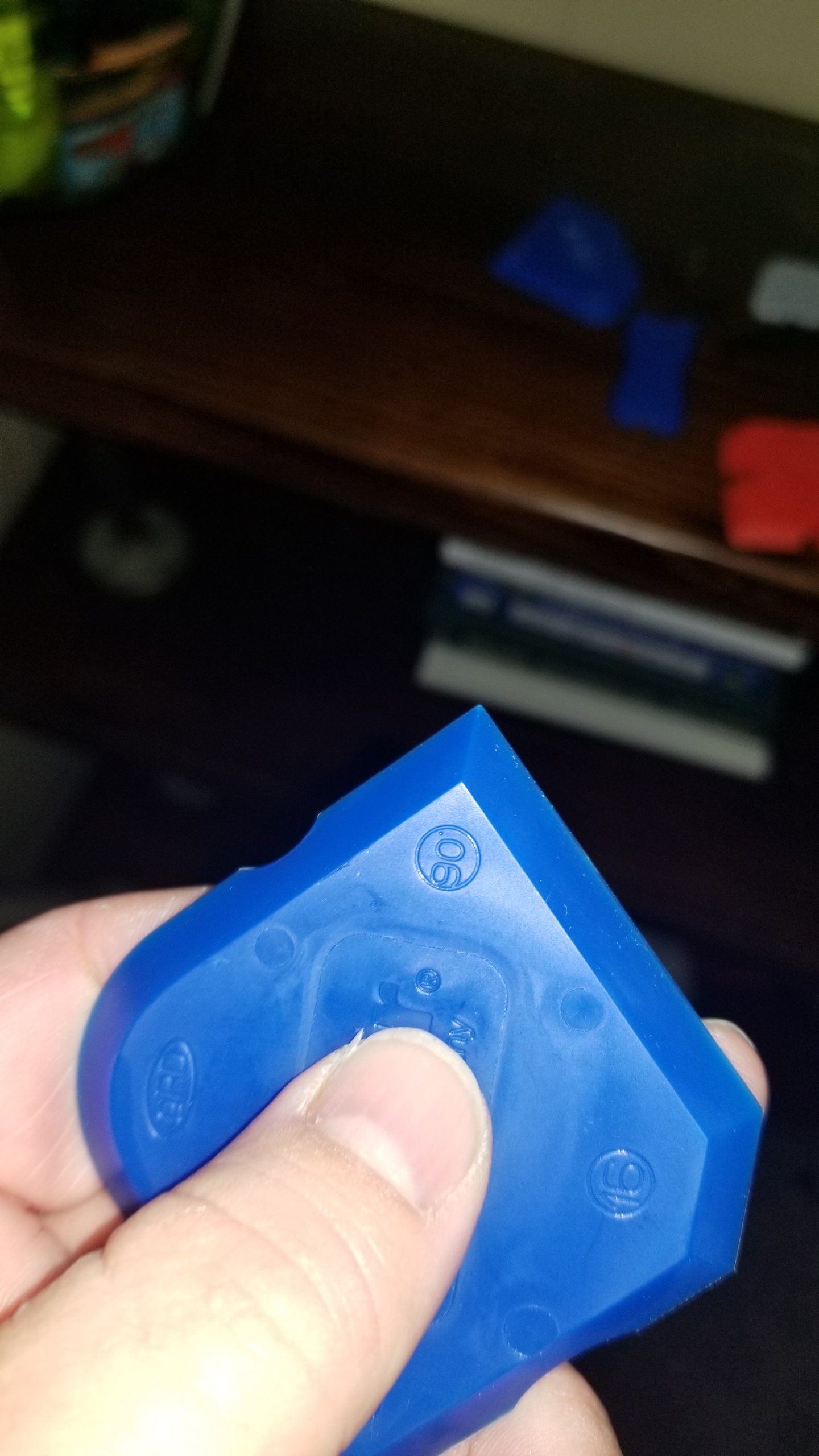

Ill be removing it tomorrow to try the 90 degree profile to keep on the edge and fill gap only.

I had a flash light. Yes, no matter what you use, it always leaves a skin. I still had to clean up with towel. But what was nice about this tool, it left behind very little skin up on wall or floor. So clean up was easier.
