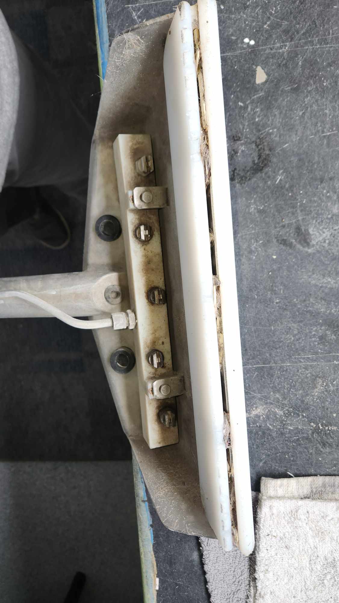

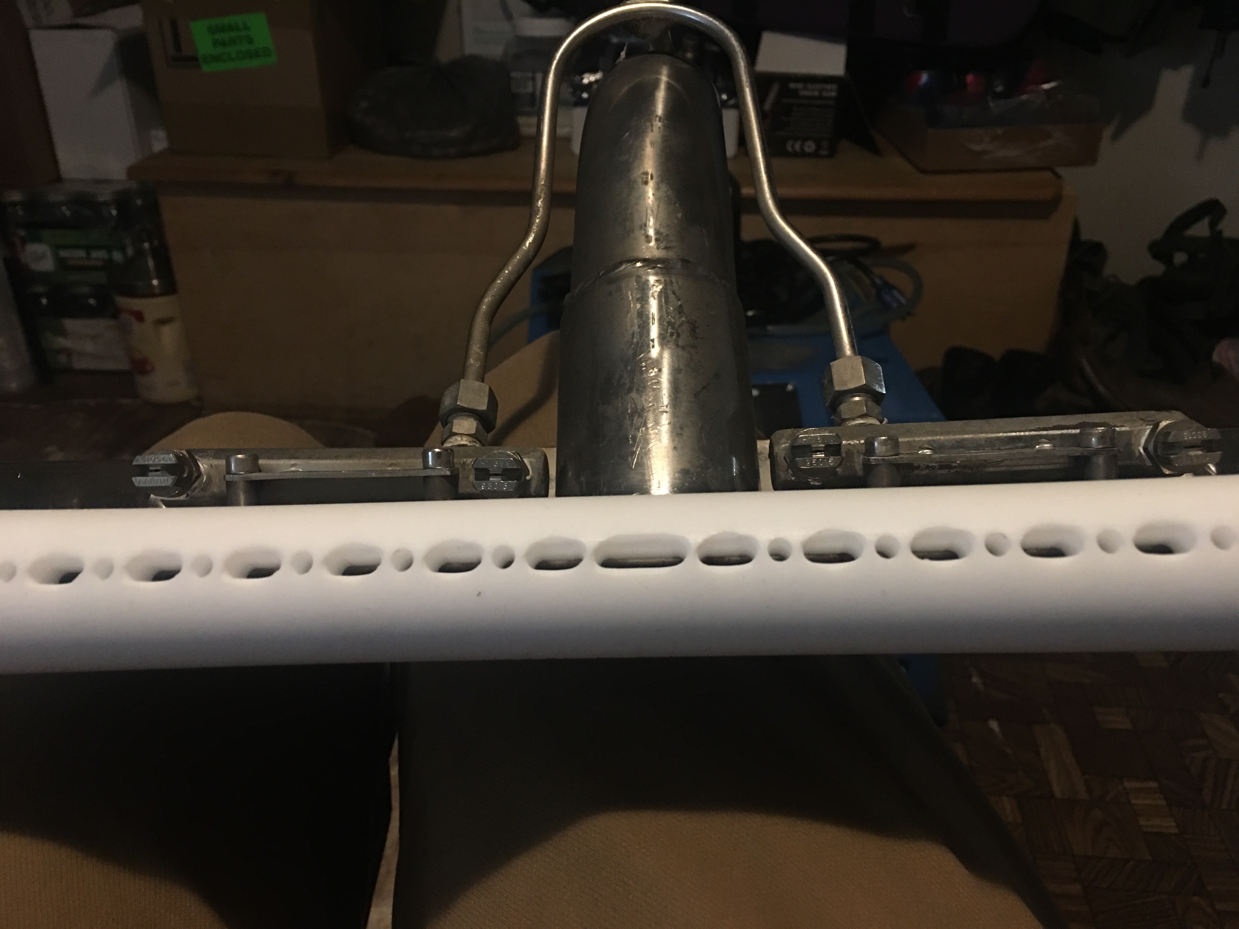

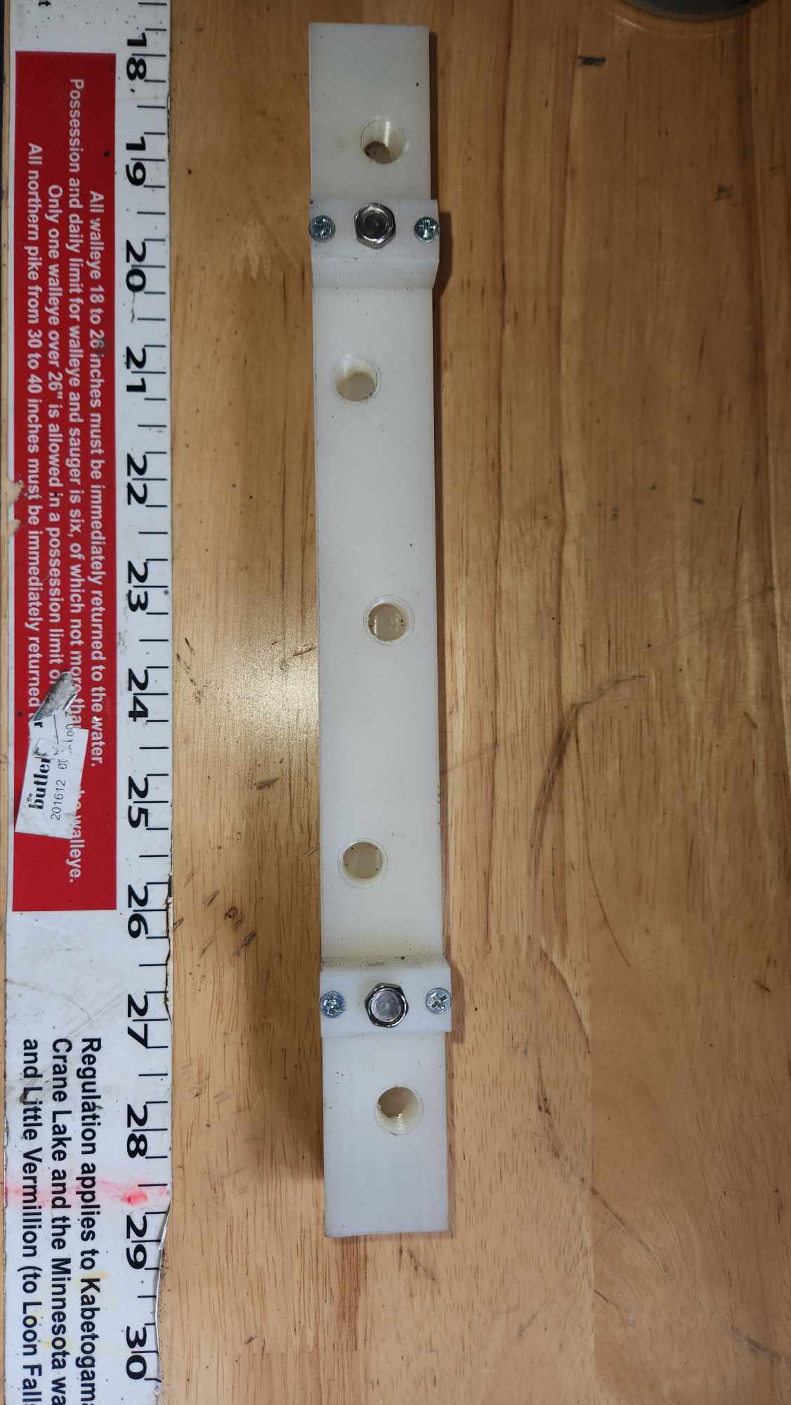

Is westpak the only wand that does this?
14,642
Stagger their jets so we don’t have to angle the spray.
Looks like the “other” wand companies are kinda lazy because my PR TI and other pmf wands never had this
12,853
I believe at one time the original Prochem company did that, though it could have been our original service manager would do it before we installed a machine.

14,642
Butler stagger sthem much more
Why doesn't legend do that? Or do they still use pmf to produce their wands? From your pictures of all the goobers that send you pictures of their jacked up wands, you could easily send the big box company your concerns for the price they want for their wands.

Yes PMF makes them.
They are not open to feed back, and due to costs and function, for every PMF wand I move, I sell 20+ Westpaks
Do me a favor time yourself cleaning 200 ft of open space with that 4 jet and then do 200 ft with the 530 at the same moving pace and let me know what the difference is time
