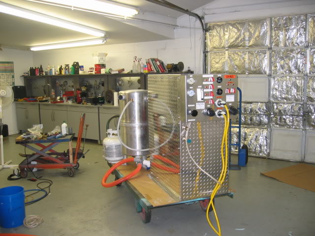

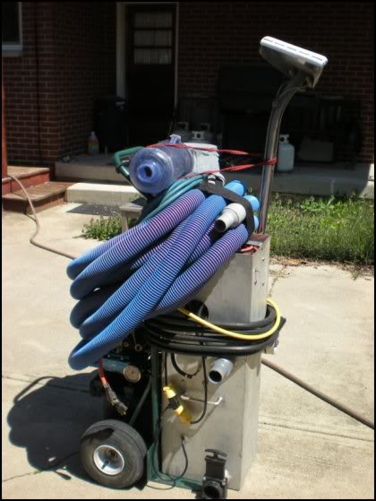

Is this Brevick or Savage portable set up?
116,388
Either one, looks pretty broke dick on the dolly. :shock:

I think thats a savage unit.

The two little pigtails sticking out, is that a two cord Elec. heater? Which brand?
Bob Savage
1,288
Dayton, Ohio
Bob Savage
Yeah, Mikey, that's a SAVAGE unit.
It's crammed onto a dolly for take in work, all in one trip. No, it is not pretty on that dolly, but it is pretty at the carpet or tile, when we are cleaning.
The pretty thing comes when I am absolutely sure the machine is where I want it to be in it's development. Then we'll make it attractive and snap together.
I think it is there now as far as performance, ease of use, and reliability, but you tell me at Mike6fest what you think after YOU clean with it.
Carry on.

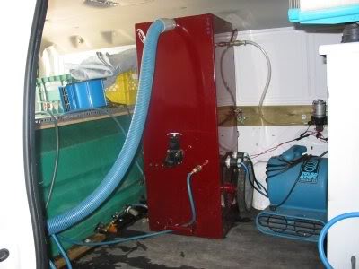

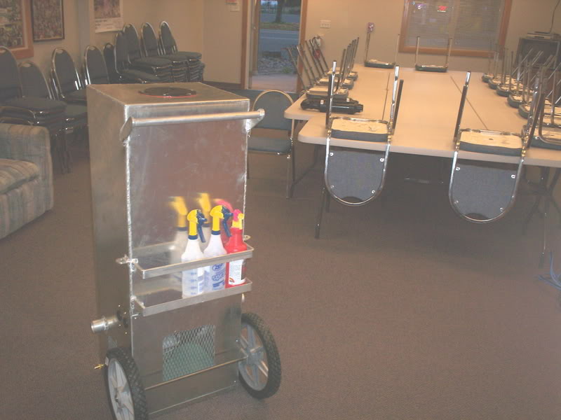

here is my portable Thor
here is another unit owned by Tony Wheelwrite being used from the truck
or how about this for a work station

Can't see in the picture on the savage unit, does the top part come off for access to the recovery tank on the bottom? Auto Filll only?
Bob Savage
1,288
Dayton, Ohio
Bob Savage
Yes, the top lifts off for access to the recovery tank and 30 GPM APO.
No solution tank to mess with. It's auto fill, and will work from a direct faucet hookup, a water tank (self-priming), or a bucket of water. It also has a Dwyer chemical meter for chemical injection.
That dolly contains all the hoses needed for cleaning - fresh water, APO hose, vacuum hose and solution hose, plus electric heater, the vacuum filter, and the wand.
You can also put a stretch mesh cover over it, if it looks too unsightly for you.
The idea is to go inside all in one trip.
This is part of the electric truckmount, so you don't have to have a separate truckmount and portable - one machine does both from the van and inside cleaning.
There is also a 1200 PSI pump option, but I find the 600 PSI is more than enough.

Bob, have you ever played around or looked at those triple stair climbing wheels like they use for wheel chairs. I don't know if they would be better than those large wheels you have. I know in past threads you said your unit goes up stairs fairly easy. How much weight would you save going up stairs if you removed your top piece and took it up by itself.
Bob Savage
1,288
Dayton, Ohio
Bob Savage
Brett,
The vac unit only weighs 42 lbs.
You can pick it up and carry it easily, anywhere, with the bottom in one hand, and the top in the other.
