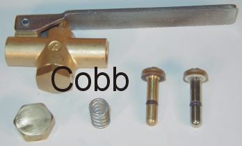

I would love to try a sample of them o-rings.. Does anyone by any chance have orings for k-valves that wont burn up within a week?? tired of having the handle peeing on my leg. after 30 hours of use..
I use about 200-230 at the wand.
Pat;
There are two upgrades available.
1. Viton seal with nickel-plated stem & viton o'ring.
2. Teflon seal with nickel-plated stem & viton o'ring.
Best to use stronger spring for operation.
Larry
