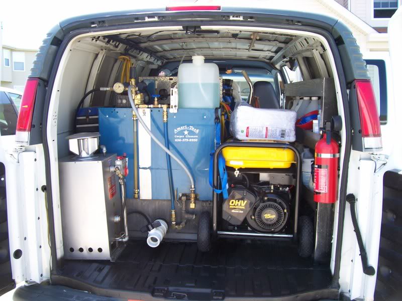

So I'm left with 3 cords, one for the water pump, and 2 for the vac motors. To draw less amperage, I converted the 12 gauge cords to 10 gauge (more cost) and really didn't lower the amperage that much. Breakers still trippin.
In comes the generator, problem here, I couldn't find one big enough to run all 3 cords that I could afford or make cost efficient. So I went with a 5500 watt genny, lasted 18 months. Then to a 13000 watt genny, lasted 2 yrs. Bought the last genny 6 months before I sold the entire unit in Sept. 12.
