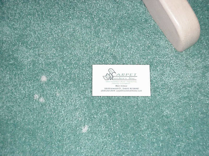

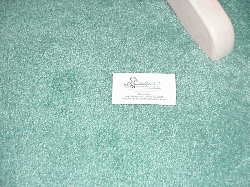

Eric,
This is my first attempt at bleach stain repair and I was lucky to have stains in my own home! LOL! This took 1/2 hour. Not bad and they say green is very difficult. Started with neutralizing the bleach, then added BLUE, then YELLOW. That easy. Good Luck!

Marc, thanks the for pics- looks great-i'm going to check into this.
