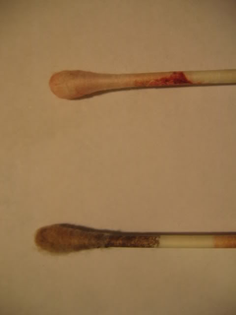

How do you make room for a microfibre sectional that you have no space for? The piece was a dark red sectional with a small 1/8" across black spot on the seat.
I was feeling pretty comfortable...after all microfibre is bullet proof, right? I Tried Dannys water ring idea and then hit the spot with isopropyl on a q-tip. No transfer. Moved on to the vds and it started pulling tar looking (dark brown) goop out. Kept dabbing and applying vds and the color transfering started to turn red, unfortunately the color of the fabric.
There appears to be some color loss where I was blotting about 1/2" across. Had the camera but I didn't have the balls to take any pictures. I had damp wiped some other organic spots with a terry towel and spotter so the overall color of the cushion was splotchy. Told the customer to give me a call in the morning when it dried up.
I'm a little nervous.

Are you sure it wasn't that nylon stuff? A lot of stores call it a butterfly microfiber.
They had nylon stuff like microfiber a long time before they came out with microfiber.
B&BGaryC
Apr 6, 2007
4,667
B&BGaryC
I didn't think color could be taken out of Poly.... I thought it was all solution dyed as a liquid...
