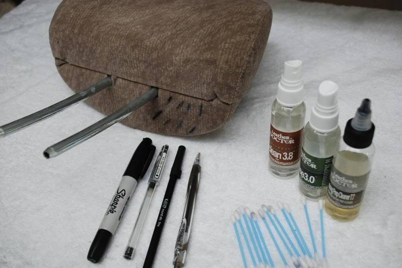

Try a gel hand sanitizer - the alcohol loosens the ink, and works well for a poultice.
AND IT REALLY WORKS
Numero Uno
Oct 16, 2006
1,906
Ma
Caesar
AS Will said above for many years ,I used purell or any gel sanitizer...
Coupled with polymer vomit removing powder it makes the biggest spots vanish.
The polymer adsorbent crystals sit on the ink you simply slowly apply purrell they swell with ink and u vacuum up,leavingthe last bit for simple purell and extraction.
Good luck used just last month on my wool army outdoor shirt ,that a bic broke on,simple easy effective...
Try it for yourself apply any of the inks in above picture to your hand let sit for a few hours apply purell say sayonara...
For cloth a dab of dish detergent to apply principals suggested by Roger,lift /lubricate/suspend /remove /etc,etc
