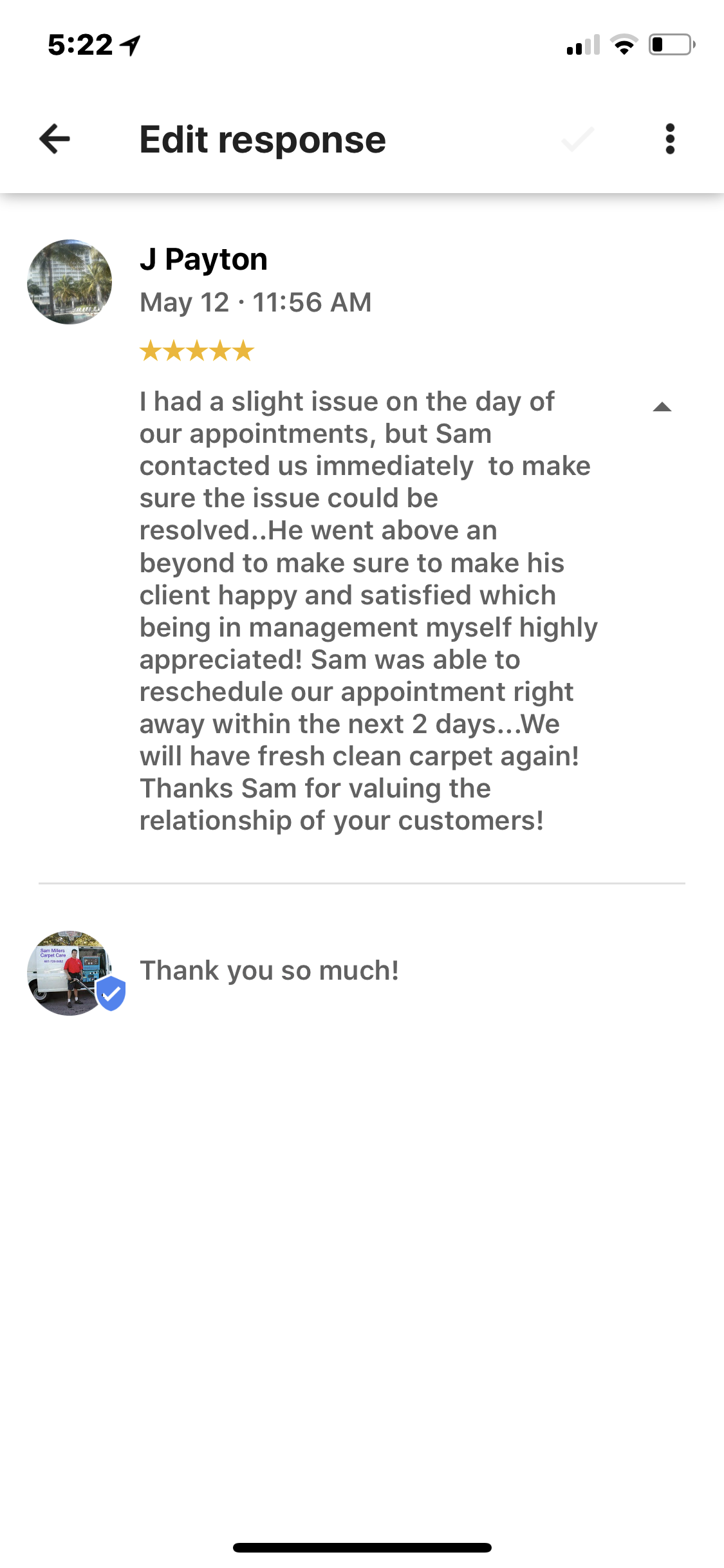

Ps she already changed her 1 star back to a 5 star and re wrote her review!

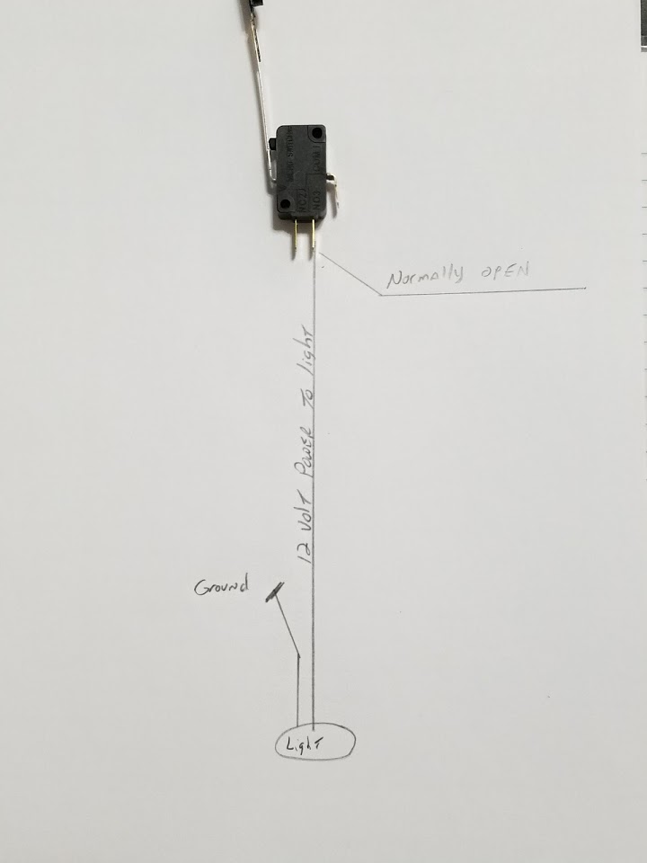

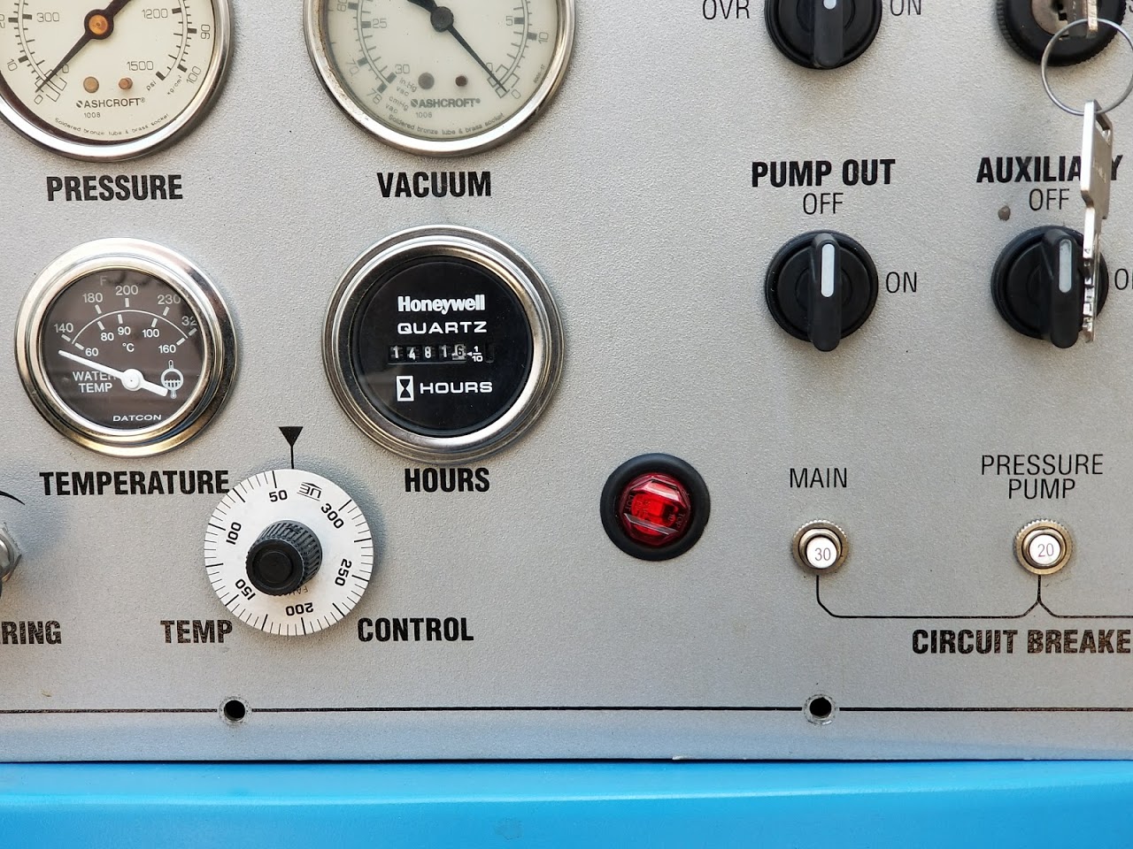

I added a light to mine...so if the tank gets full it will come on....with Jr out there using it ...it has saved me a few times....
here is how to wire one up....
Reactions: SamIam and Nomad74

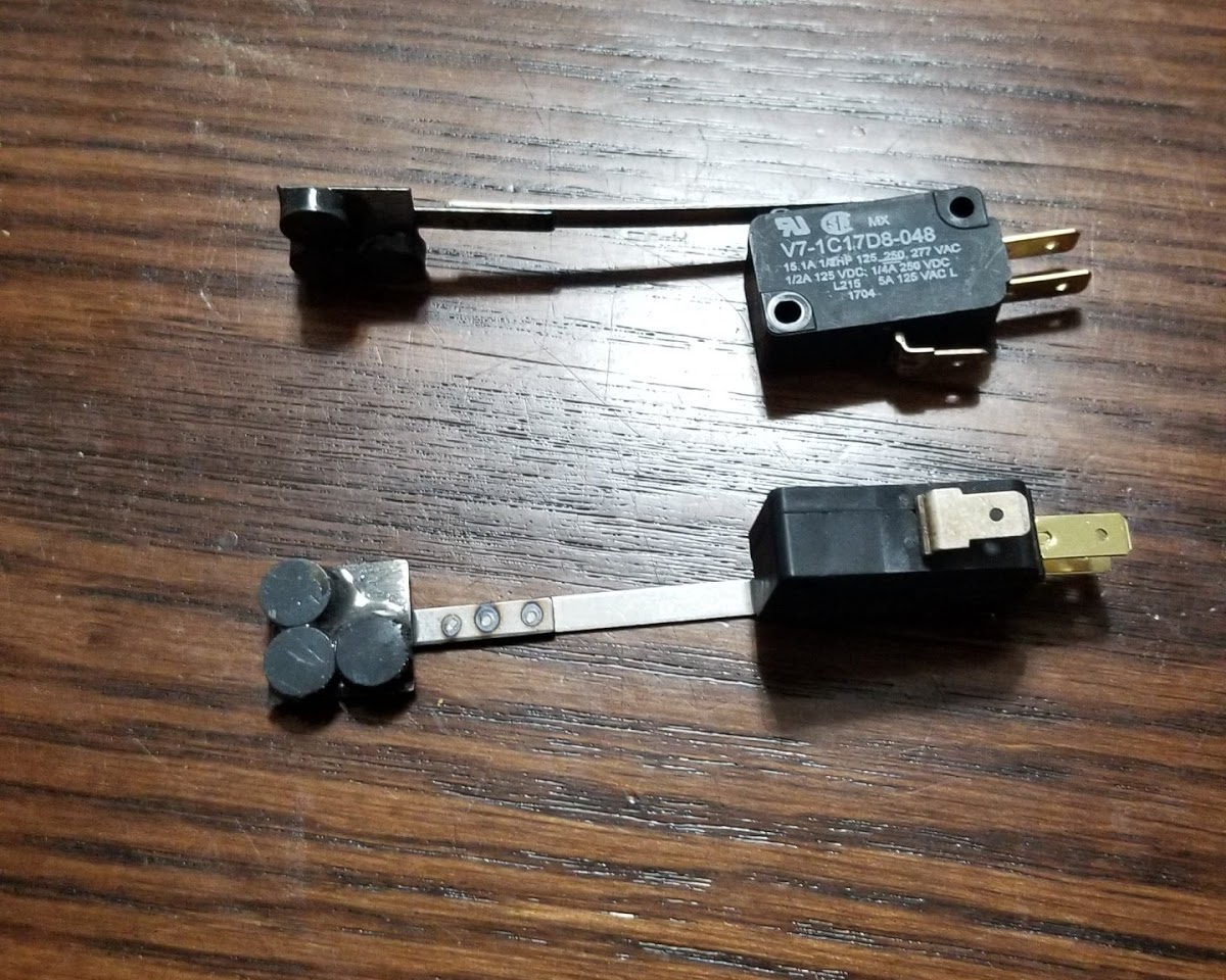

My Harwig float on my APO went out AGAIN!!!! The relay works fine when I pinch it but when i move the float up and down nothing happens. Its like the magnets just decided to stop working.
Jim Martin
Arizona
Jim Martin
if you can push the microswitch by hand and it is working....then I would check and see if either you have something stuck in the pivot of the float and it is not coming up as high as it needs to....or..the float itself is filling with water...2 good places to look before replacing the switch.....
Well, no dice :( that dang float just gave up. Guess I'm ordering a new one.
