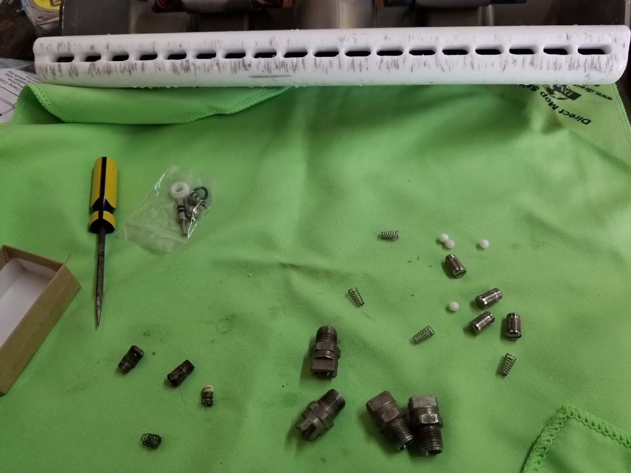

I’m tired of those stupid jet filters failing
14,104
i took out the wand jet filters, upped the flows from 1.5 to 2flow jets (making my wand 10flow), and installed an in-line filter after my soft touch valve, as well as before like always
Since I’m now using 10fliw on my wand, should I increase or decrease my water pressure?

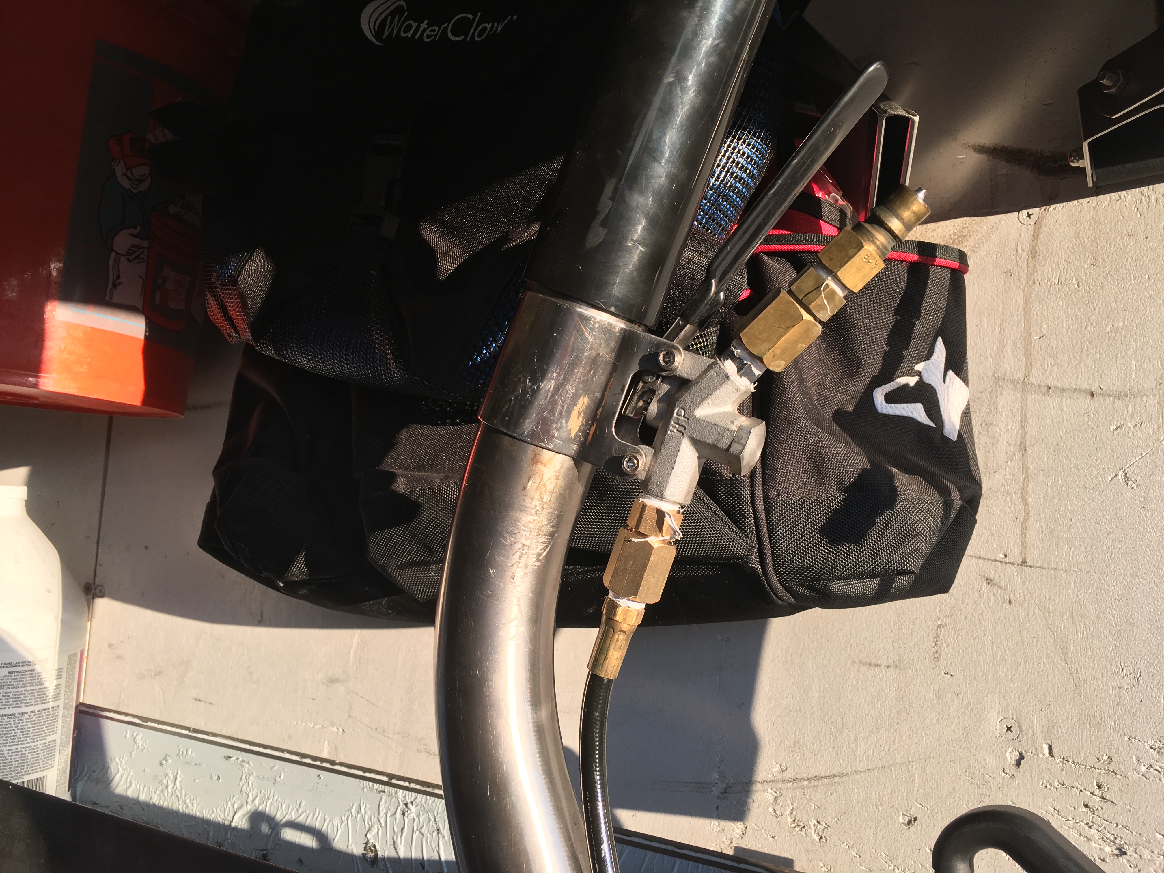

I use a 100 mesh filter before the valve on all my tools. Prevents debris getting into the Jets and easy to clean. Who the hell wants to clean 4 filters on a 4 jet wand when you could clean just one?

Do you have a picture? Sounds like a great idea!

I know, I know. The wand is looking rough.
But I was assuming that since the jet filters aren't doing their job at catching all the debris, then maybe another inline filter will catch the junk. That's another reason why I bumped up the flow on my jets also, so the hole will be bigger.
And from the ridiculous price that those stupid little filters cost, they're a ripoff.
14,104
I always had the filter that is attached to the male QC. That's why Im thinking that it might be coming from the orings in the wand valve.

Yes I do have a filter.
