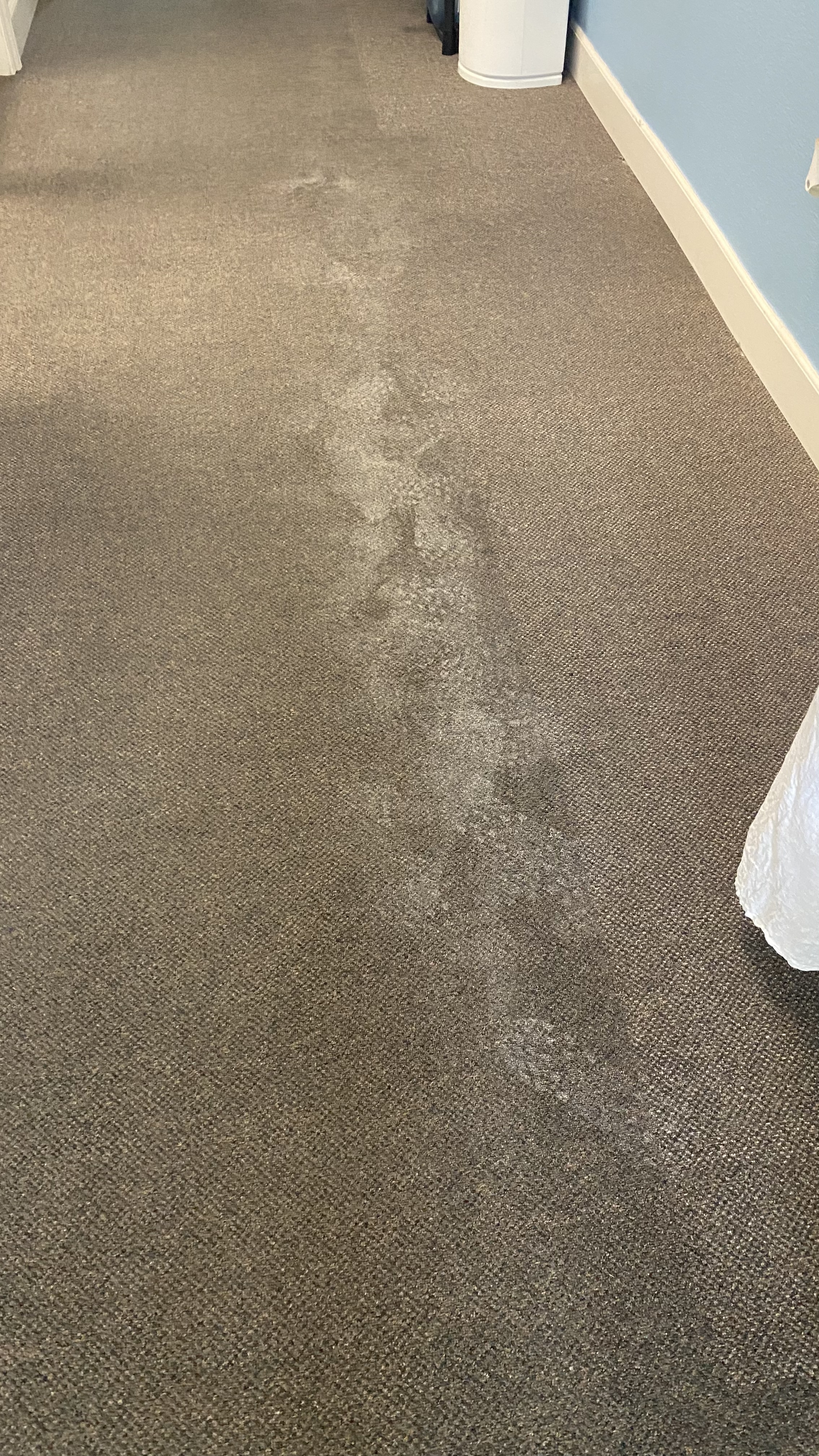

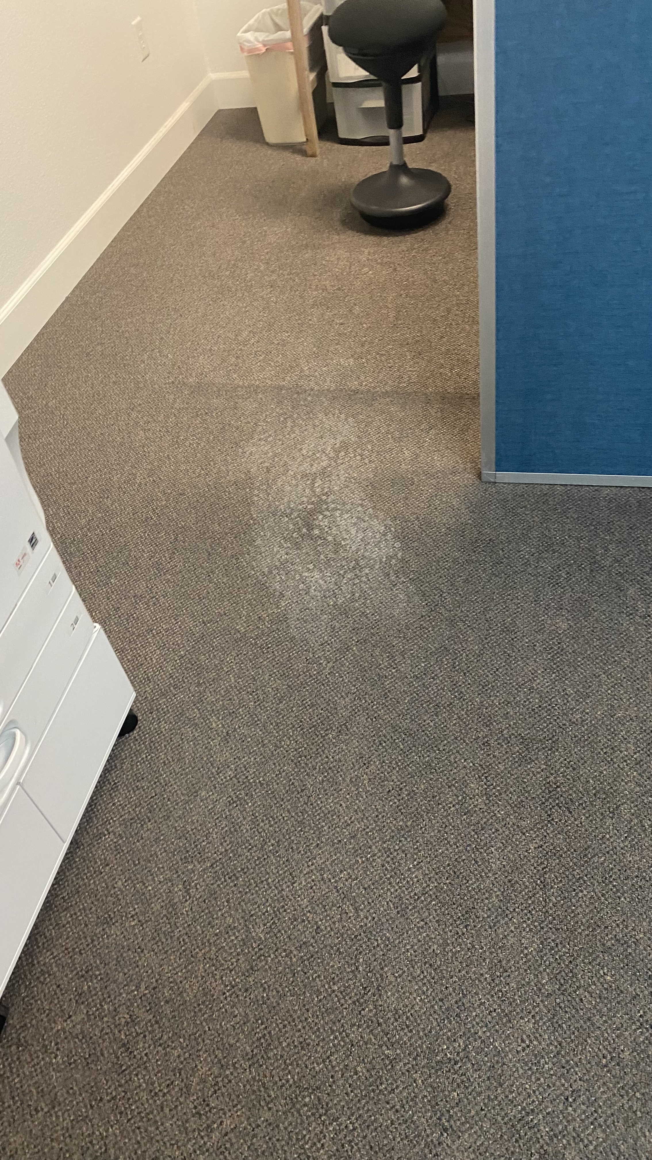

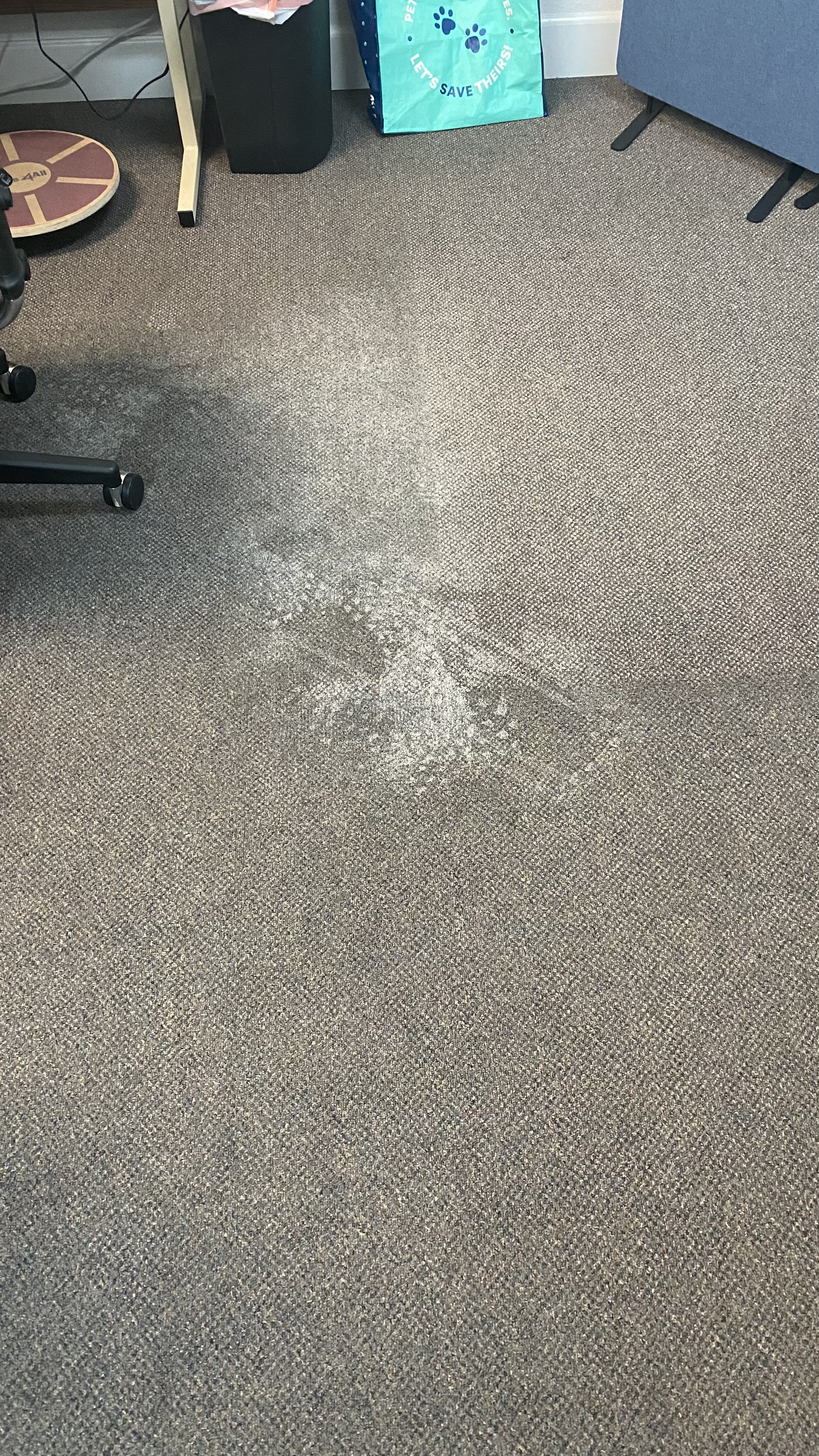

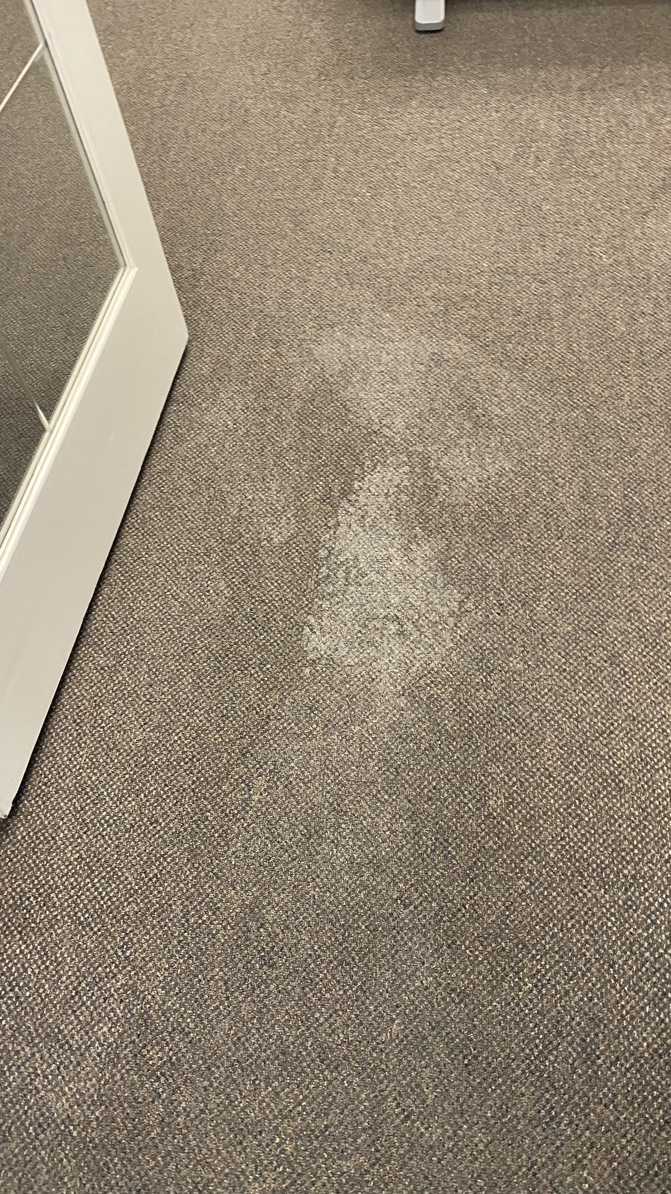

You waxed the floor
NoYou waxed the floor![]()
Wow, 4 times per year. I wouldn't mess with that cash cow!!!! (except for raising the price occasionaly.)No, I clean that office quarterly. The carpet needs replacing from all the wear. the landlord refuses.
Hmm interesting. Well who knows. I did go pretty heavy in those areas due to the wear. But I’ve gone just as heavy with my other encaps and never had an issue.That is really weird. I've used Green Dragon as a straight encap on CGD a lot of times and never had that issue. It was my go to for everything, VLM, HWE, and grout. Doesn't leave a white film on tiles at all which is nice.
It's been a long time but I've had this happen with releasit. My feeling were there was something there that didn't rinse completely out and the encap did what it was suppose to. It turned whatever it was into powder.Hmm interesting. Well who knows. I did go pretty heavy in those areas due to the wear. But I’ve gone just as heavy with my other encaps and never had an issue.
